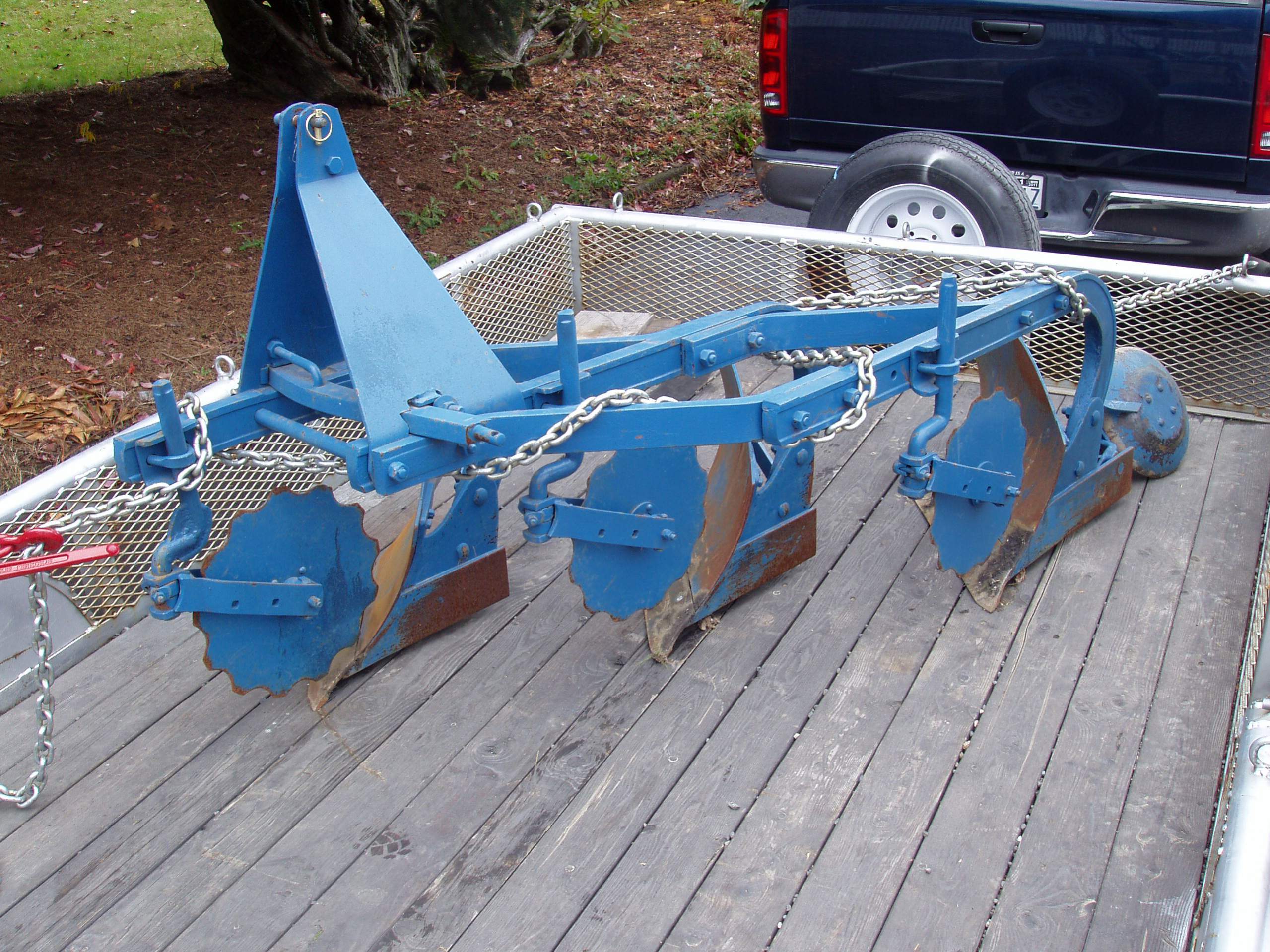

Oh yeah... fordoutback... I'd love to have your 'tater digger..!!
   / What size plow #27
I was really lucky the day I found this. It was headed to the scrapyard at one point before the person I got it from decided to use it for a lawn ornament. It was all bent up from being wadded up with a skid-steer and it took me about 10 hours with torches, big pipe wrenches and a sledge hammer to straighten it out and get everything turning the way it should.
