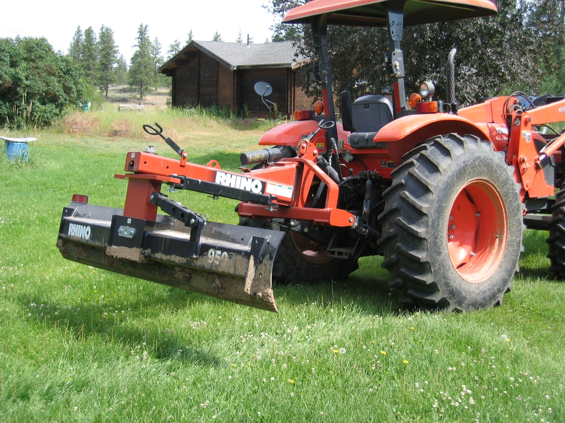

I run a 96" Rhino rear blade on my Kubota. I can offset and angle. Gets the blade 14" outside the rear tire on one side. Very handy where I have 20 foot drop offs on my driveway. Tractor is still on the driving surface - snow is being propelled up and off the edge. Getting ready to hose the mud off the rear blade. Been down clearing ditches on the driveway.

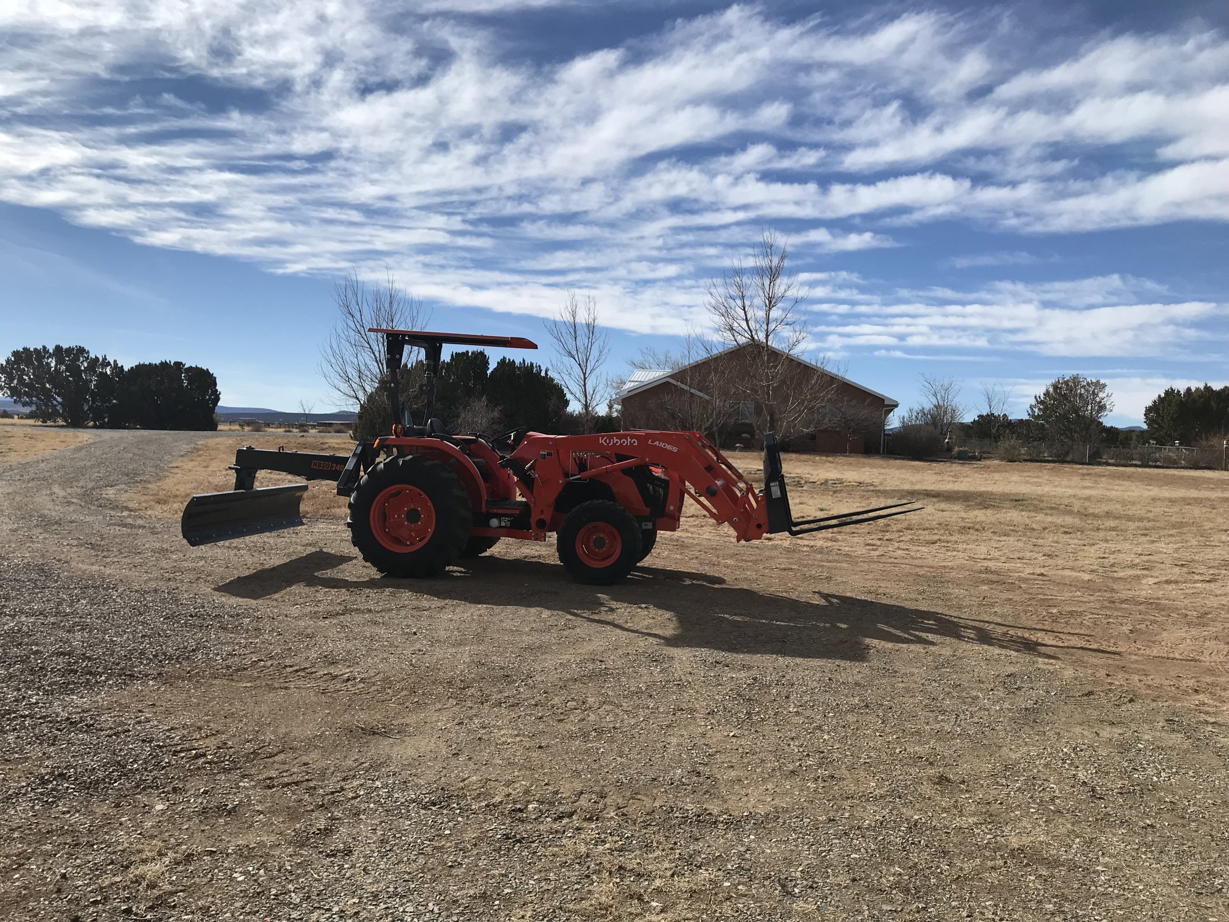

If you get the 7’ blade, be sure that it will offset. This is my 8’ heavy duty Bison blade behind my tractor with 72” wheel width. It also offsets.
