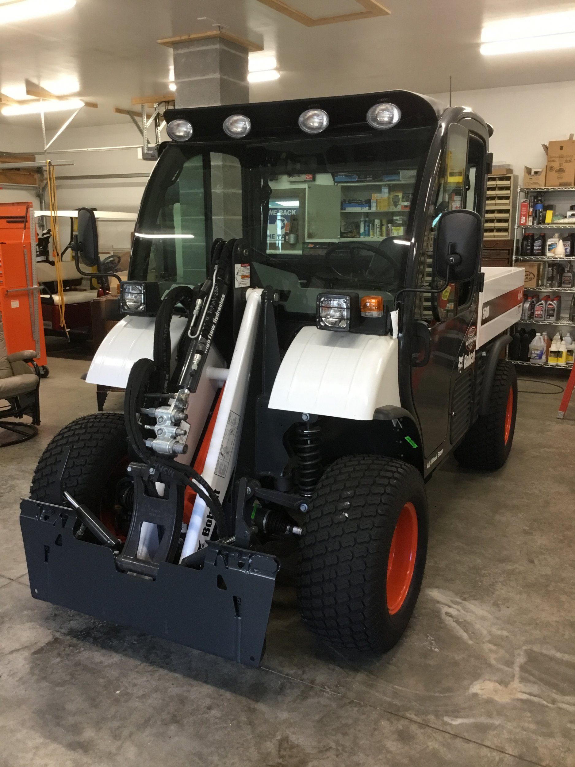

I’m in northern Wisconsin. I have plowed snow for many years, primarily with a 3/4 ton pickup. I only plow for neighbors, relatives, friends and some volunteer jobs for churches etc.
This year I agreed to take on about 15 light commercial accounts. I‘ve always wanted a toolcat and that gave me the justification to buy one. I purchased a 2021 5600 with a 68” rotary broom.
Now I am shopping for a snow bucket and a plow blade. The jobs are general in nature including apartment buildings, businesses with small to mid-sized parking lots, sidewalks and some residential driveways. I have a couple question for those that have toolcat experience with snow removal.
What size snow bucket works best with a toolcat? I’m not terribly loyal to the Bobcat Brand on attachments although their specs recommend 68” to 80” for light material. I have no reason to dismiss their recommendation, I just would prefer to learn from the experience of others.
What push blade would you recommend? I see that several manufacturers are now making a “scoop” style blade for the skid steer platform. Specifically the Western Prodigy, Fisher XRS or Hiniker Skid Steer Scoop. Because most of these seem to be in the 9+ for range, I wonder if a toolcat will handle them. I’m tempted to rule out a “V” style plow. Not because they are not good plows but because I suspect they are too heavy.
I very much appreciate your advice and recommendations.

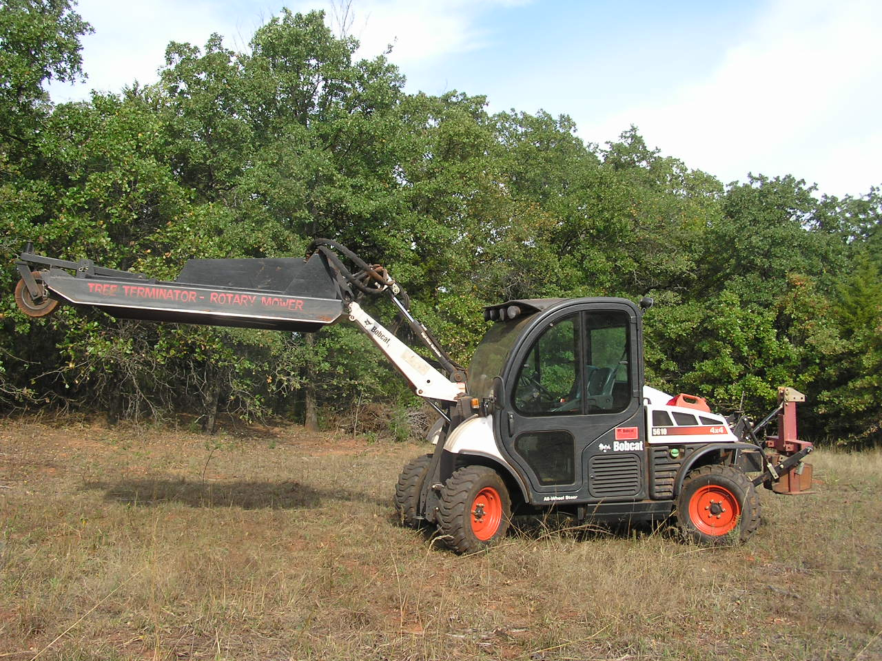

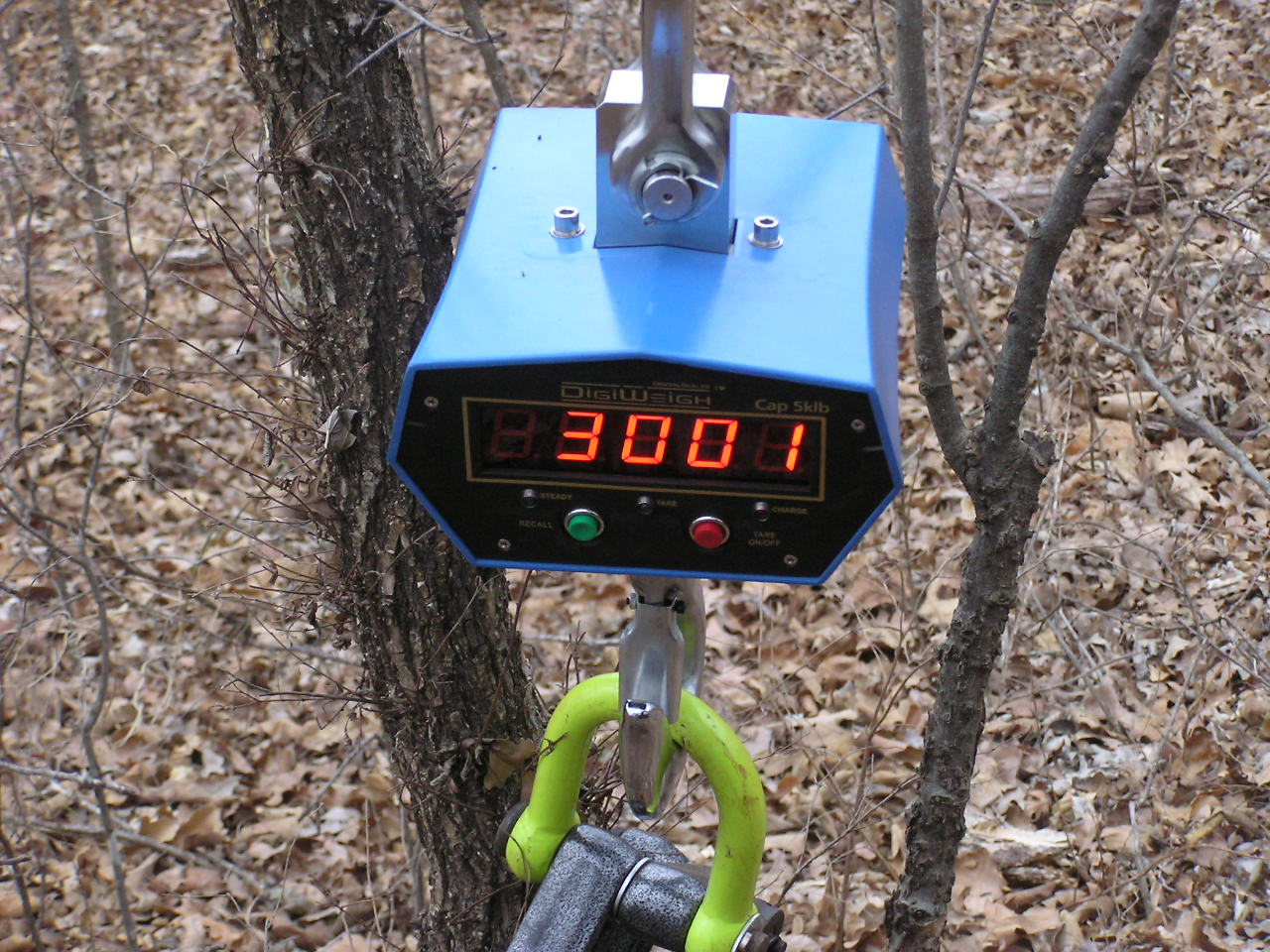

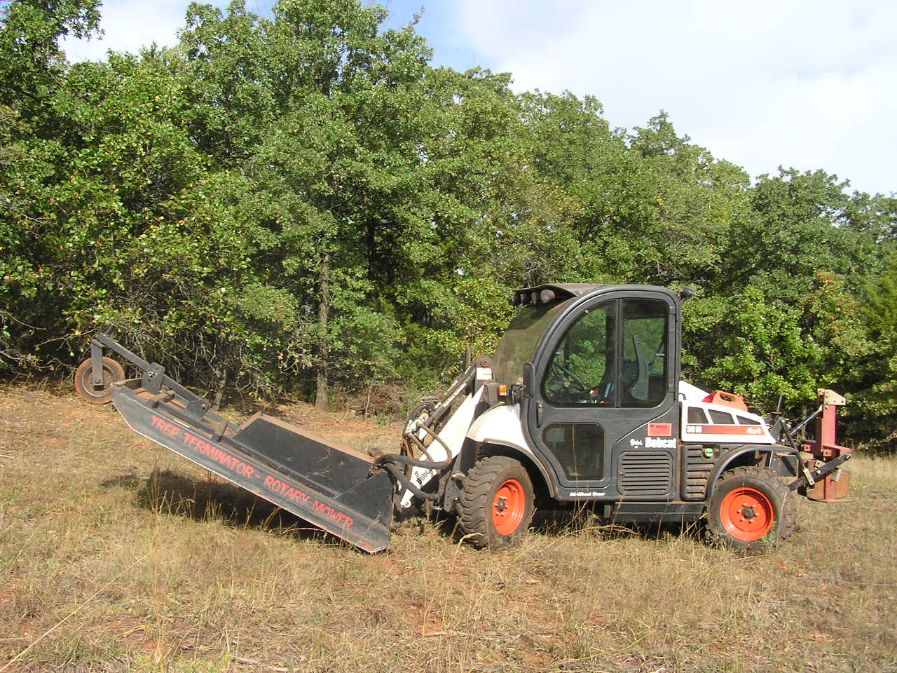

I used a 5K crane scale to see the lift power of the Toolcat:
This 7' brush hog weighs 1800 pounds:
Negative knowledge of snow plows here in Oklahoma. :D

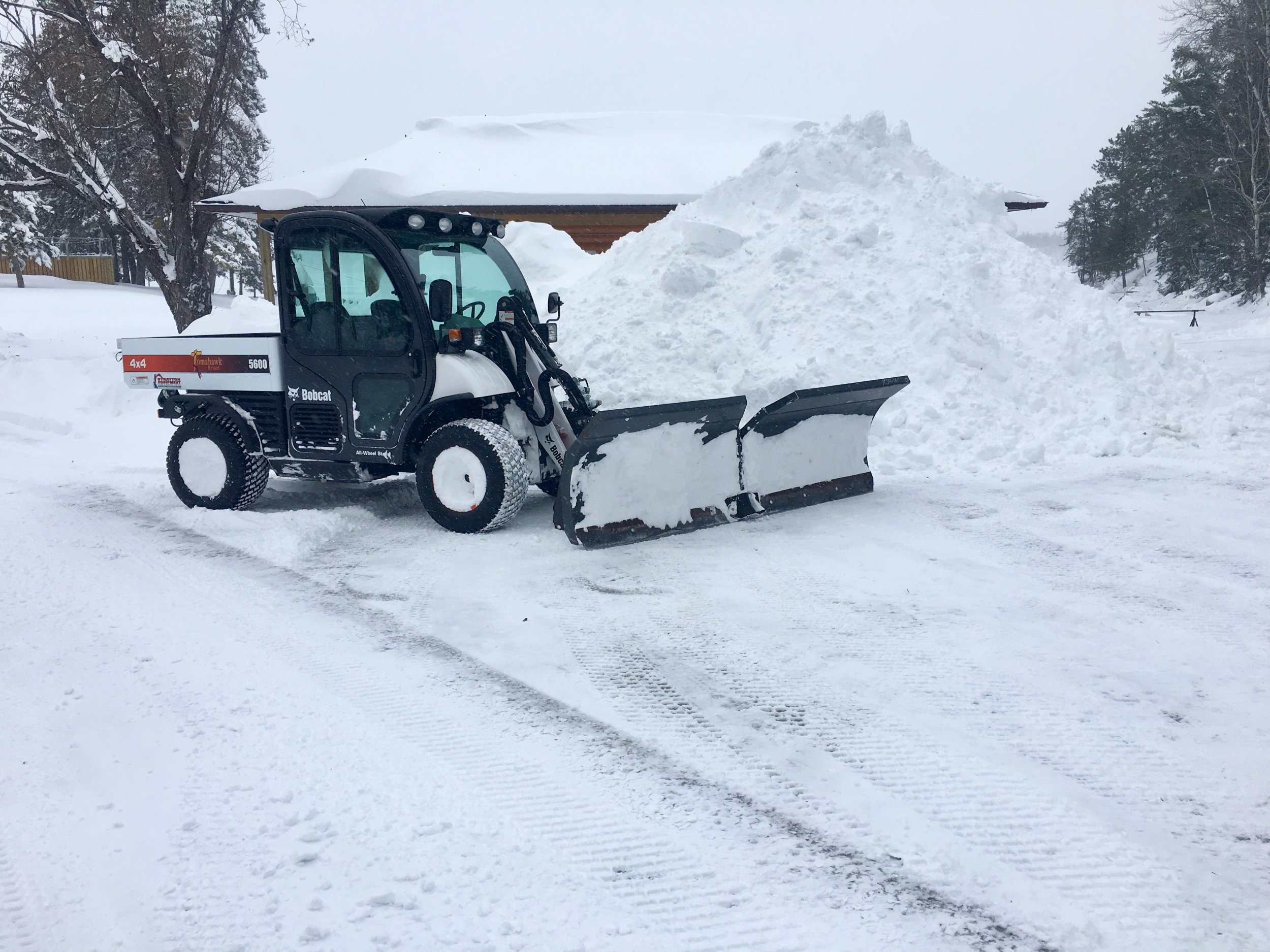

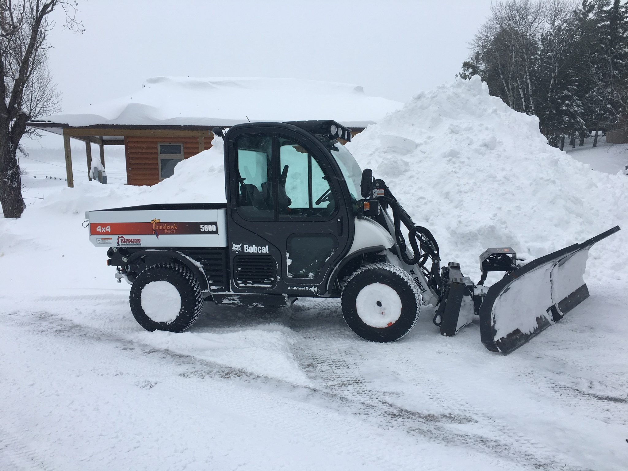

I run a Bobcat 96” V plow (with float option) on my toolcat, I believe it’s around 1000#’s and it works great. It does everything a truck V plow does, and then when you want to make a pile, you can lift the blade 10ft up in the air and can make snow piles as high as a front end loader can. (Snow bank behind toolcat was made by the toolcat). I have run the 88” bucket on my toolcat and found it to big for my uneven terrain. The 74” bucket works much better year around for me with my toolcat.

kevin, I have the same blade but rarely use it due to excessive snow build up on blade, do you have issues with this and how are you preventing buildup
/ What size snow bucket? #8
A warm shovel, plow, blower will have more snow stuck to it than a cold one. I used some silicone spray last year and it seemed to help some.

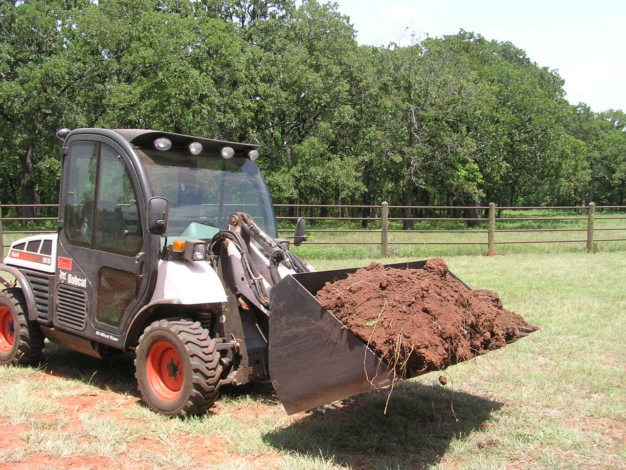

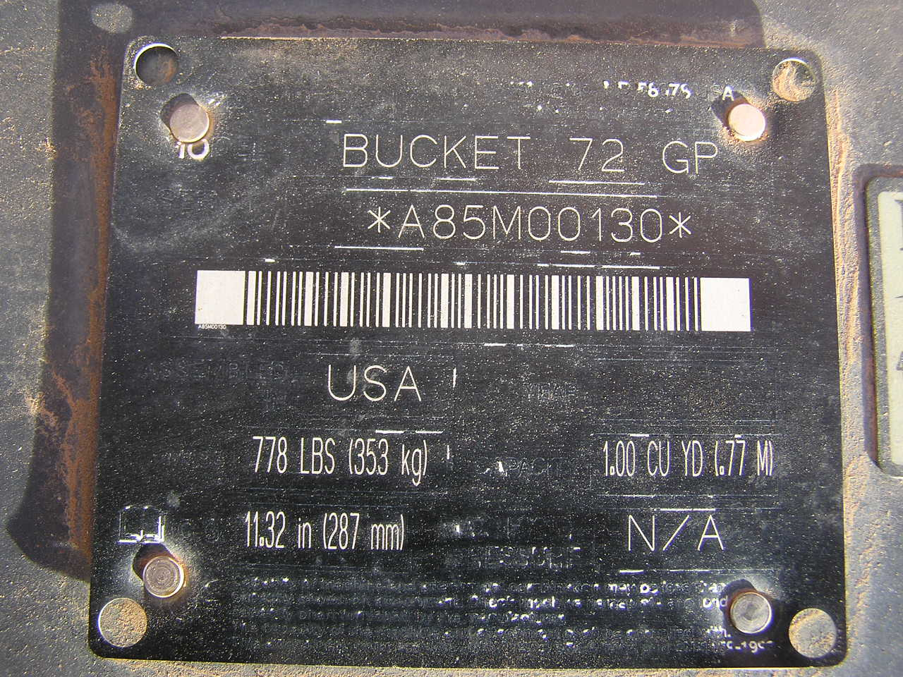

Your Toolcat will handle it:
/ What size snow bucket? #13
thats the same size as my dump bucket, only used for snow and works great the advantage you do not use the tilt function on the machine to empty the bucket
