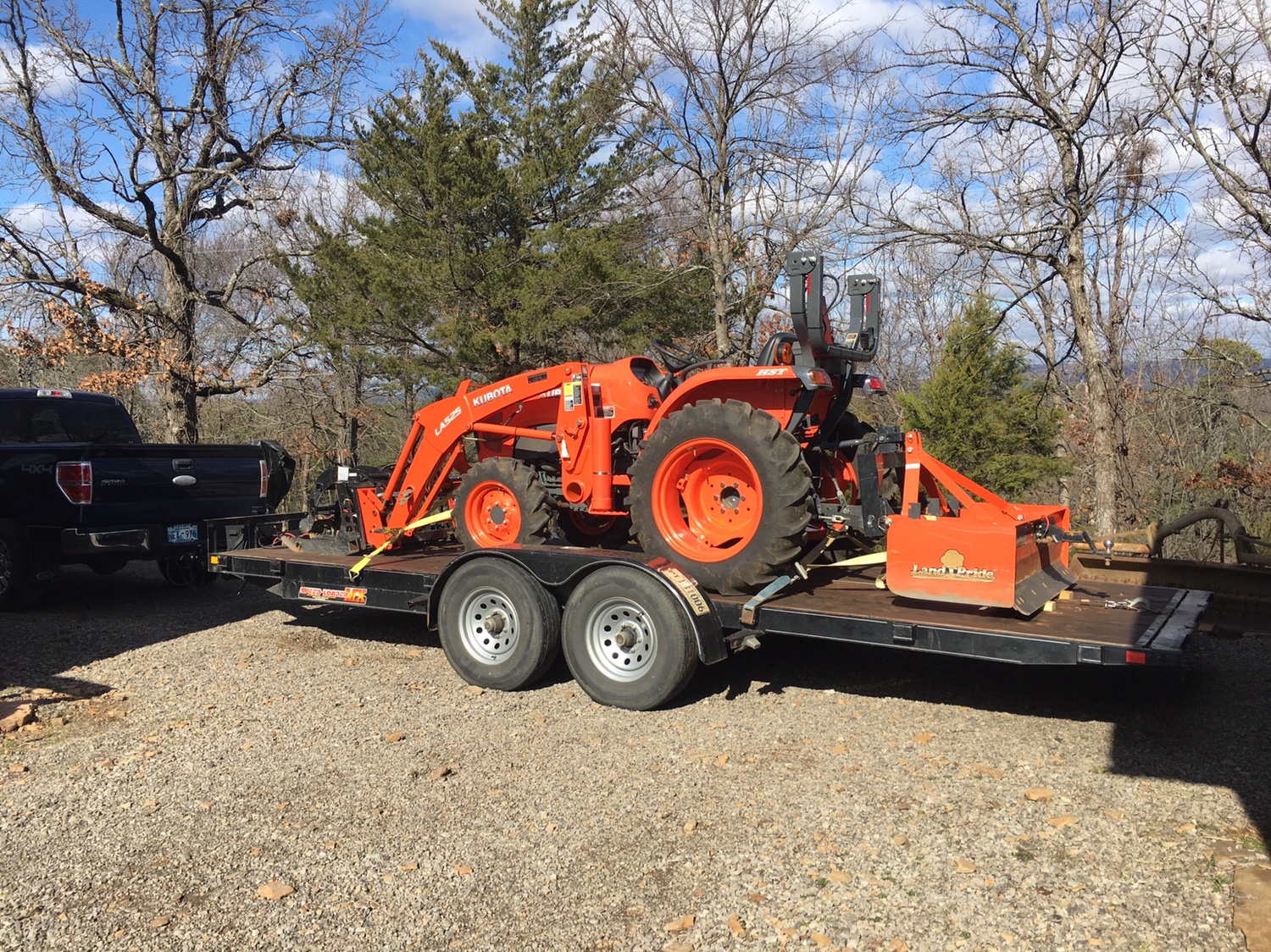

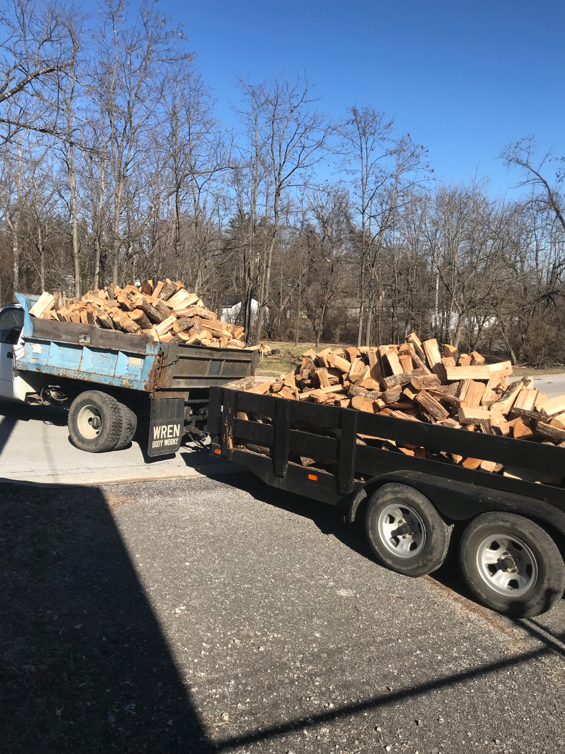

I have comparable-sized tractor (3700lbs) and went with this trailer: Big Tex Trailers 7TV Tandem Axle Vanguard | Big Tex Trailers in a 16' bed size.
I added two more ribs to the tailgate and a couple of substantial D-rings in the bed. I haul my tractor up and down a long 7% grade with no issues. It'll handle the FEL and box blade or flail, but the 5' rotary is too long with the FEL. It also works great for hauling tree trimmings, sand, brick, even two cords of firewood.
It's the only trailer I own that has brakes. It weighs right at 2000lbs empty, which leaves me 5000lbs for cargo. I tow it with a 5.7L Tundra 4x4, which pulls and stops it with authority.

Your axles are adequate, but how’s the rest of the trailer? All the snowmobile trailers I’ve seen are pretty light. I wouldn’t have that big Tex pictured above unless the sides come off. Even then the sides are a waste of money unless you’re a landscaper wanting to haul mulch. Chaining down would be way harder than necessary and loading other things with the loader would be difficult. Here’s my grandpas trailer he uses to haul his L3800. It does the job but I’d like a little heavier trailer because you’ll overload it pretty quick with firewood or logs. I’d like a 14k trailer to use in place of my 22k duel tandem goose neck that pulls like a battle ship. IMG_0909.JPG
   / what size trailer #15
Your axles are adequate, but how’s the rest of the trailer? All the snowmobile trailers I’ve seen are pretty light. I wouldn’t have that big Tex pictured above unless the sides come off. Even then the sides are a waste of money unless you’re a landscaper wanting to haul mulch. Chaining down would be way harder than necessary and loading other things with the loader would be difficult. Here’s my grandpas trailer he uses to haul his L3800. It does the job but I’d like a little heavier trailer because you’ll overload it pretty quick with firewood or logs. I’d like a 14k trailer to use in place of my 22k duel tandem goose neck that pulls like a battle ship. View attachment 537937
While I'd prefer a full-sized dump truck pulling a 14k+ trailer, my needs don't justify the expense. I can't justify the expense of replacing my tried-and-true Tundra with a 1+ton tow vehicle, as I don't do work for others with my equipment and haul less than 10 trailer loads a year for myself. While the Tundra is a very capable half-ton, and is rated to tow 10,700lbs IIRC, I've had about 10k in equipment trailer and 3/4 ton Chevy crew cab behind it on a steep grade, and did not enjoy that experience. I decided to buy a trailer that would carry tree trimmings and brush well, and would carry the tractor as needed - not the other way around. It was relatively simple to add some stout D-rings in the bed of the trailer, bolted through the crossmembers. It's as big as I want to maneuver through the trees on my property, is plenty wide for the tractor, and keeps me from overloading my tow vehicle. It makes a very capable rig for transporting my CUT, which is very similar to the OP's needs.

I debated getting a car hauler and adding sides. That's very common in my area. For my use, the trailer with sides works better than a car trailer, especially after adding a couple of ribs to the tailgate. It's the same size deck. It has spoiled me a bit, as I can contain a load better. I've hauled pallets of bricks and retaining wall blocks, as well as gravel, rock, fill dirt, fertilizer, firewood, and 16' lumber. For trimmings and brush. I was using bucket forks - but I just bought a EA Wicked Root Grapple. Either way, load it and throw a few ratchet straps on it, cinch it down and go. Unloading is more time-consuming, but a large enough dump trailer to haul the tractor would weigh too much. My neighbor is happy to trade me tractor work for use of his 5x12 hydraulic dump trailer if I need it.
If I'd had the funds, I would have bought a car hauler and a smaller hydraulic dump trailer. That would have been close to triple the cost, though.
