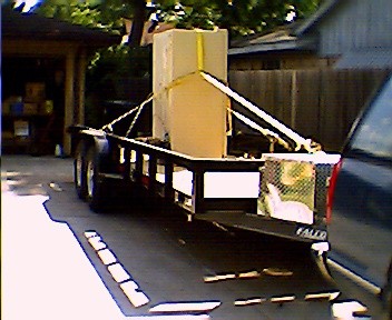

Gary in Indiana,
I measured the deck. It is 20' long. Here are some pics. Excuse the quality all I have is a cheap digital camera. Hope to get a better on soon.

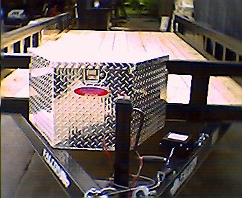

   / what tlr to purchase #15
Here is one of the tool box.
   / what tlr to purchase #16
Nice looking outfit! Is that a battery or what on the tongue next to the toolbox? Is yours a tilt bed trailer?
   / what tlr to purchase #17
That is the battery for the break-away brakes. In Texas all trailers over a certain weight have to have this in case the trailer gets seperated from the truck it locks the trailer brakes.
Haven't had to use it yet!!!!
