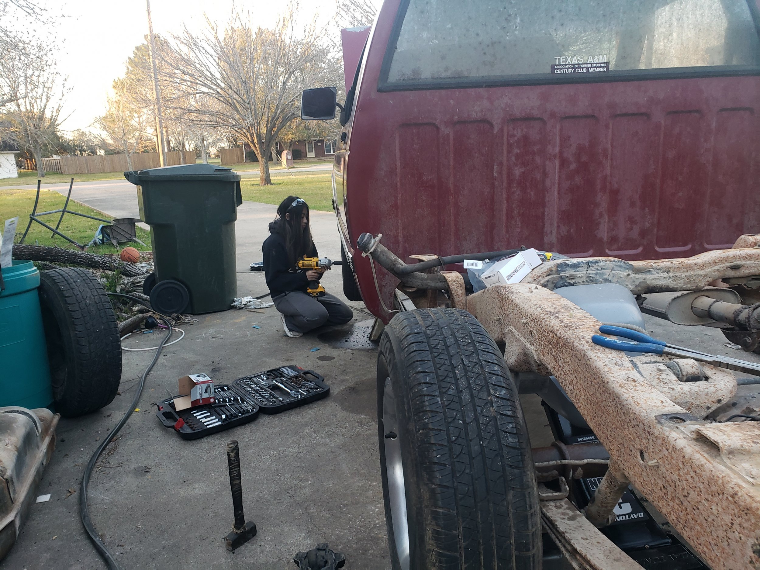

How about some pictures?
One man's surface rust is another man's catastrophe. Pictures should show others what you have. ;)
This is bad for a TX truck but I've been out of the state a time or two so I know they can get much worse and still be considered "fine" by loads of people. I'm just not one of them.

I decided halfass is better than noass. made up my mind today to just go ahead and put the truck back up on Jack stands, pressure wash, spray with ospho, and paint with rustoleum professional flat black, whatever we can reach. The most complete solution we can achieve short of taking the cab off. I stopped on the way home today and got the paint and some spray bottles for the ospho but they didn't have ospho at home depot or tractor supply. I will try ace hardware tomorrow.

Sounds like a plan.
(If it were me, I would have my long hair tied back to keep it away from a drill...preferably tucked down the hoodie with the hoodie drawstrings out of the way, but that's just me.)
And yes, that's a lot of surface rust in my book. Parked on a swampy area for years?

Hose off the loose stuff and paint POR 15 on it. POR is some very durable stuff. I have used it and you can beat it with a hammer and barely scuff it. It is made to go directly over rust. Take the cab bolts loose and barely jack up the cab and you can get to the top of the frame. A half gallon would be plenty. It is thin and gets every where but it makes a nice protective coating. Nice to see a young girl working on her ride. Teaches pride of ownership. Good luck with the project.

Good plan of attack on the rust. After you do that, it'll last for years.

From the pics it looks pretty good to me, I’ve seen a lot worse. It’s nice you got your daughter to work on the project. Mine wanted nothing to do with working on cars.
