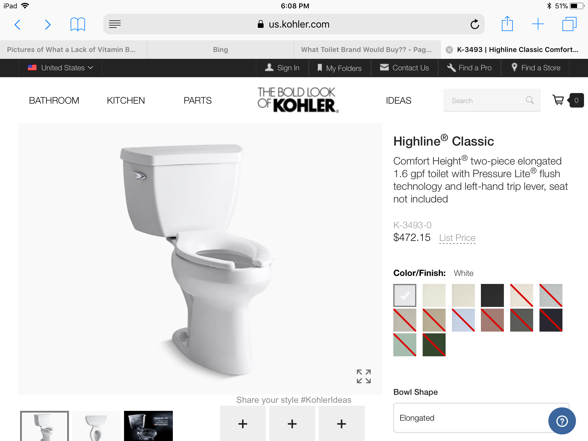

Consumer Reports rates the Kohler Highline Classic as the second highest toilet. They also list it as a pressure flush vs gravity and there are reports of a few problems with the Flushmate pressure tanks. I am not experienced with pressure tanks on toilets and the house I need to replace a toilet in is on a well with the pressure low. How much pressure do you have?
CR is wrong - the Kohler Highline Classic is "Single-flush gravity uses the force of gravity and a precision-engineered tank, bowl and trapway to create a strong siphon during flushing"
Not familiar with the "Flushmate" assisted toilets? Let me explain it this way...picture being on the tarmac when a 747 takes off! I have 3 Kohler's here and have to warn guests to be prepared for the flush (not as bad as some European toilets that will send a splash of warm water up, followed by warm air, all in a plan to eliminate toilet paper). But they work great. As I understand it, the thing to look for is the diameter of the internal "guts". The more expensive toilets will be larger. And yup...the Flushmates have had some issues that resulted in a recall (it's a plastic tank that resides inside the water closet) and I understand they will need replacing sooner or later (warranty is 10 years I think).
   / What Toilet Brand Would Buy?? #27

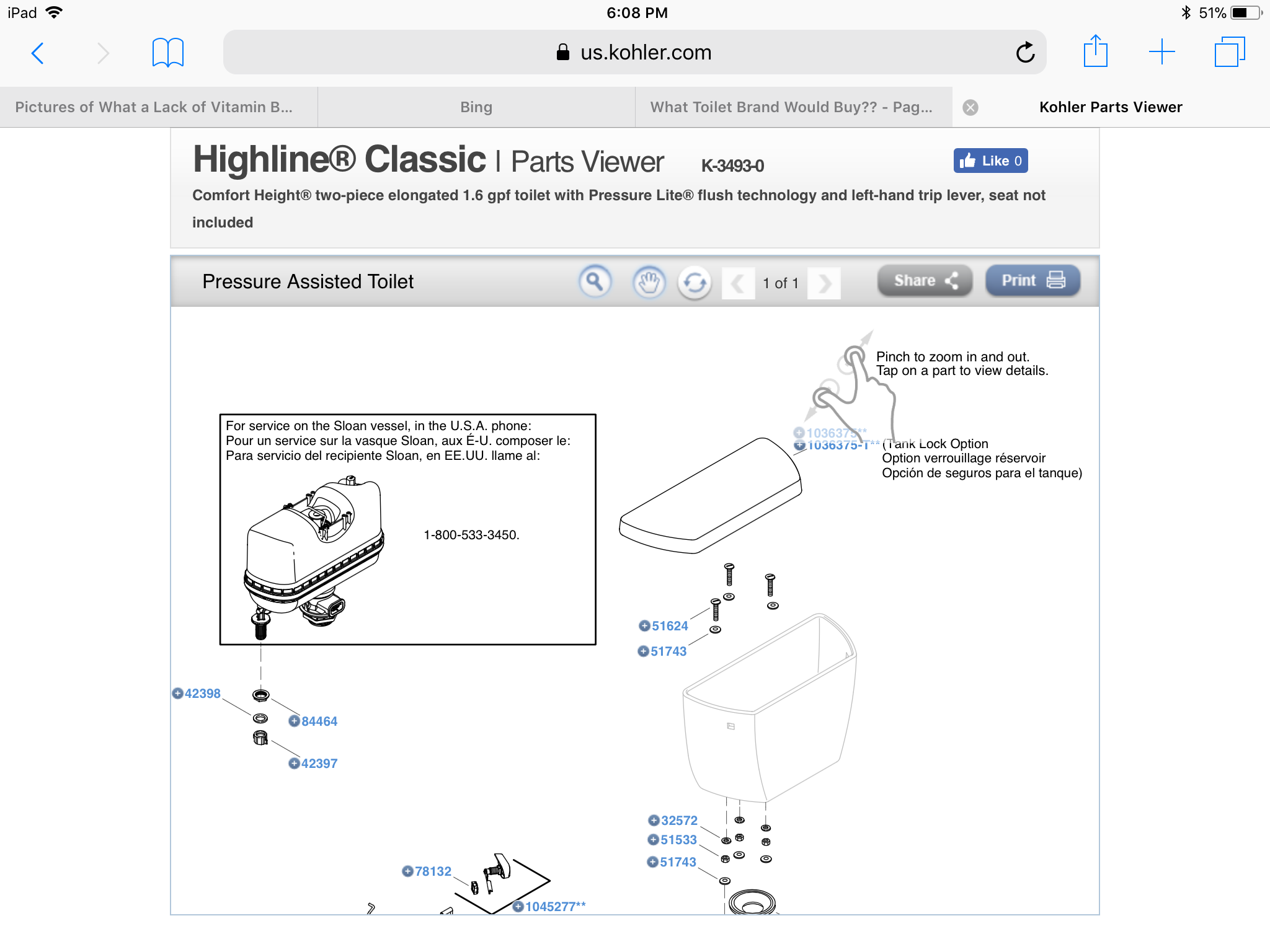

CR is wrong - the Kohler Highline Classic is "Single-flush gravity uses the force of gravity and a precision-engineered tank, bowl and trapway to create a strong siphon during flushing".
The Kohler Website also says the Highline Classic has a pressure system, CR appears to be correct.
