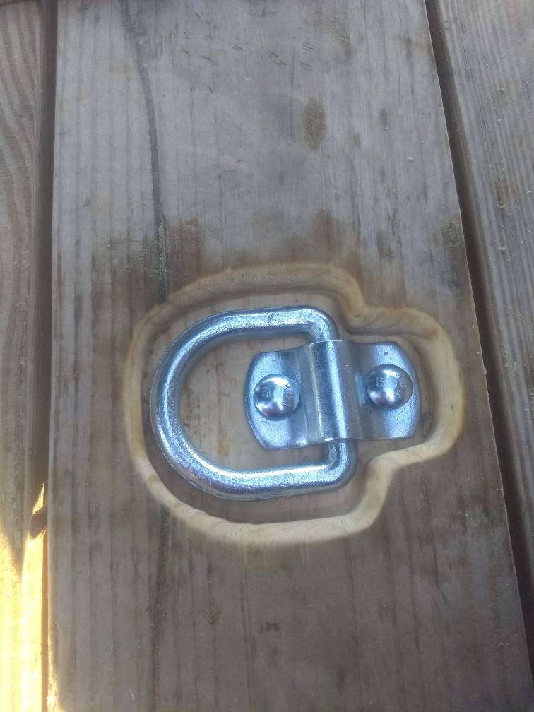

I like having a wood deck. It's something easy for me to replace, work on, and modify. I recently flush mounted some D rings in key locations by routing out where they needed to go.
I'm much more experienced and much better equipped to work with wood than metal.
I have also occasionally screwed something to the decking to help secure cargo.
That's a slick idea if the trailer lives under shelter. If not, I guess one could also incorporate drain holes.
   / What trailer should I get for Kubota Tractor, and what should I pay? #23
I thought about drilling some drain holes, but I do keep it parked under a shed. I still may do that at some point.
I wanted them recessed because I will haul mulch and whatnot occasionally, and wanted a flat surface so I can scrape it out with the bucket.
I built some sides that go into the stake pockets to contain the loose material. There is a back that goes on when needed. Eyes are attached for a tarp.

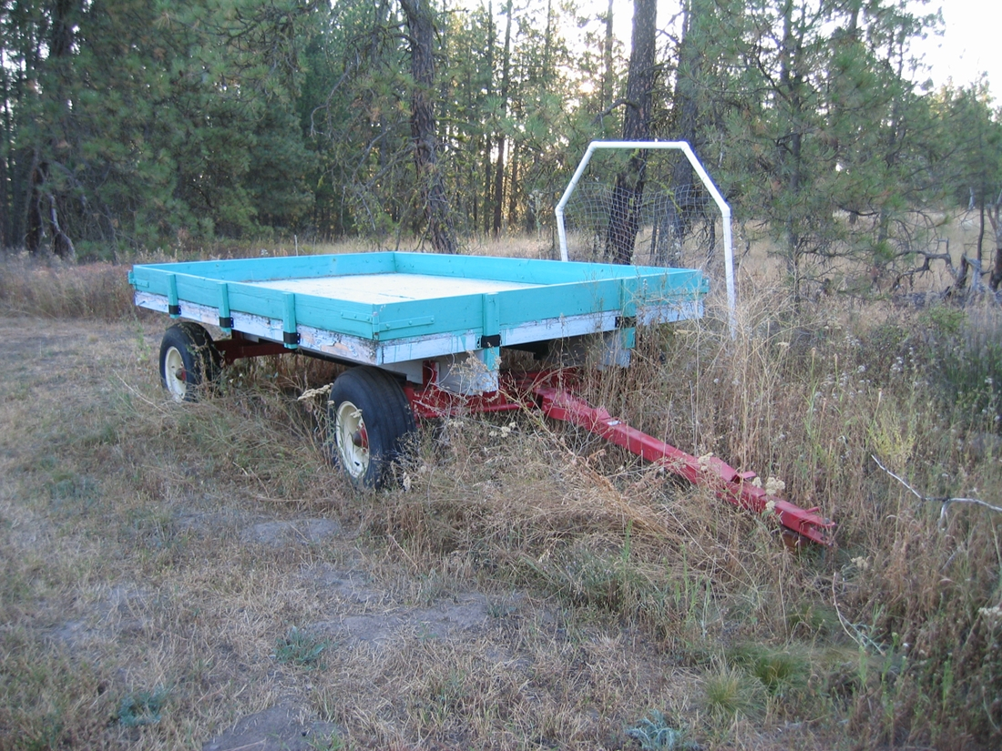

Ha - there was a time I though about a new road-able trailer for my M6040 @ 10,000#. Reality hit when I checked on the price. Instead I built a farm trailer with brand new ten ton Horst running gear. My plan to pull the M6040 to remote locations fizzled. The farm trailer is all I need here on my 80 acres.
Is that protective cover for wild grasses and bunnies ? :)
   / What trailer should I get for Kubota Tractor, and what should I pay? #29
Of course - Newbury. It's also because the darn unit is too hard to pull by hand. Too lazy to move it with the ATV when I mow.
OR - if you are speaking of the white arch with the chicken wire. That was for my wife's climbing flowers. Has nothing to do with the trailer. I just happen to park next to it.
