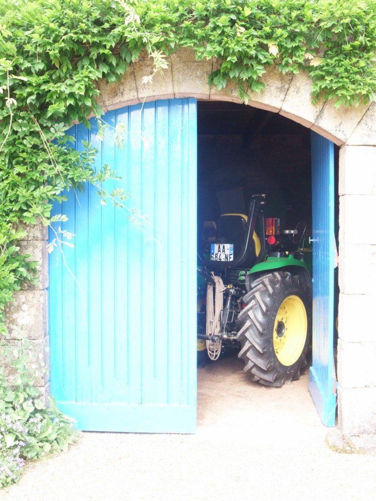

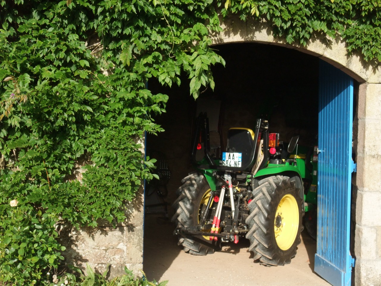

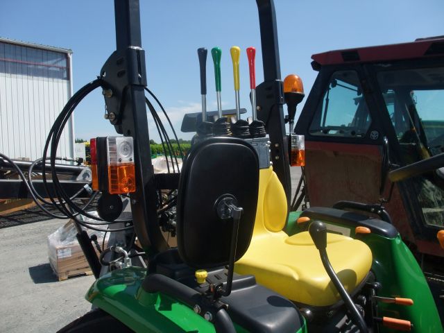

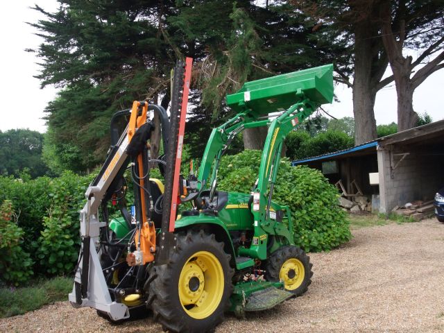

Time for me to play devil's Advocate...:D
The problem isnt the 3rd SCV...its working as it was designed...your using the 3rd SCV for a use it was never intented for. If you want constant oil back there you should have the Power Beyond setup installed...that is made to supply oil back there all the time as you would like.
I bought my tractor with a hydraulic hedge trimmer on the back (hydraulic cylinders and hydraulic motor) which cost about half the price of the tractor and is to be used about a third of the time. The JD dealer installed it on a 3rd SVC. It's a pity he didn't know it was never intended for that!

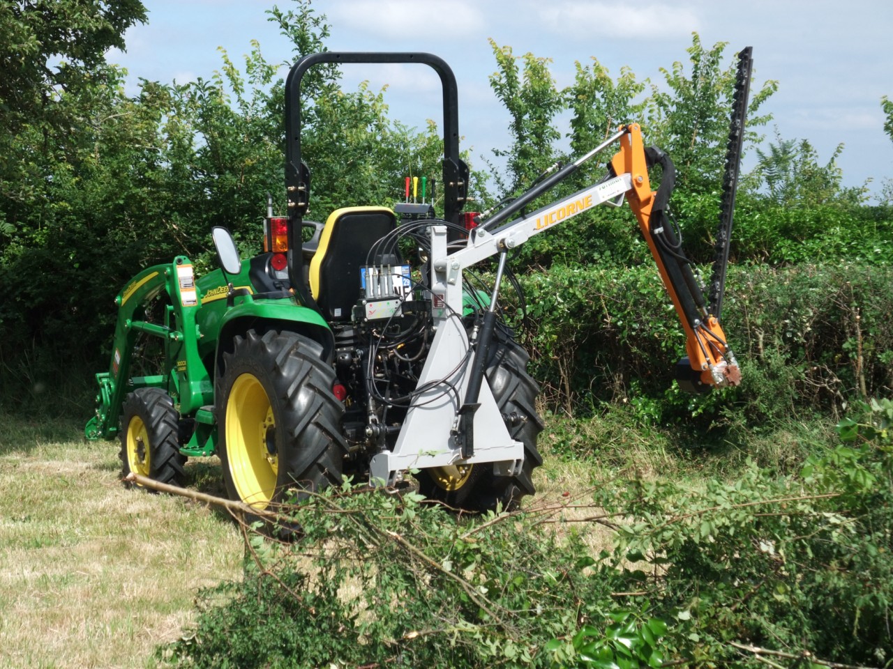

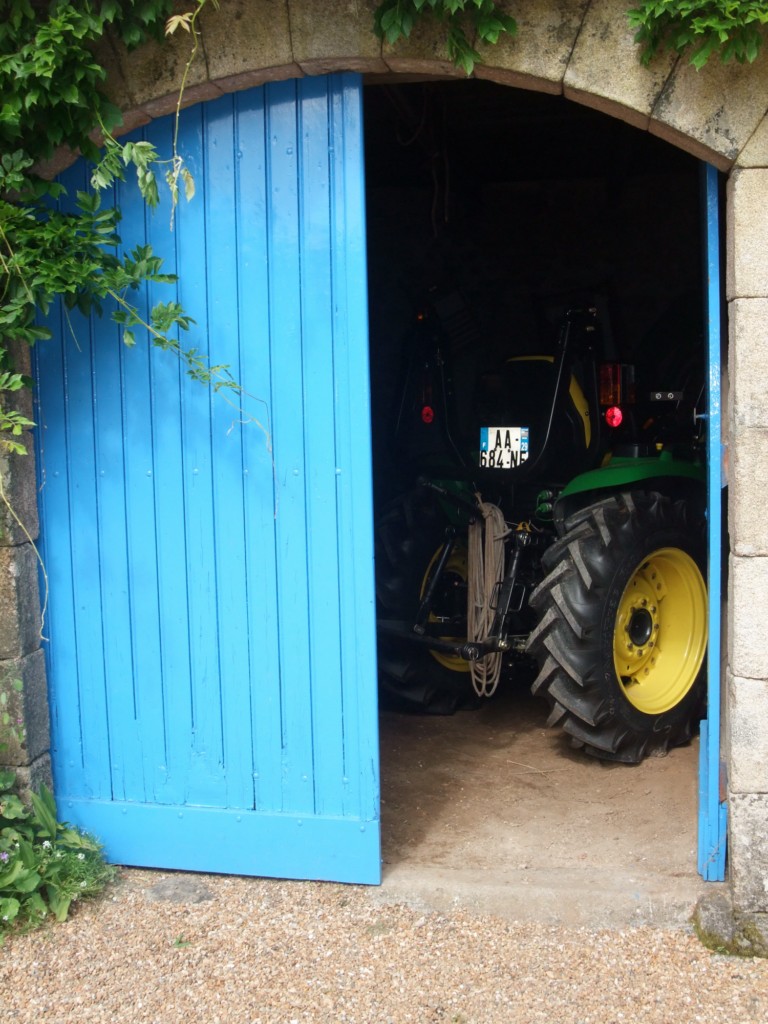

a lower ROPS that would fit standard garage doors. More generally, the tractor seems designed to operate in vast open spaces, without walls, garage doors, low branches hitting the lights or bushes catching the hoses under the tractor, etc. An effort should be made to make it more practical.
"By reducing the ROPS height, youd reduce its effectivness...Mebbe the problem isnt your tractor, but your garage door"
Today I welded back on the tube that receives the amber flashing light on the ROPS for the third time this month. I sure will have to think about growing taller trees, if possible without any branches.
By the way the doorway to the garage is massive 19th century granite, not easy to modify.
