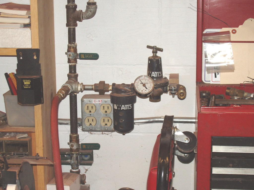

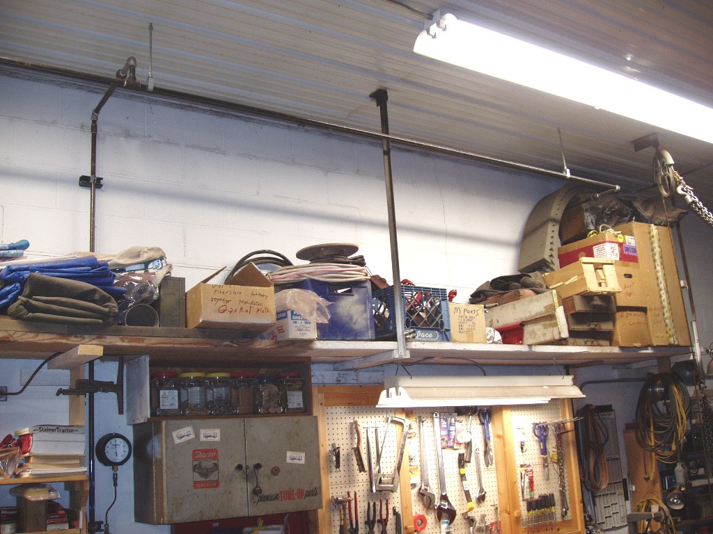

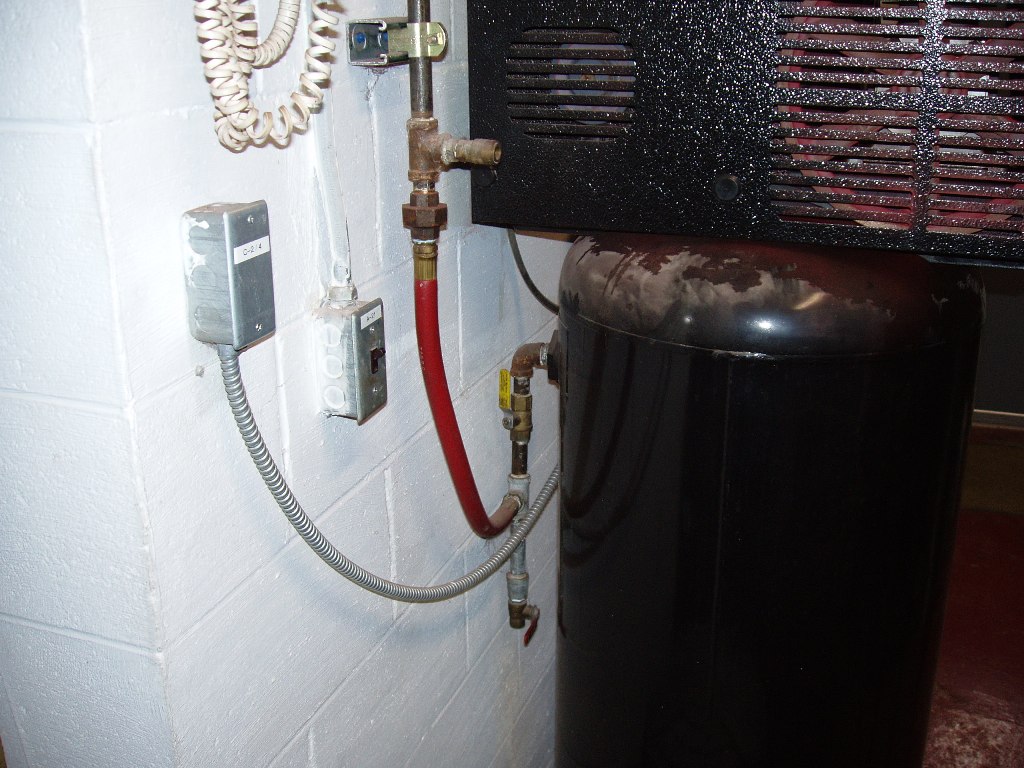

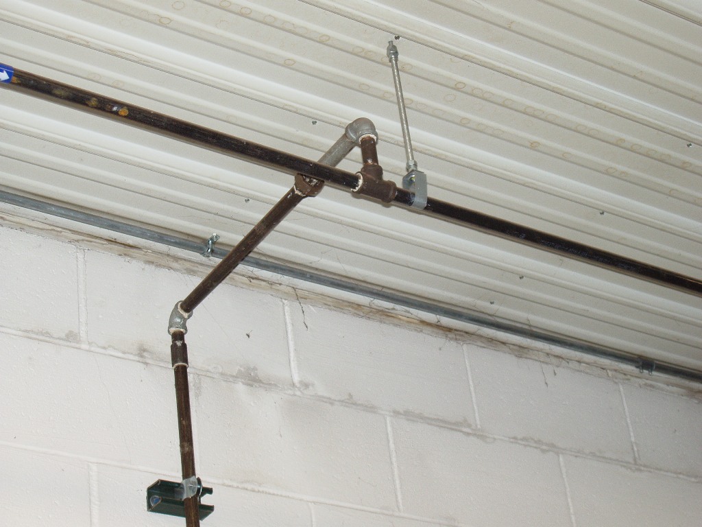

Where can i get the stuff i need,[Ive never worked with pipe]Does lowes or homedepot sell the pipe elbows fittings etc? Will i need to be some sort of pipe threader for the ones i cut?Im afraid you guys will have to walk me through it.Also can one give me a link on a good water seperatorand regulator to buy? Im heading out now to take pics of my setup now.
ALAN
A few pics of an air system
The first is a vibration method and water drain for the riser
The second shows tapping THE TOP for air use
The third shows a dual pressure station with isolation and drain
The fourth is a main line extension with water drain on the wall
I should point out that the main is highest above the compressor and must run down to the end at the drain so air and water travel the same direction.
