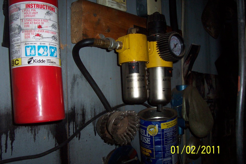

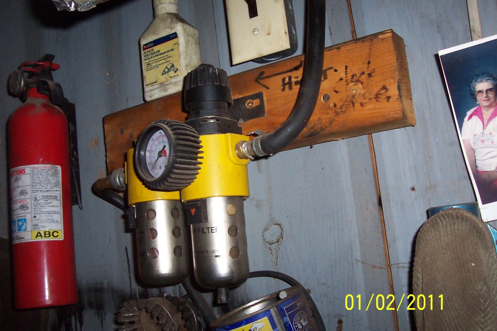

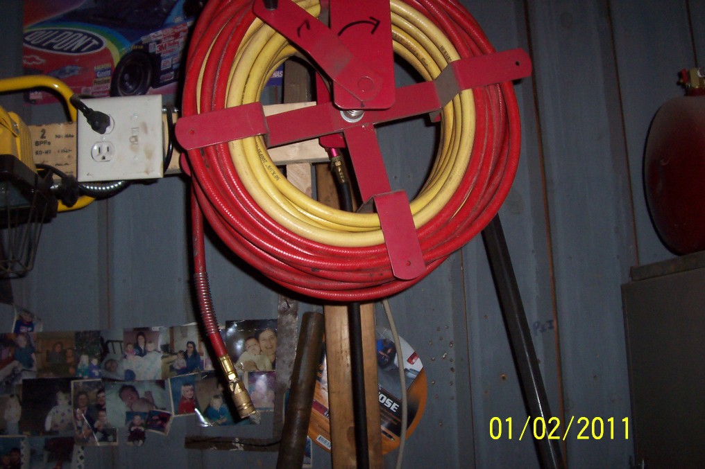

OK Heres shots of my train wreck of an air system ive used for years .I never knew why my impact never worked good now i think i do.Amazing the things you learn on TBN.heading to hd tommorow to look for 3/4 iron pipie and fittings
ALAN

so im curious too should i go pipe or rapid air system.Ilike KEVIN JS pipe system,[:Dprobably only take me 100 trips to the hardware store]and am willing to go that route if its the best .Kevin is that 3/4 pipe?so lets poll who thinks i should pipe it ,who thinks rapid air would be as good?
ALAN

I'm going to guess too much line with too small a compressor.
I have to agree with an earlier post which suggested trying a 25-50 foot 3/8" or 1/2" hose straight off the compressor and see if your results improve. If so, then you can begin to look at how to overcome and improve on the limitations of your system before jumping out and spending a lot of money.
   / WHATS A GOOD IMPACT WRENCH? #49
Truly astounding. You have a good impact gun that is not functioning properly. Are you using an extension?:eek: - they are springy. More than likely you are starving it for air. Use no regulator. Use no hose reel. Use no extension. Use 50' or less of 3/8" minimum air hose directly out of the compressor tank at at least 120PSI. If it wont twist off a grade8 1/2" bolt take it back. If it wont twist off a 5/8" consider taking it back.
larry
Good advice. An alternative is to mount a second receiver (tank) at the remote location with a big, short line going to the gun. Any regulator must be upstream of the remote receiver. What makes air nailers so fast and powerful is the tank built into the head of every nailer.
Quick-connects are also a huge source of restriction. Euro-style quick-connects flow better. Also any female quick-connect can be opened up by unscrewing the halves and removing the check valve. You'll then need a manual ball valve in the system to allow you to disconnect safely.
Most twin-hammer guns are pretty good and more frugal with air than the cheapies.
ALAN
The problem with steel pipe is unless you have a friend with a pipe threader the costs can add up quickly. Fine if you are only going to run one line with very few bends and your not picky about how accurate you are but once you start running several drops it can get pricey. Secondly make sure you use malleable fittings.
