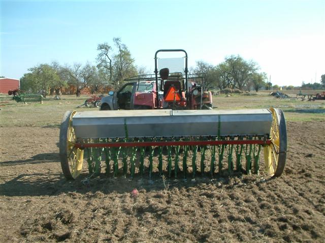

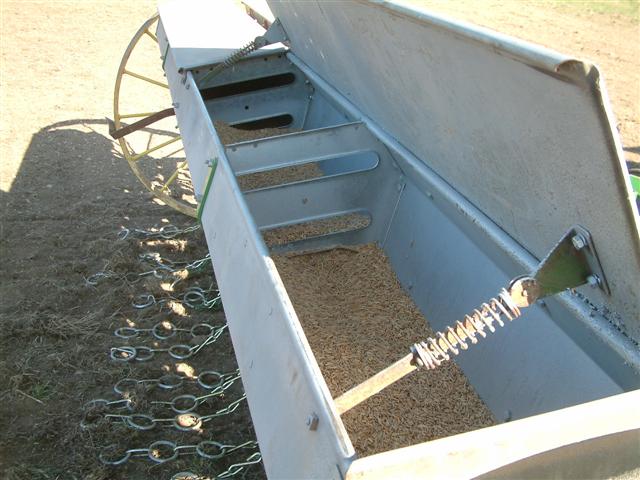

You could use a grain drill--my old, restored Minneapolis Moline P3-6 drill (10-ft wide, 20 hoes, single disc openers) will plant soybeans, corn, peas, common bean). I've only used it to plant Kanota oats. Use the large fertilizer box for the big size seeds.
DSCF0156 (Small).JPGDSCF0157 (Small).JPGDSCF0158 (Small).JPGDSCF0159 (Small).JPG
I bought two of these units for $275, used parts from both to make one working drill, spent about $200 for parts (mostly fasteners and a hydraulic cylinder to raise and lower the openers). Spent about 2 months getting the drill assembled and calibrated for oats and granulated fertilizer.
Food plot folks like yourself have spawned a market for old grain drills--small size (5-ft wide or so) obtained by cutting larger drills in half. I looked at these for my hayfield (which is only 6 acres), but these dwarf drills are still too pricy for my likes ($1500 and up on eBay, Craigslist, etc).
Good luck

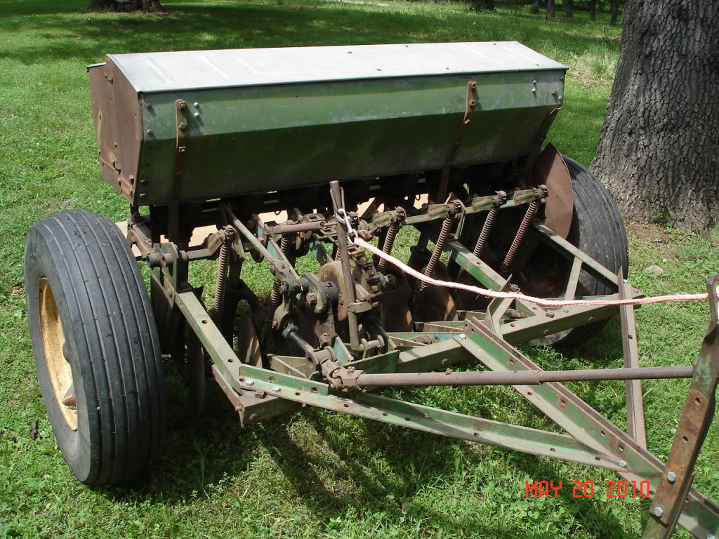

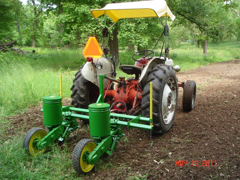

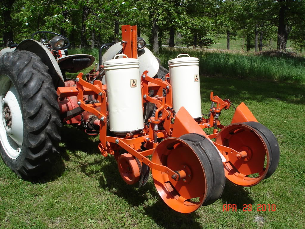

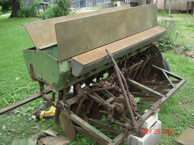

I like messing with planters and drills. The older stuff is tough, and works good. First one I refurbed, was a 2 row A/C 600 series plate planter. It was simple to set up, rugged, used JD plates with an adaptor, and was HEAVY. Used it for several years, it's got a new home in SE Oklahoma. Found an old JD Model FB 15 X 7grain drill. Right side drive gears were stripped out on it. Decided I'd cut it down to a 7 X 7 for a food plot machine. It looks like it was made this size, and plants a mean rye or wheat plot. Next is a JD 2 row # 6 lister planter. This planter came from western Kansas. I thought the spoke wheels looked sharp. It's a mechanical trip lift, manual markers. Pretty cool old planter, works great. Found these JD 70 Flexi planter units. Built a toolbar for them that I hope to incorporated a fertilizer feeder on. I have 2 more I'm in the process of rebuilding. Replaced bearings, disc openers, scrapers, and seals on the disc opener bearings on the pictured ones. Now I'm working on this FB drill. It had a busted frame and lift clutch, on the right side. Started out as a 17 X 7. Now it's a 8 X 7, with working fertilizer and grass seed box. I think my favorite of all of them is the # 6 Lister. Believe it or not, the Allis Chalmers units are the newest. They were late 60s units, the 2 FB drills are 1950. the #6 is 1950, and the 70 Flexi units are late 50s. They plant the best, can adjust to about any row width, and are really accurate. Mark
