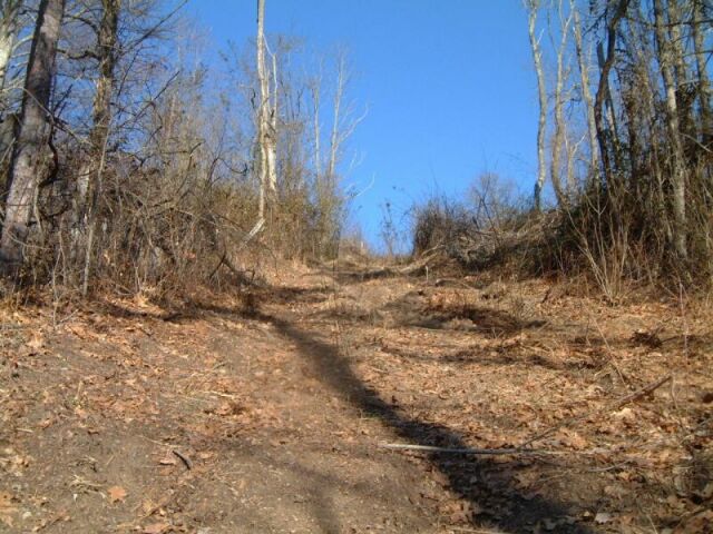

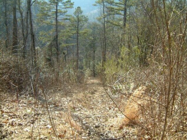

ran out of daylight but was making some progress. It moves now..but you sure can't give it any throttle. Once I hit a spot that requires it to really dig those wheels in ..and i give it some throttle...tha'ts it for awhile. No Go.
here's a pic trying to show slope i'm coming up. This is from top of hill where i need to be for it to be level

looking up the hill from tractor

Uggg, what a view. And I thought my trails were tough. I just caught up with this thread and really thought we'd see that you got her out last night. Man, I feel for you. Best of luck SMM, hope you get her home soon.

Isn't that the hill that bloke in "Man from Snowy River" trotted his pony down? /forums/images/graemlins/grin.gif
Glad to hear yer makin' progress!

Good to hear it's able to move a little.
Patience and it may just make its way home. Perhaps a little shovell work to fill in holes or such ???
