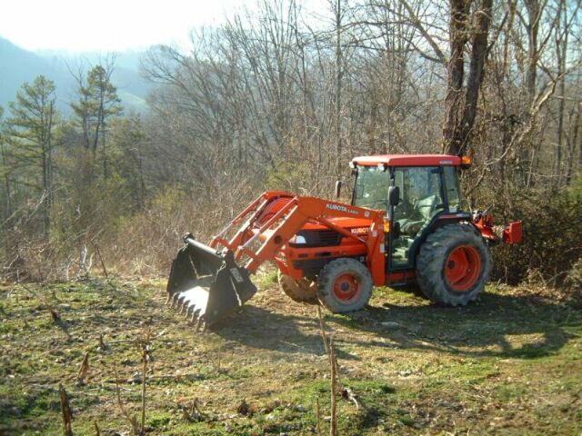

A Picture Worth a Thousand Words (or 9500 posts)

Don, it looks great. Did it drive home okay once you got it up top? That has to be a big relief and boost to your moral. That's enough to make a guy want to celebrate. Congratulations on the accomplishment. By the way, don't drive that tractor back down that hill. /forums/images/graemlins/frown.gif /forums/images/graemlins/blush.gif /forums/images/graemlins/wink.gif /forums/images/graemlins/smile.gif

used a 'come-along' attached to trees with a strap, 4 log chains, when i ran out of cable on the 'come-along", I used bucket to pull forward, got it at a spot that wasn't quite as steep, used the 'uzi' water gun and managed maybe a quart of fluid in, cranked her up, eased in low range, barely any throttle, got over some wheel ruts, couple of root mounds, suddenly it lunged forward...i gave it all i had...came right out.
Seems to be running fine, all i've tried works, no smells, no leaks, fluid shows just a 'hair' above mark on stick.
