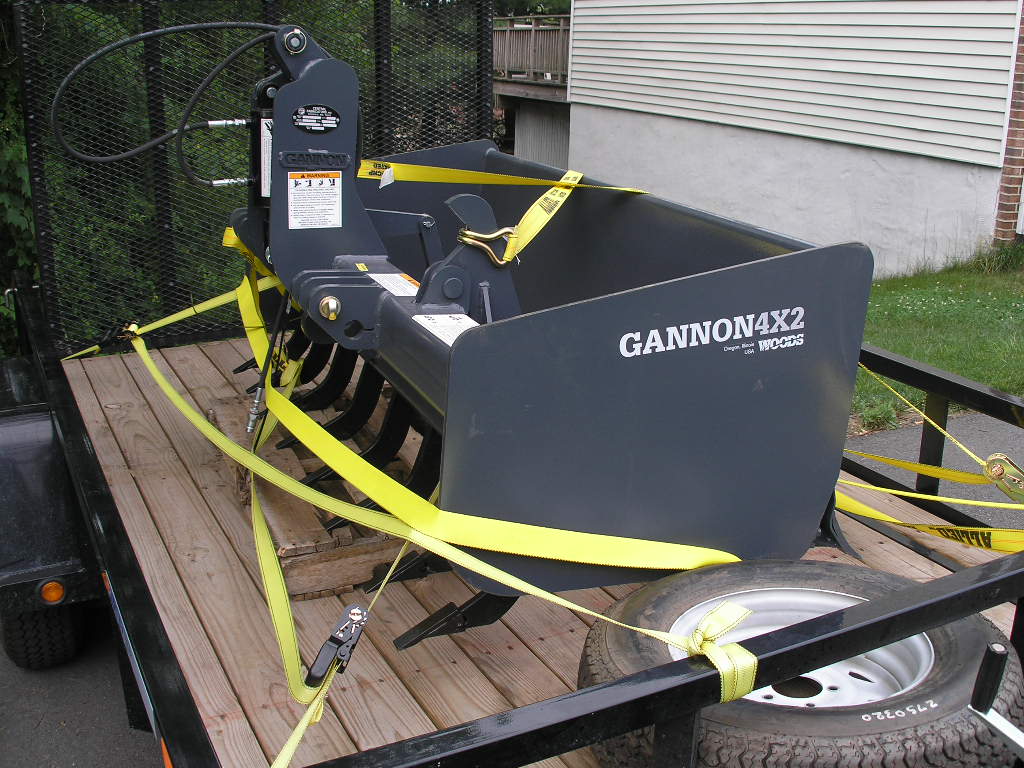

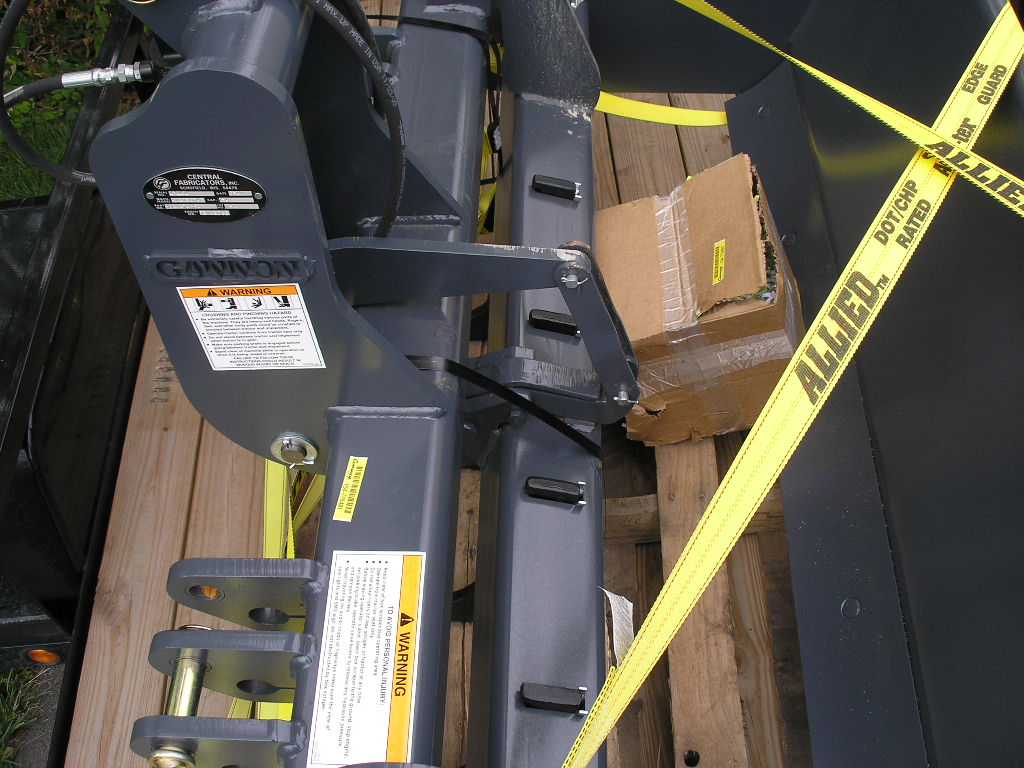

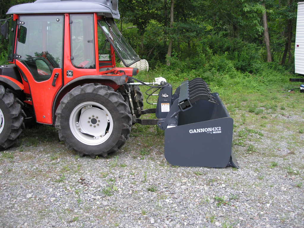

+1
It's advice like this on the forum that led me to buy a quality BB, my first implement BTW. It's expensive and weighs 1300 pounds but it sure does peel up the soil with no bounce or chatter. It works really well at dozing also because it will dig in rather than lifting up.
How far will you have to drag your soil? Do you have low spots to put it in? These are some considerations when choosing a BB.

+1
Now there is about the best example of a cat1-2 box blade that there is. :thumbsup::thumbsup: OldandWorn, it looks like you need a "TnT" kit to get the absolute best performance out of that box blade. It makes me smile when I see people purchase top of the line implements. :D :cool2:

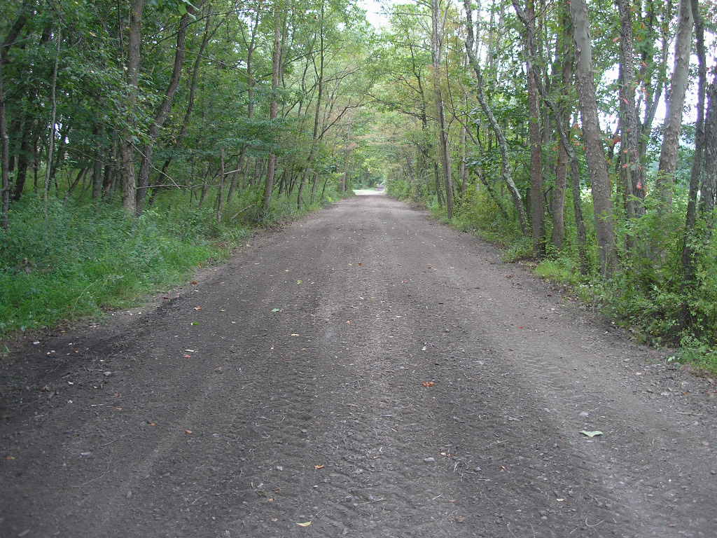

I hear ya! My plan was to have TNT installed before I converted my "4WD only road" to this but I was fighting time and the dry season. Used to be nothing but mud, ruts, and water here. Believe me, I was cursing every time I had to get out and adjust for crown and aggression. Going to plumb them in and leave my remotes free. Working on the parts list.
That is a great looking road!:thumbsup: How long is it? Once the road is made like yours is, I have found that one of these road grader blades works great to maintain the road.

+1
Very nice BB:thumbsup: If you don't mind, what's the ballpark price on that thing?
I don't have to drag it far, just around the corner. I do have some large depressions that I would like to fill in.
What's the working difference between the BB and the Road grader? I understand how they are different but I would like to know why you would use one in place of the other.
