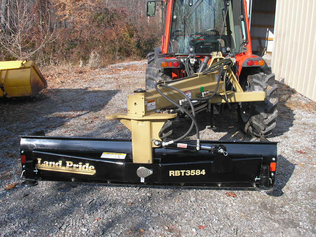

If I understand you correctly you paid about $2300 each for the Gannon boxblade and the Land Pride rearblade, I think you did very well. I think if you add a top quality landplane/grader to the stable you will be in the cat bird seat.

I intend to get a rear blade similar to yours when I have the funds.

Probably was me, only remember seeing one other one here on TBN and that guy bought an RBT4084 barely used off of Ebay for some really good price if I remember correctly. Same as yours though, had everything. My skid shoes were $200 :eek: but boy do they make a difference when your finish grading. Can't help out as far as the end plates, although I would think that if you were trying to move dirt any distance at all that they would really help. I don't think that I would want them on when I was actually grading though. I like to have the dirt rolling off of the blade, that way you can basically go forever. On your 6000 feet of road you can go from one end to the other without stopping. I doubt that you can do that with the end plates on the rear blade or with a box blade.
I only have the angle hydraulic on right now because I only have 3 rear remotes at this time and the other 2 are used for the "TnT" hydraulics.:eek: Have an additional 2 valves to add on, have the valves, just have never gotten around to it. But to answer your question about being spongy, no, the blade is rock solid.
As far as having a top of the line rear blade with hydraulics, they just can not be beat IMO vs a blade that was never intended to have hydraulics. I have a middle of the road none hydraulic rear blade also, that was what my dealer sold me on. A little over $1000 6 years ago, I have NEVER been satisfied with it and it was no where near heavy duty enough for the tractor that it was sold to be used with. Just a lesson to not go along with the dealer without research of your own to back up what your being told. :ashamed:

Steve, whenever you do get that Land Pride RBT3596 or whichever brand you get, the difference is almost unbelievable. Just like all the implements, there really is no comparison with the top of the line units vs the other more economical pieces. We are back to we get what we pay for.

I will get a new rearblade this year hopefully and the LandPride is certainly something I will look at.

I just wanted to come back and say thanks for the advice you guys gave. I heeded your advice and waited til a decent blade showed up on craigslist. I finally found one, a cammond 4c2 76 inch box blade wig hydraulic rippers. I posted about it in the attachments forum.
I just wanted come back and say I am so glad I waited. The heft of the blade is tremendous and the hydraulic rippers make the job so easy. I dont even want to think of my what my frustration level might have been with the manual rippers. Thanks again guys!
