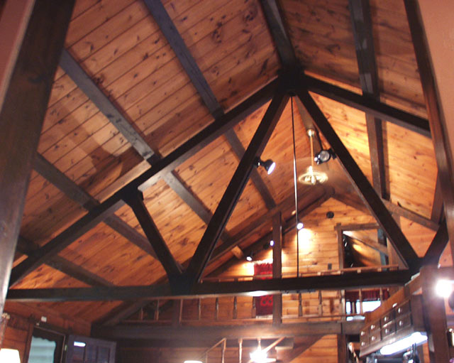

Thanks to everyone for the responses... seems that from what I know now, it would be reasonable to suspect...
<font color=green>The sheathing not being staggered probably contributed to this
There probably isn't proper spacing between the plywood sheets
The skylights are probably allowing moisture in, which would contribute to the curling of the plywood (which happened because of improper spacing/lack of staggering).</font color=green>
The skylights were added about 10 years ago, after the house was built, so I think one of the first things I'll do is have those looked at, resealed, or whatever.
After that, I'll have someone take a small portion of the shingles off, in a problem spot, to further investigate the condition of the sheathing and determine when something needs to be done about it.
Seems that a reasonable solution to this, any way I slice it, is to replace the sheathing with proper grade/spaced/staggered plywood... that is, after I ensure the skylights aren't going to allow moisture in the next time around.
There haven't been any leaks in any art of the roof, or around the skylights. And as I said, this has developed really in the past year, with some visible progression this (very mild) winter and (very wet) spring.
There is really one main truss (6x6 exposed inside) essentially in the middle of the main part of the house, plus two smaller trusses ... and the ceiling beams are horizontal, not vertical.
See the attached photo for a better look at how the inside is setup... sorry about the quality; I didn't take it for this purpose. /w3tcompact/icons/smile.gif The skylights would be to your right in this photo.
Again, thanks for the knowledgeable answers. /w3tcompact/icons/smile.gif

Muhammed,
I've been following this thread and taken a hard look at your roof pictures.
That said, the "H" clips are used between trusses (24"OC) to support the plywood for that span. They are not required for rafters (16"OC) or on trusses if the sheathing material is 5/8" or more.
Your picture depicts a classic example of improperly installed sheathing and also trapped heat and moisture. In looking at your ridge vent, it starts and stops along the peak. Is that for looks or do you have a return gable on the other side that requires it to stop? Usually a ridge vent runs from gable to gable stopping one foot short of the gable rakes.
Do you have ice dams in the winter months? This is a good sign of heat loss and poor ventilation.
Have you inspected between the trusses or rafters on the eave walls to insure proper flow of air from your soffit vents? Are your soffit vents adequate enough? Do they allow enough air to circulate through to the ridge vent to keep the underside of the sheathing dry? Are there baffles installed? A lot of times, homeowners will blow in additional insulation (cellouse, etc.) and unsuspectingly plug their eave passages. The results don't show up immediately, but gradually over time.
The final line is, the roof has to breathe. The next step for this roof is rotting sheathing which will show up when someone walks across it and ends up in your living room.
If the plywood is curled but not rotted due to inadequate ventilation the fix can be inexpensive. Correct the ventilation problem, remove all shingles and roll on 30# paper to smooth out imperfections before reshingling.
