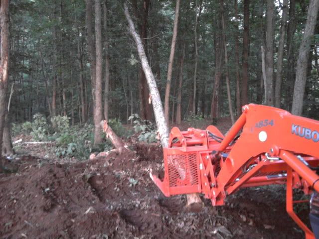

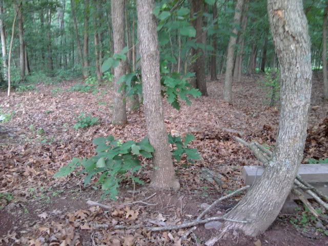

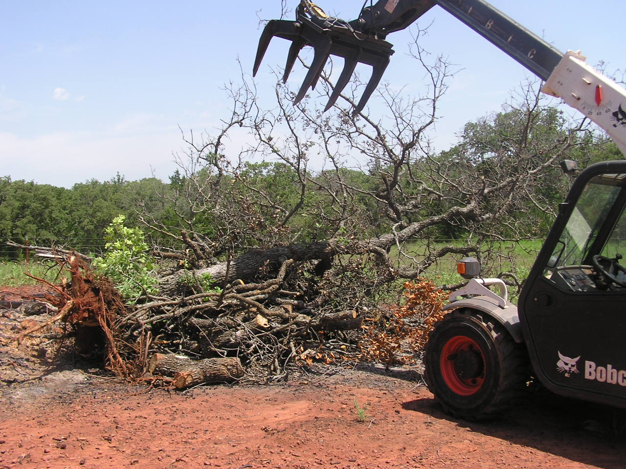

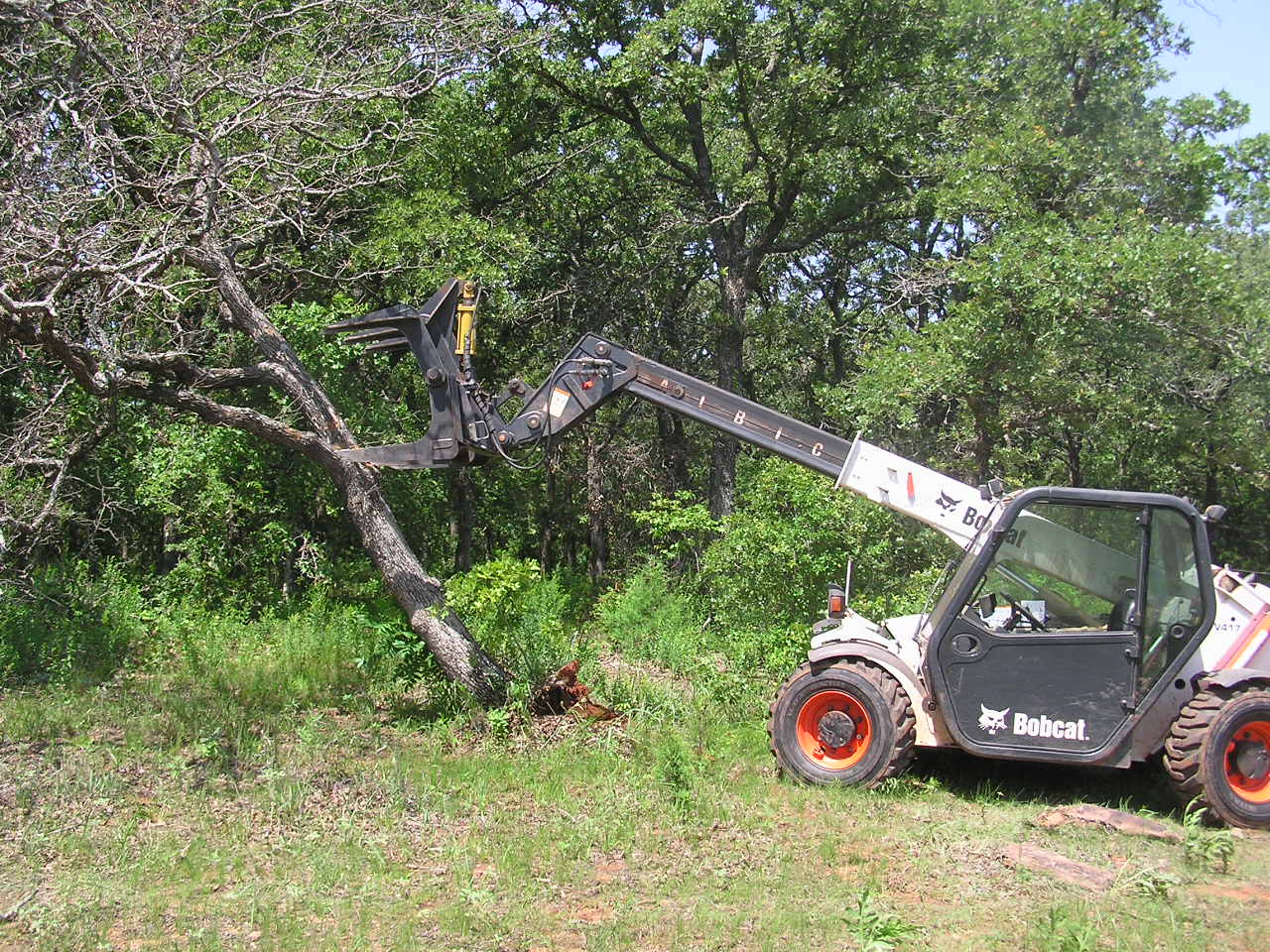

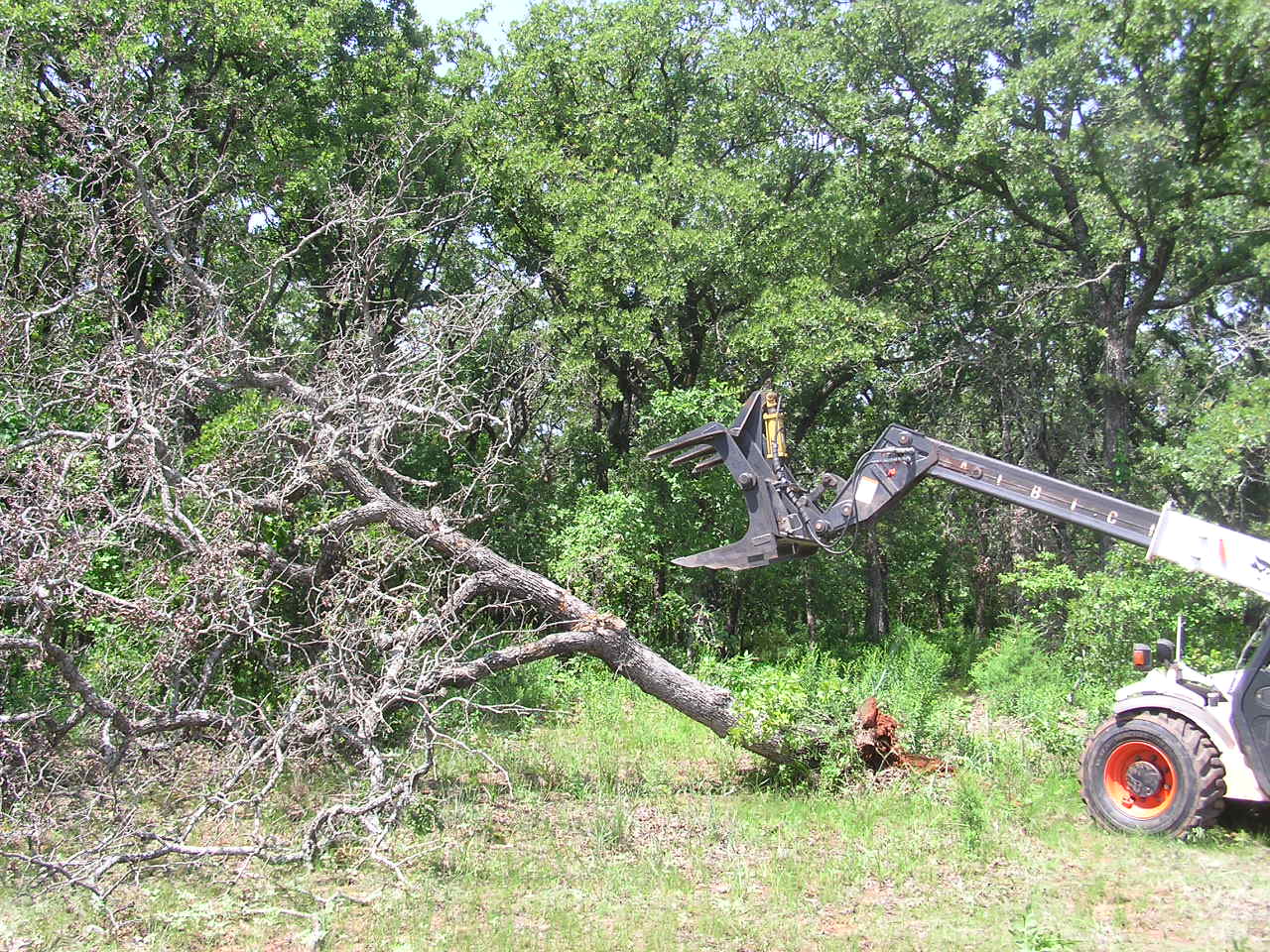

I had to try pushing some trees out since Piston showed us some pics of him doing it. I tried a few oaks this evening. It took some work since I could not go all the way around the tree with the grapple.

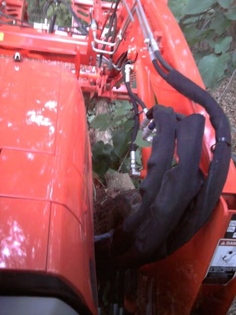

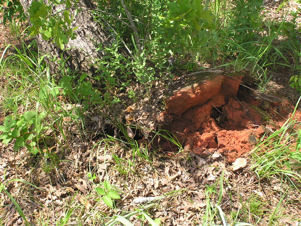

Here is what I started with

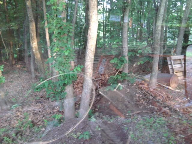

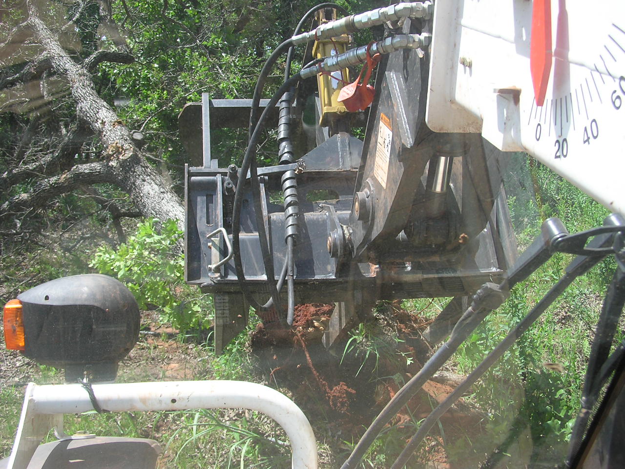

I dug around the trees as much as I could with the grapple to try to loosen them up. All the trees were alive.

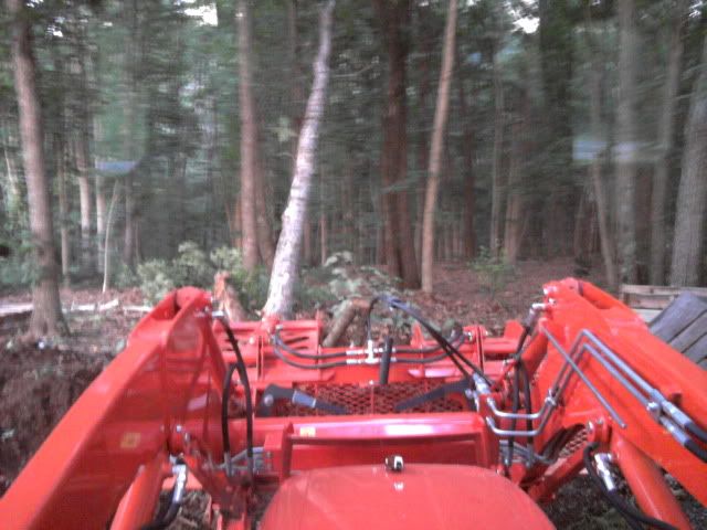

A little technique I picked upon at the end was to use a tooth to push against the tree so the grapple does not slide up the trees.
After that I pushed up high on them.
And of dug around them more with the grapple.

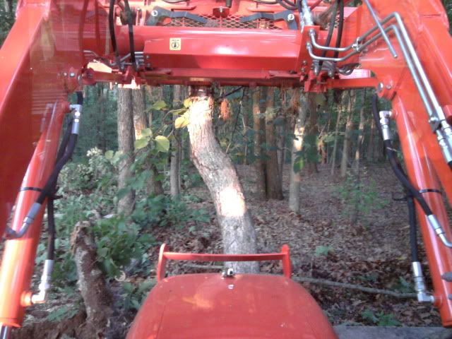

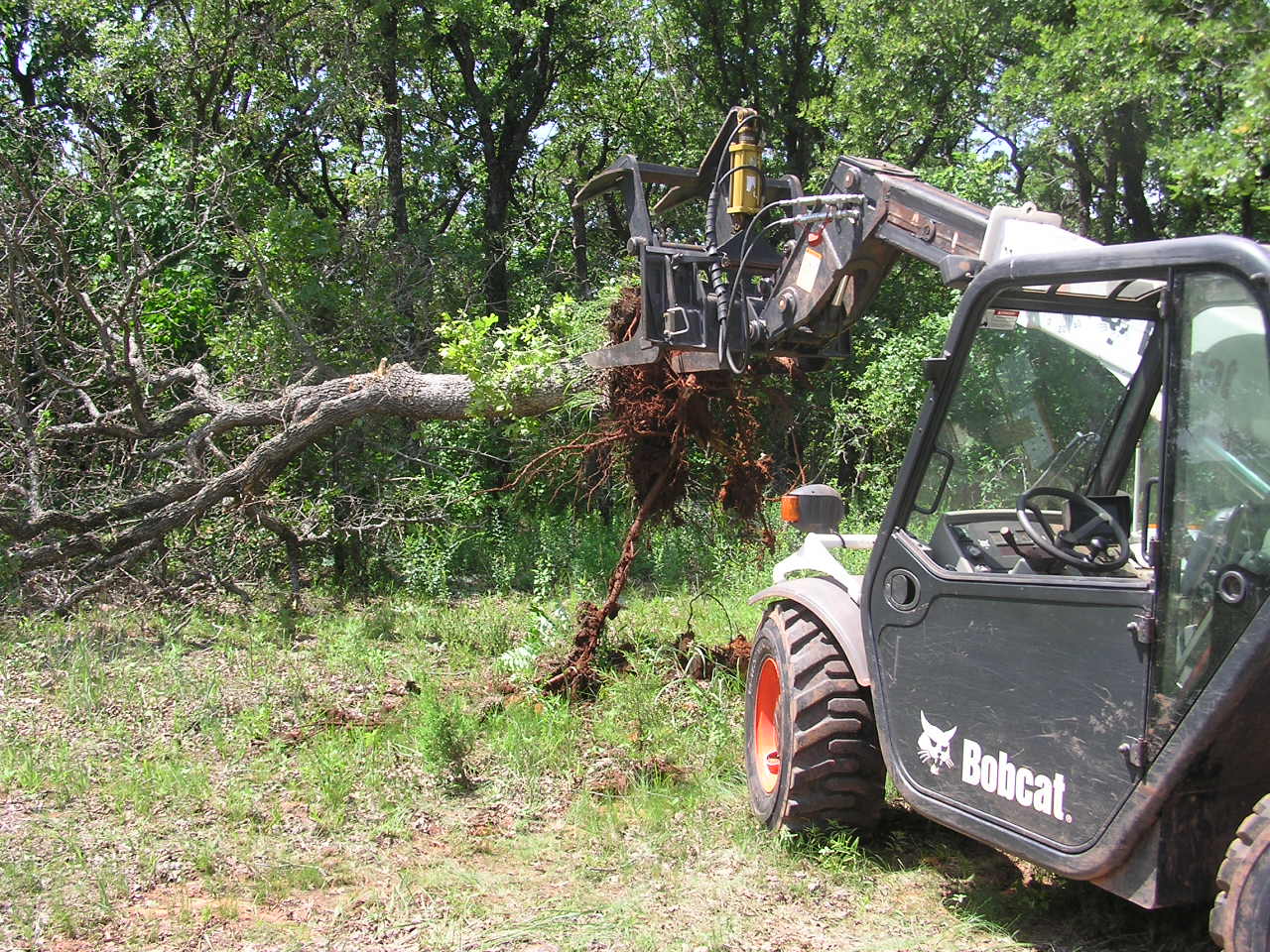

I found that since the trees were not dead they were very flexible and if I pushed real high on the they would bend a lot. It helped to loosen them up. I ended up getting them all out by pushing lower on them, like 3'-4' high.

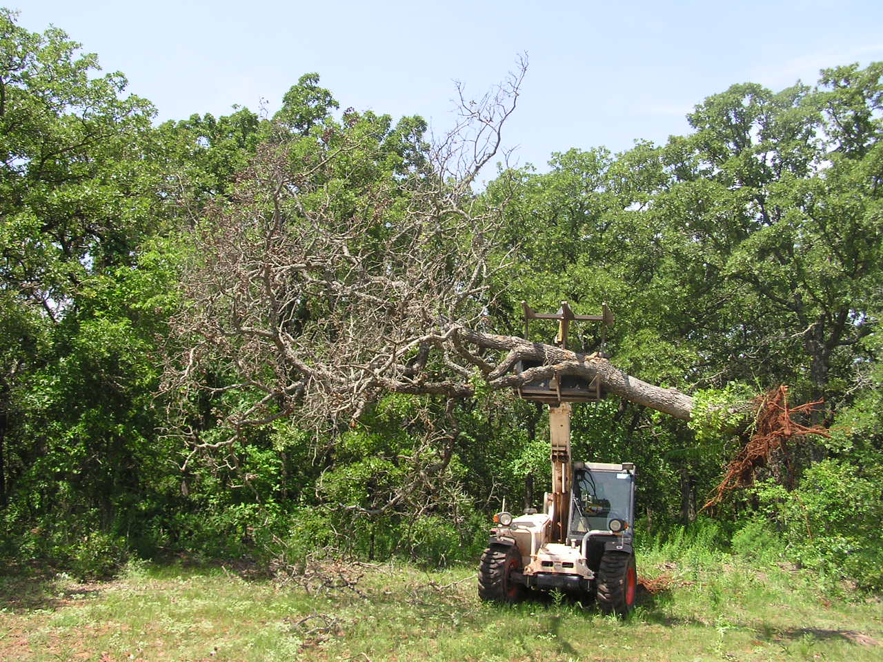

Here is pic of the one going over.

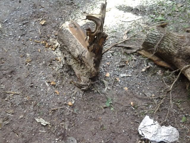

2 of the trees came completely out and 2 of them the stump busted so I have some clean up for tomorrow.
I sawed the one off after it was pretty much over. I had the whole tree in the grapple, it was not a real big tree.

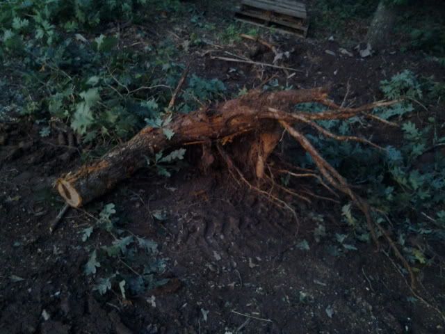

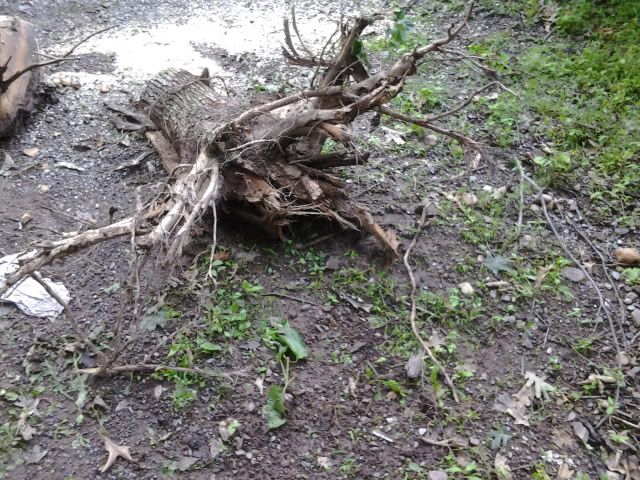

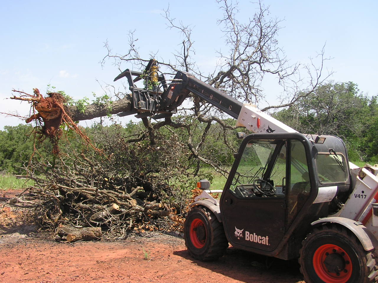

Here is a root ball from one of the trees
I have to split and stack the wood, load the brush and then I will get those last pieces of the stumps out. It got dark so I did not get any pictures of what it looks like now.

Also, I'm glad you (and Don) mentioned the teeth. I meant to say something about that in my original post. I've pushed a lot of trees over with my full sized loader/backhoe as well, using the loader bucket with NO teeth on it, I've had the bucket slip/shift on me many times, and I notice that using the teeth on the grapple helps immensely with keeping a solid, fixed 'grip' vs having the smooth bucket slide around. Not that it doesn't work well with the bucket itself, but it's just not as "grippy". (that's a technical term)

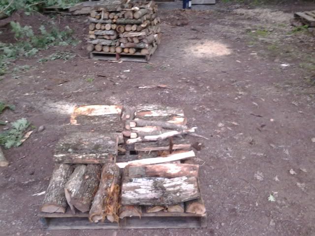

I got 1 full skid of wood and one partial. I have a about a wheel barrow load that needs to be put on the skid.

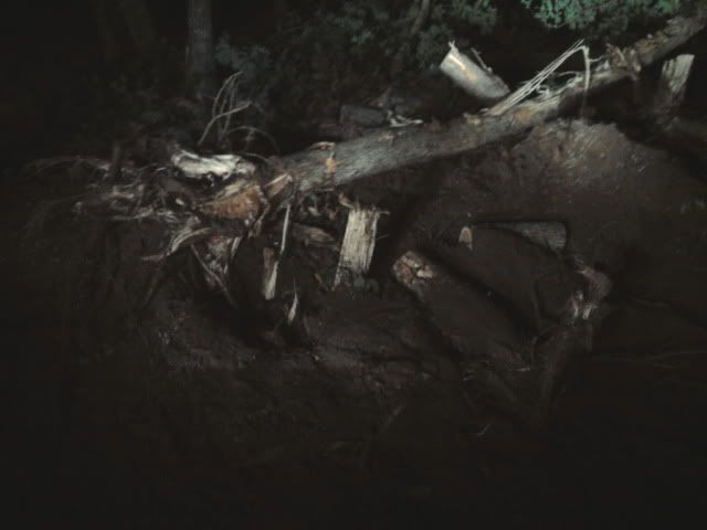

Here are some better pictures of the stumps.
The 4th stump just kept breaking off. I think it will be okay. I hooked onto the one stump with a chain and pulled it out. I had enough traction that the front wheels came off the ground:D
I was able to clean all the brush up in 2 loads with the grapple. I got the area roughly graded, it is nice and muddy.

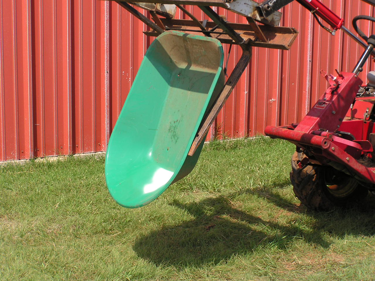

Speaking of giving people ideas, you can borrow my wheel-less barrow to move the rest of the wood! :D

I like the palletized firewood idea. That makes it nice and easy to move around, and handle it so many less times :thumbsup:
Thanks. Where ever I cut the tree down I cut it into firewood length, split it and palatalize there. It also helps it dry since it is not on the ground. I have some strips of a old conveyor belt that I cover a few pallets with. I think I have about 40-50 pallets of firewood now. 1 pallet is approximately 1/4 of a cord. The little BX will lift one on the 3PH. I pull up to the house and carry it in the basement. I am afraid to put the whole pallet in, I don't want any critters in the house:laughing:

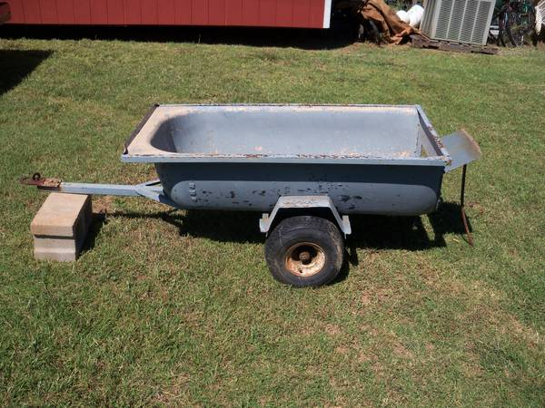

Thanks, I'll pick it up tomorrow. You need a bath tub trailer to go with that.
Okay, just filled it with diesel, it is good to go! Been there, done that, with the bath tub trailer! 😆
