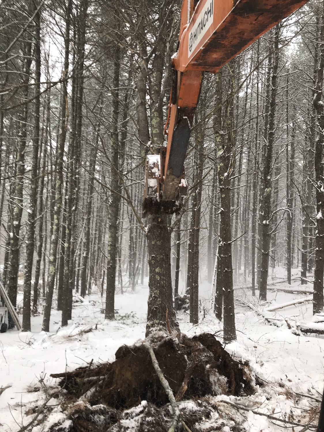

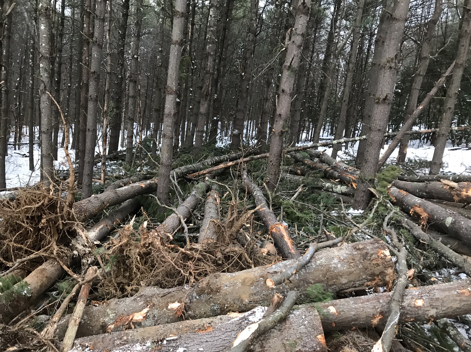

If knocking down trees was addictive...you're like hooked on crack!!! (he says respectfully!)
Most measure tree knock-down diameter in inches...you can measure them in feet...
You took it to a whole new level!
Nicely done - I seldom have equipment envy, but you did it right!!!
