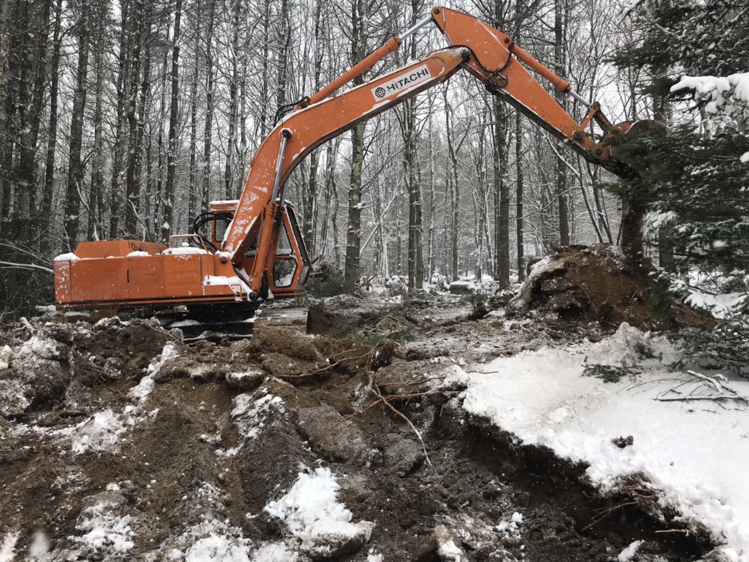

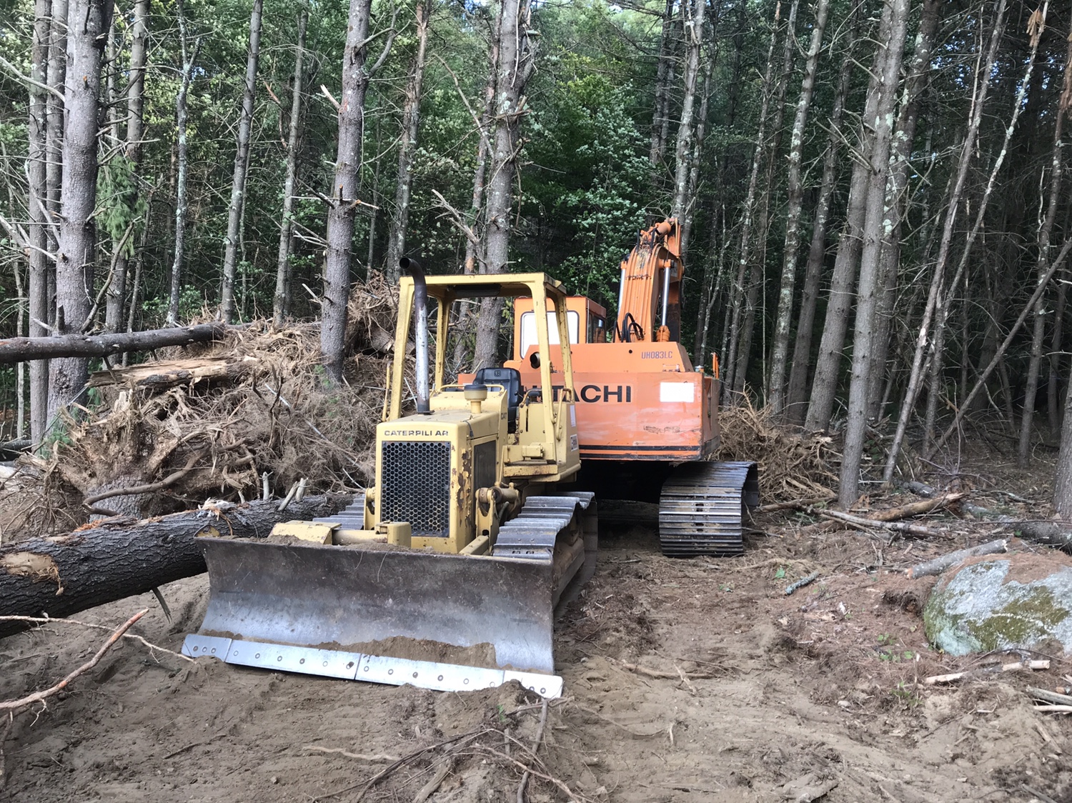

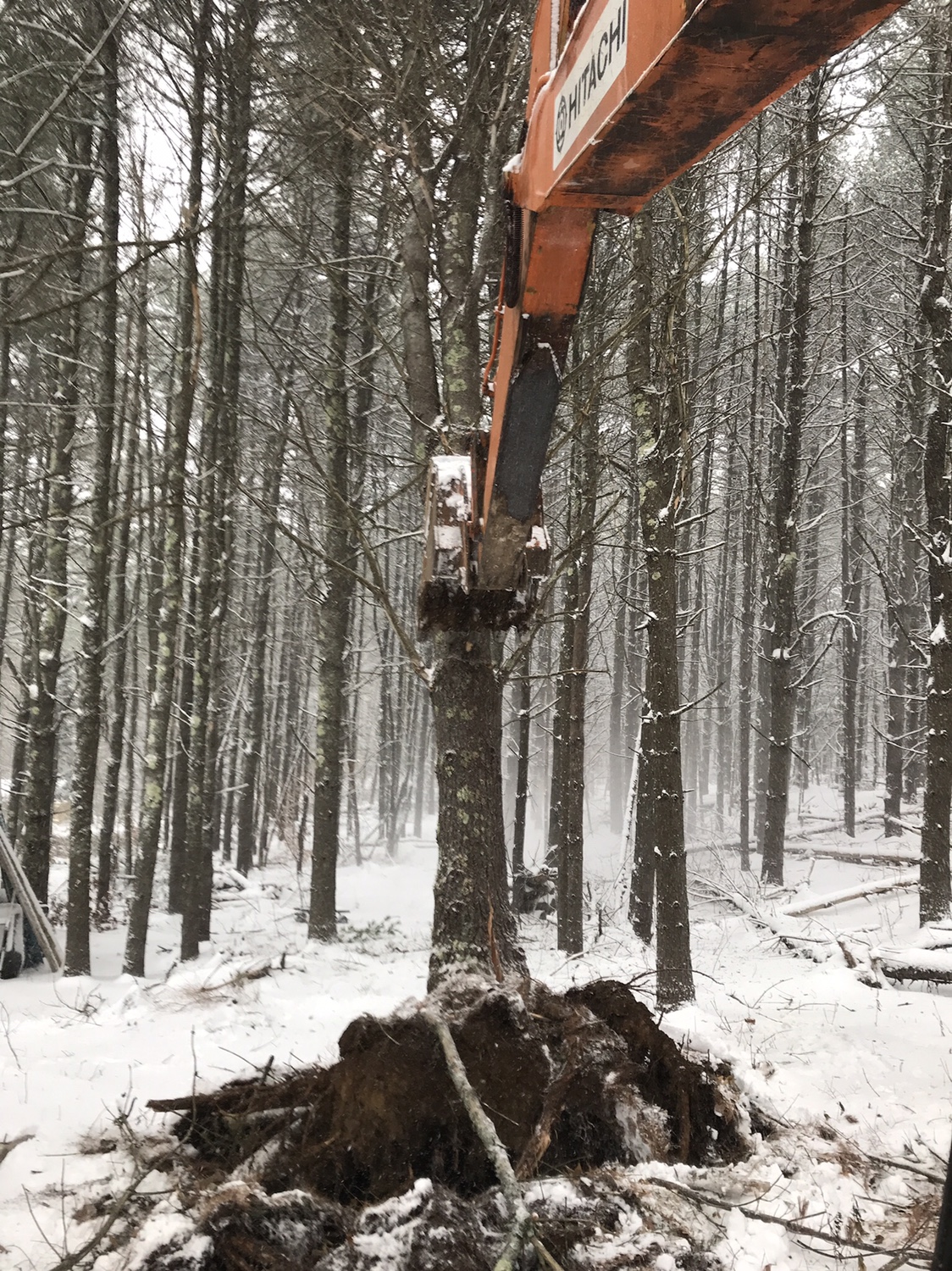

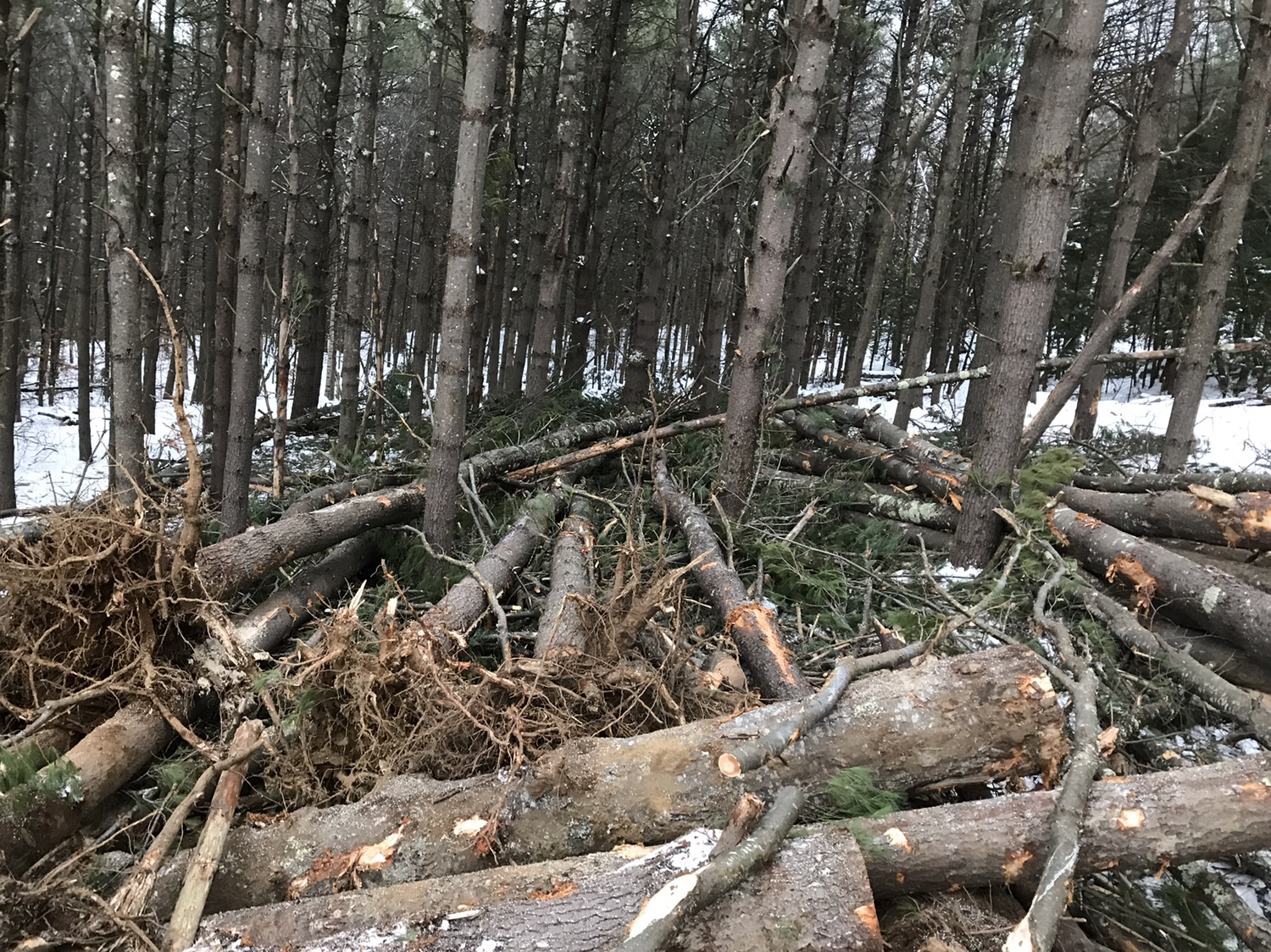

   / What's your technique for removing trees/brush with your grapple? Here's mine.... #63
If knocking down trees was addictive...you're like hooked on crack!!! (he says respectfully!)
Most measure tree knock-down diameter in inches...you can measure them in feet...
You took it to a whole new level!
Nicely done - I seldom have equipment envy, but you did it right!!!

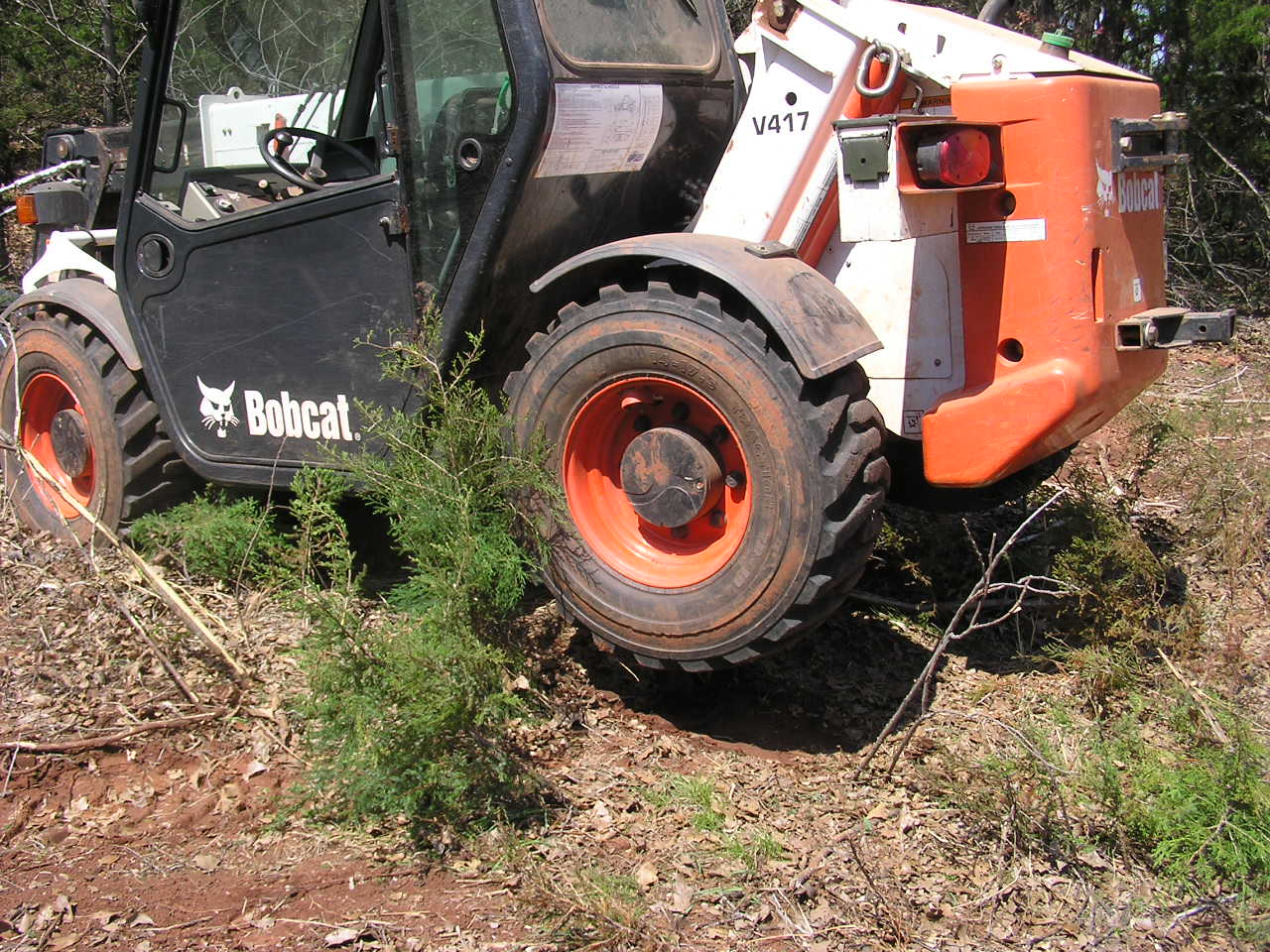

This old cedar tree stump measured 10 inches across:
Grappled it with the center tines of the Gorilla Grapple:
Raised the boom and the rear wheels came off of the ground:
Retracted the boom, drove forward, raised the boom and the stump came up:
