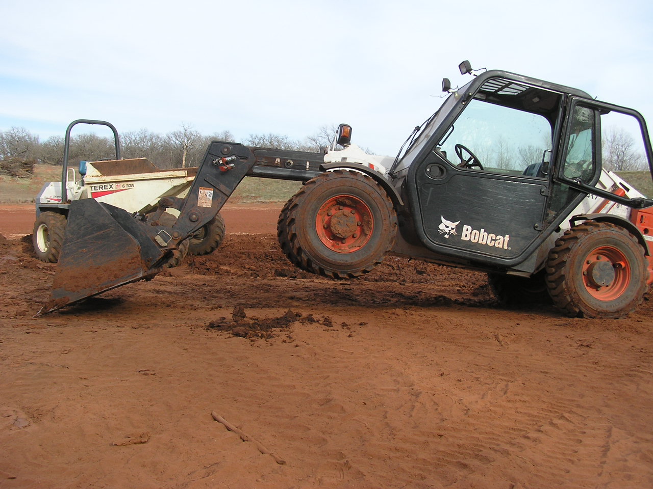

How far below grade will the telehandler dig with a bucket?
Probably as deep as necessary: http://www.tractorbynet.com/forums/...pact-telehandler-post3525578.html#post3525578

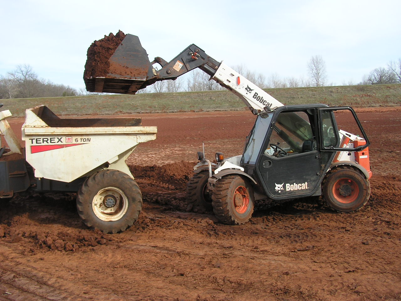

You can curl down and raise the front tires, then extend the boom to fill the bucket.
This bucket is 6' wide, holds 1 cubic yard.
433046-whats-your-technique-removing-trees-p3200016-jpg
Notice that the rear tires are off of the ground. :eek:

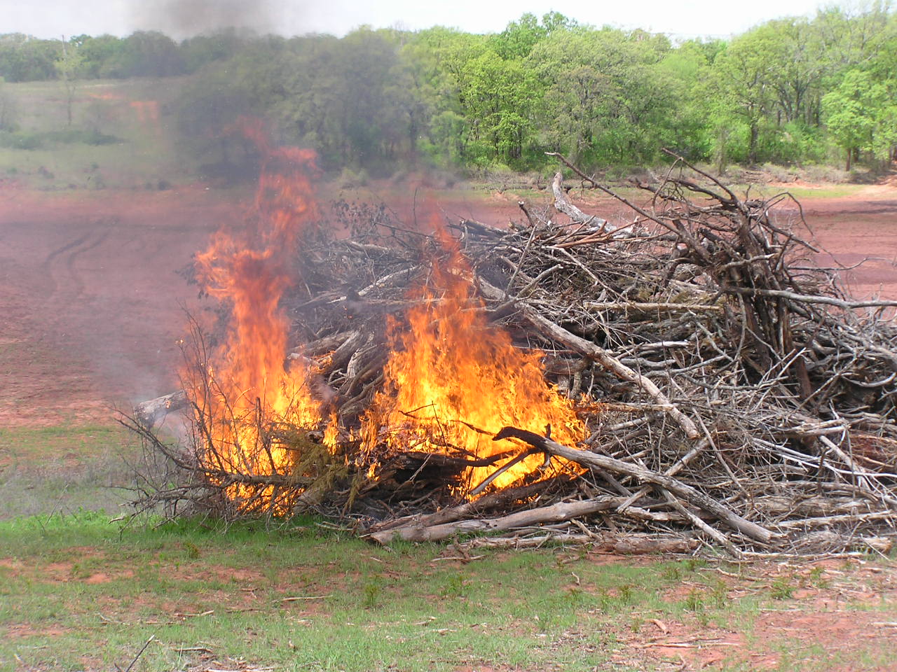

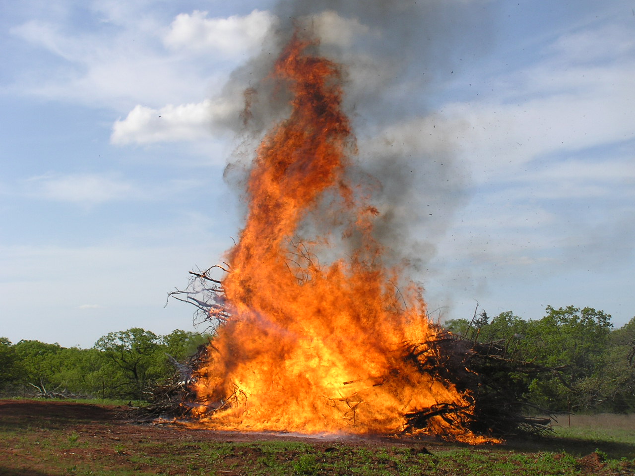

Now for the marshmallows!

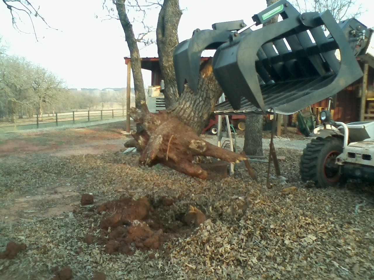

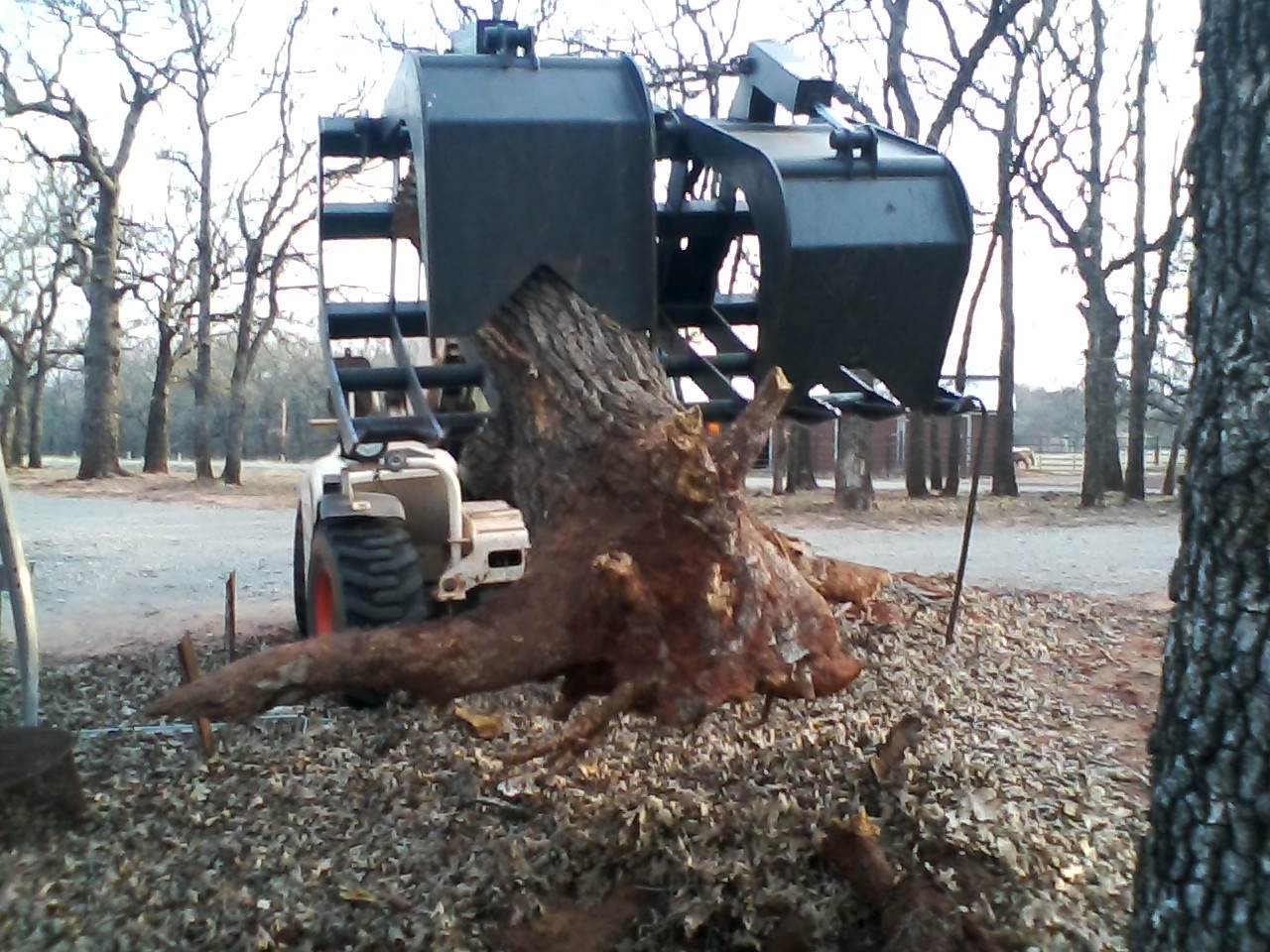

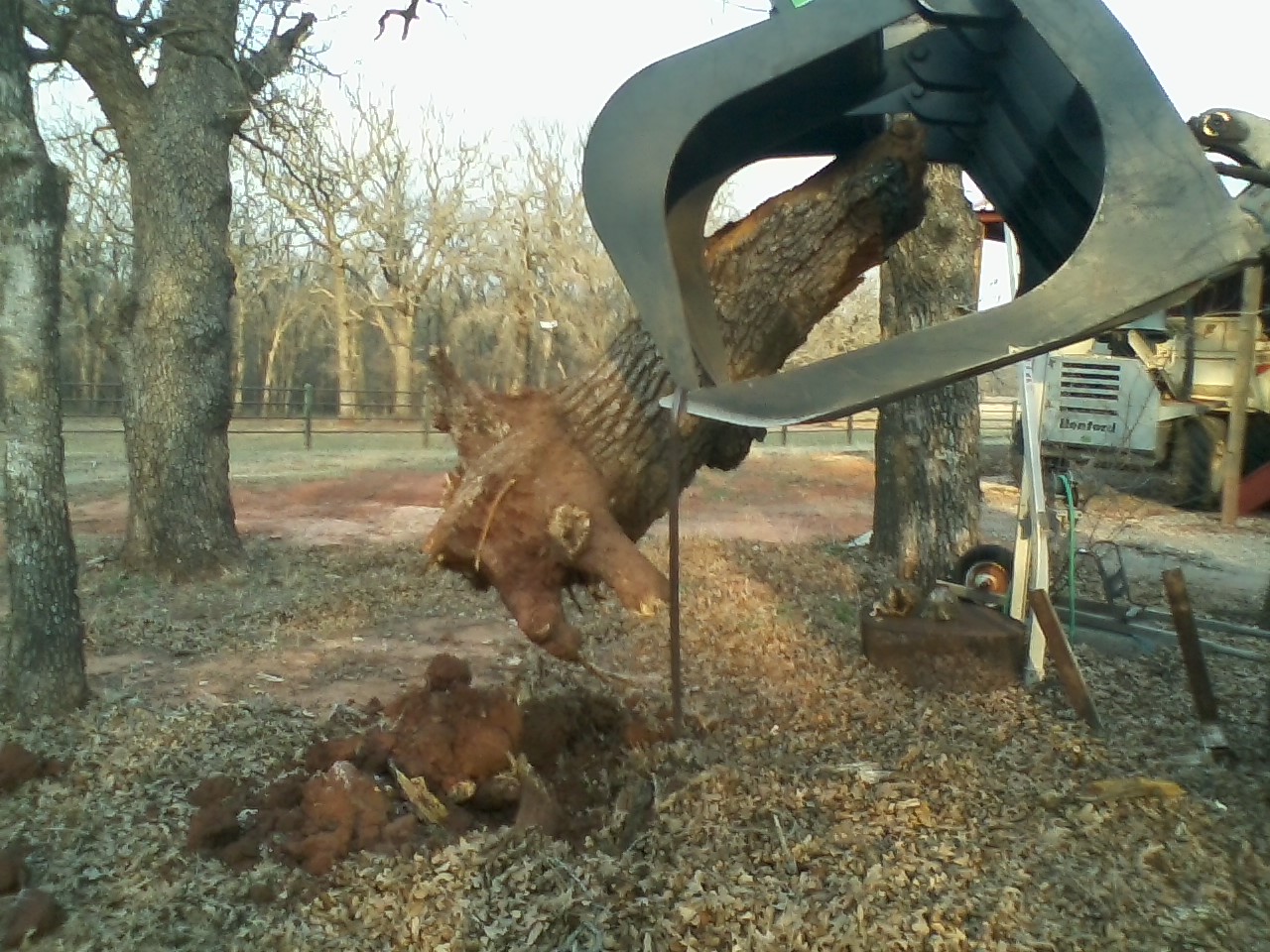

Thread bump for newbies and those that have not seen it.

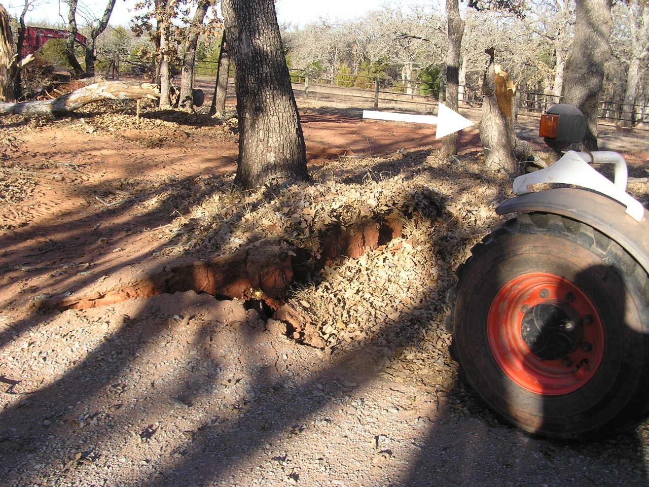

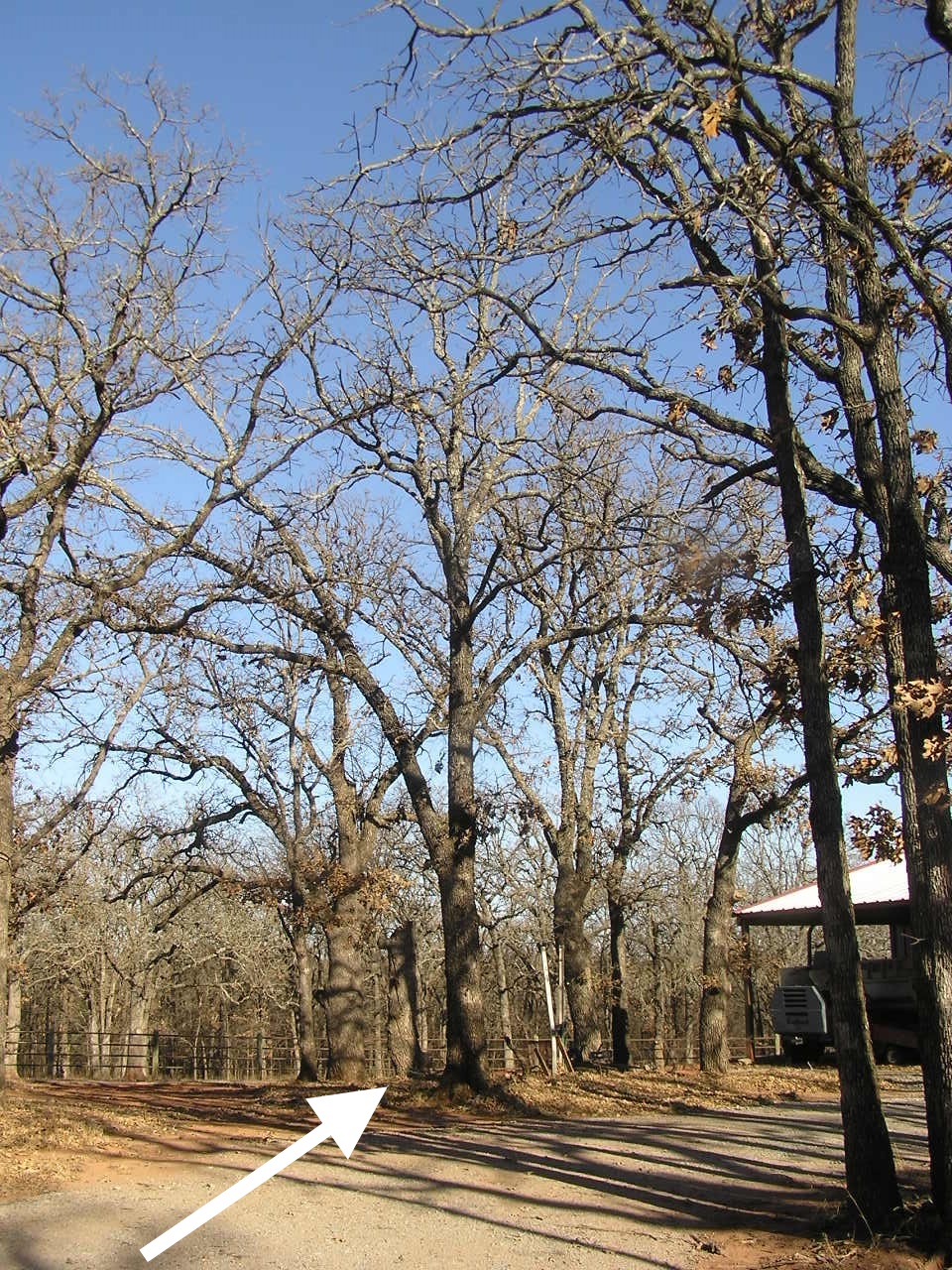

Had a dead tree break off high on the trunk on a windy day.
Tried to push it over last December when I took out the tree next to it and the trunk broke a little lower.
Let it set and rot until last Tuesday, pushed on the side where this arrow is and some roots broke.
Drove around to the other side and pulled it out with the grapple. :thumbsup:
Note the pry bar hanging on the left side of the grapple, used it to get the dirt off of the root ball.

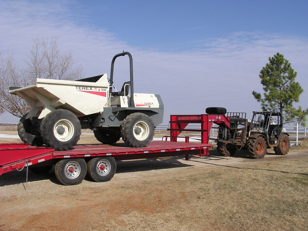

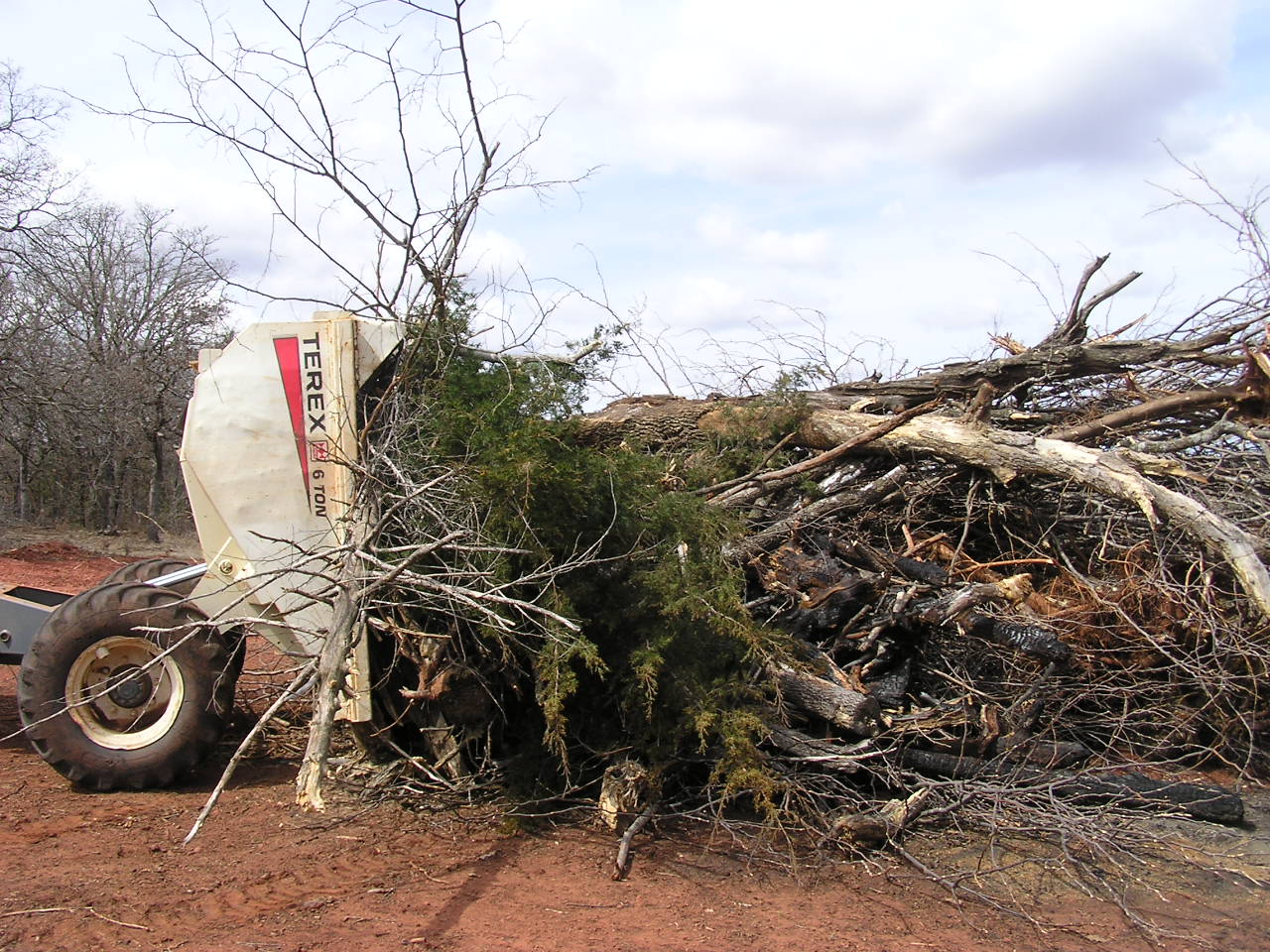

Yep, bought the Dumper 7 years ago to use with the V518 removing silt from the pond where we lived back then.
I call it my 4WD Wheelbarrow. :D Still use it here where we live now.
This is the day we got it. It was delivered on a semi truck flatbed trailer. I used the V518 and pushed the red "portable loading dock" close to the back of his trailer and he backed it onto mine. I moved it from the side of the road into our driveway, lowered the ramps and drove it off.
Holds 4.5 cubic yards

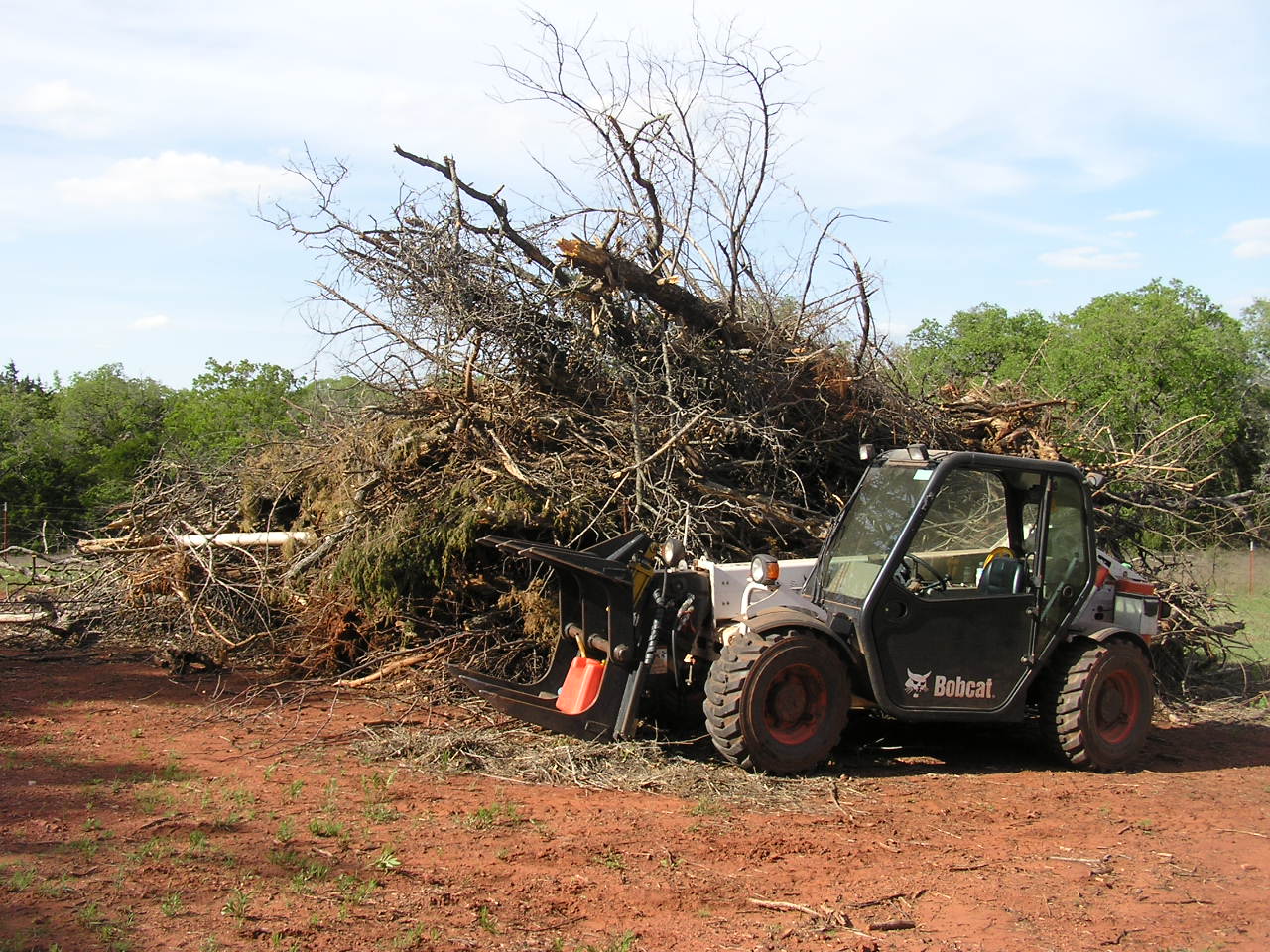

And a lot of brush
