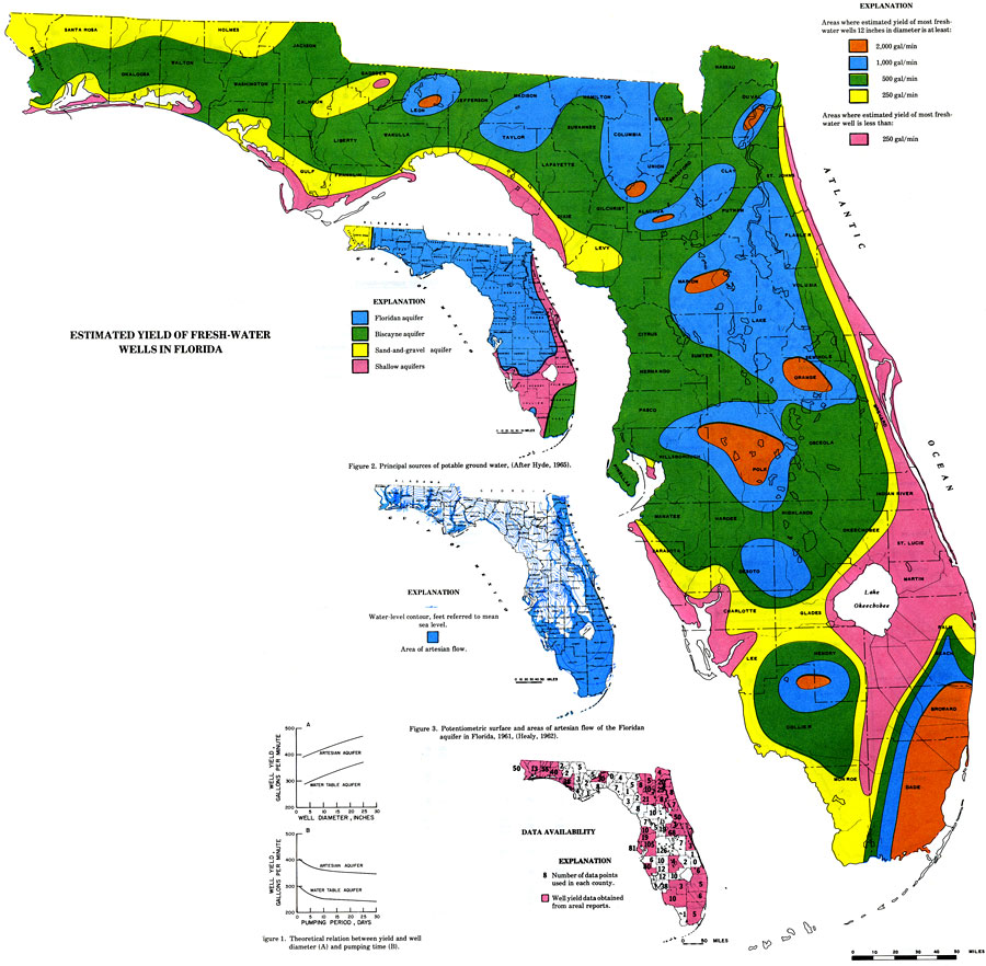

Taller trees of the same species in one place or another on the same property could indicate a water source, or could indicate better nutrients in the soil and have nothing to do with available water.
I'd consult your local county extension agent before talking to well drillers and see what they tell you as far as available water in the area, well depths, volumes, etc....
For fun, here's a map I found of FL that indicates water flow averages from 12" wells. Here's a link to where I got the map, and there's more info on that page. Good luck in your search. ;)
Estimated Yield of Fresh-Water Wells, 1975
