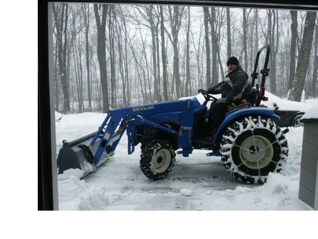

   / When is rear ballast needed with a FEL? #52
Mosey,
If the NH7308 Loader weighs 800lbs & the Bush Hog weighs 1500lbs, from your picture it looks like you are carrying most of the extra 700lbs in front of your front axle. Also, this may be an optical illusion but the rear & mid pivots of the 7308 looks to be further back.
Finally, my rear tires are loaded with ballast (so am I) and I've never lifted my rears off the ground or even felt close to the limit even while exceeding the limit of my loader. How do I when I exceed the limit...thet's when the loader won't lift of the ground. /forums/images/graemlins/blush.gif
