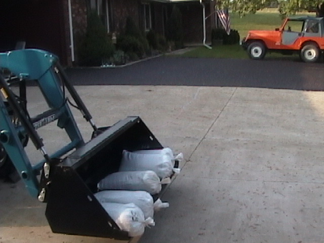

Well, I did a more precise test. I put 5 sandbags (which I made up myself and weighed) that weigh 55 lbs each, for a total of 275 lbs. Then, I stood in the bucket and I weigh 180 lbs, so the total weight in the bucket was 455 lbs. The bucket was only raised slightly. I was able to bounce the rear tires off the ground. There was no one on the tractor seat and I did this in 2 places, on a slight slope and on a level floor in the garage.
Picture 1 attached, shows the sandbags.

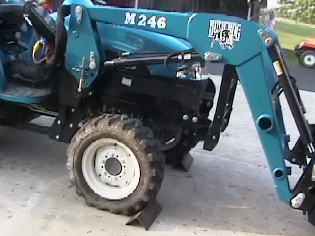

Here's a picture of the front tire squatting. It has 30 psi in it.

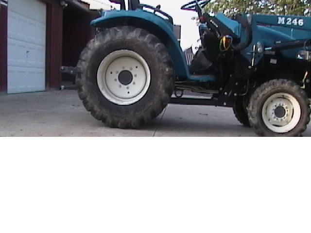

Side view of rear tire, barely off the ground (hard to see in this picture).

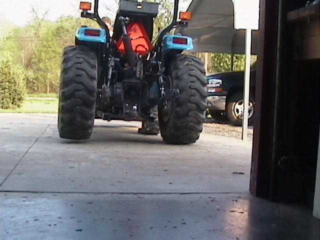

I realize ballast is needed. But, I'm just thinking that I should be able to move 275 lbs without it. Instead, the tractor felt very light in the rear end when I drove it with 275 lbs in the bucket. Also, I could not turn the wheels, even though I have power steering, unless the tractor was moving. This just doesn't seem right to me.
I've talked to the dealer and he called his Bush Hog rep. He was told "we do not have a return policy". I called the rep myself and got nowhere. He said no one has ever tried to return one before. I pointed out the this loader weighs nearly twice as much as the NH one and the Woods one, but he just said he's never had anyone complain about that before. He referred me to a guy at Bush Hog in TN. So, I'll try to get somewhere with him tomorrow. At this point I'm willing to take a loss of a few hundred dollars, I just want this thing off my tractor!
