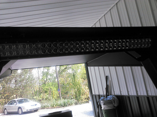

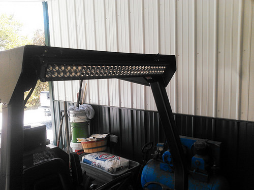

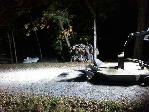

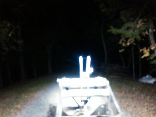

Had an opportunity to test how well the newly-added 28 inch, 180w lightbar with 40 Cree LEDs would illuminate the work area. I think this will suffice... :)
In fact, I find the reflection off the lift arms a bit distracting, but the floods do a good job of lighting up the work area. I may want to adjust it up a bit, so the spot lights on each end shine out a bit further. That's a bit of a PITA since it calls for loosening and retightening 8 allen-head bolts (4 on each bracket). This lightbar is sturdy, with an all aluminum body. I think it should stand up to the occasional encounter with brush, etc.

Yeah, the bright white light is kinda harsh on the reflection on mine as well. But man, you can really see with them.

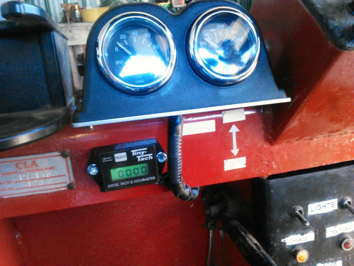

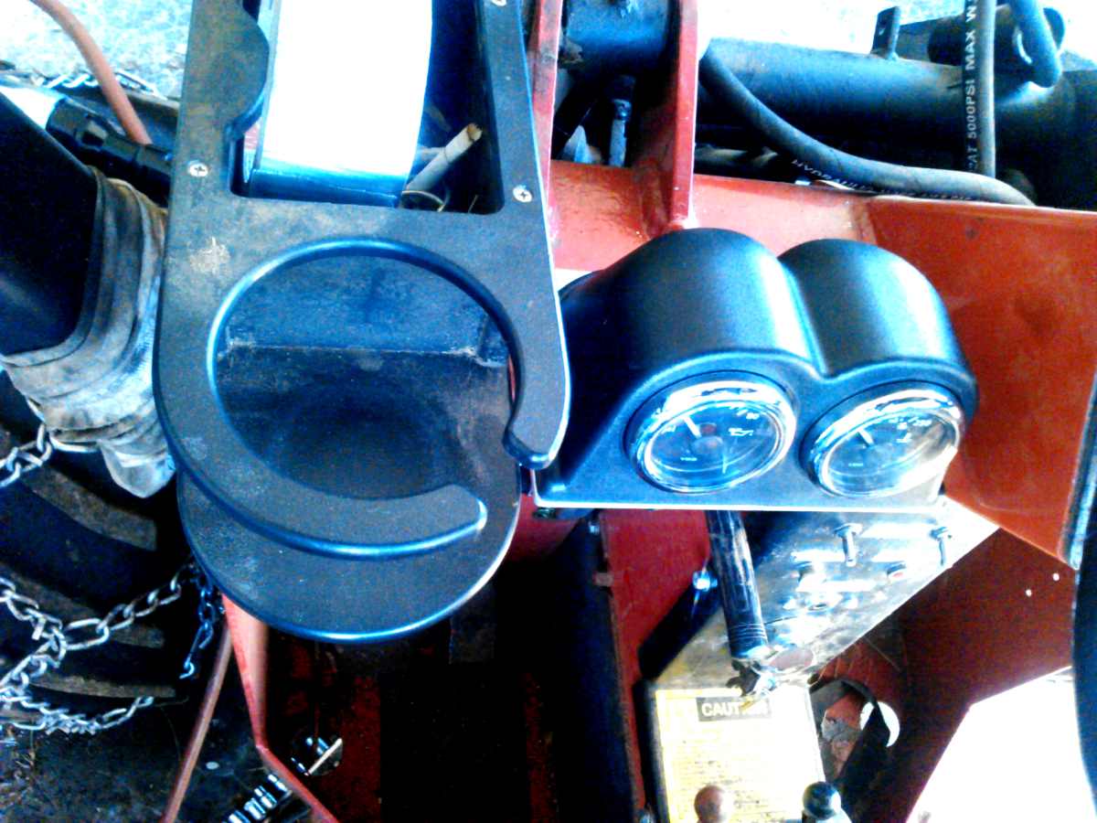

My old 1430 came with NO gauges, only idiot lights for the alternator and oil pressure -- not even a fuel gauge. With the rough-cut mowing I've done this fall, I've had overheating issues this fall. Found my radiator was completely blocked with buildup behind the oil cooler, though I'd been diligent about blowing it out as best I can with compressed air. Long story short, I developed pin hole leaks where the tubing enters the top tank. After two attempts at getting that soldered at a radiator shop, I finally yanked the radiator and am having the core replaced. When I reinstall it, I'm going to cover it with window screen wire to try to keep debris out.
Meanwhile, I wanted to add a water temp gauge so I can monitor temps especially when mowing. So, I added a matching VDO Viewline marine water temp gauge and oil pressure gauge. These are waterproof, and hopefully rugged enough to stand up to the environment on a tractor. I mounted them om a plasitc pod on an aluminum plate mounted to top of the dash. They stick out over the edge of the dash panel, but are essentially flush with the steering column and the cup holder I added earlier.
Also added a Tiny Tach diesel tach/hourmeter underneath them. This Kubota engine doesn't have the mechanical tach drive, and electronic tachs for diesels can be quite expensive. This was the most affordable one I could find -- monitoring RPM by sensing pulses in a fuel injector line. It will also be handy to have an hourmeter up front, instead of just the one in the engine compartment.

Carl recommended those tachs and I have been reasonably happy with mine.

Kent is the Tachometer pretty accurate? Would like to put one on my 422.
   / When one door closes, another opens....
#75
No real way to tell how accurate it is, since there are no true electronic signals on a diesel such as spark in a spark plug wire. Some alternators have a signal that can be converted to RPM, often with an external adjustment "box," and calibration is always required.
That said, I've used a Tiny Tach on a garden tractor before and was satisfied with it... the readout can be "jittery" for a couple seconds after you change the throttle, but then it stabilizes. My biggest complaint is that they use a sealed-in battery to maintain the hours accumulated, so they only last 5-7 years or so.
   / When one door closes, another opens.... #76
The newer ones have memory that does not require a battery to maintain so they run off of your tractor's electrical system. Yes, my older internal battery one only lasted 3 or 4 years.
