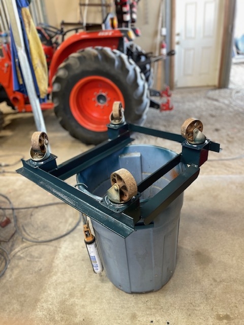

Did you weld the pallet sleeves on, or were they already part of the tank?
   / Where did you get your diesel tank? #12
I did weld 2 pieces of 6" channel on the bottom of the tank for the forklift. Once at home I put it on a low dolly that securely cradles the tank so I can push it around where needed in the barn.
   / Where did you get your diesel tank? #13
