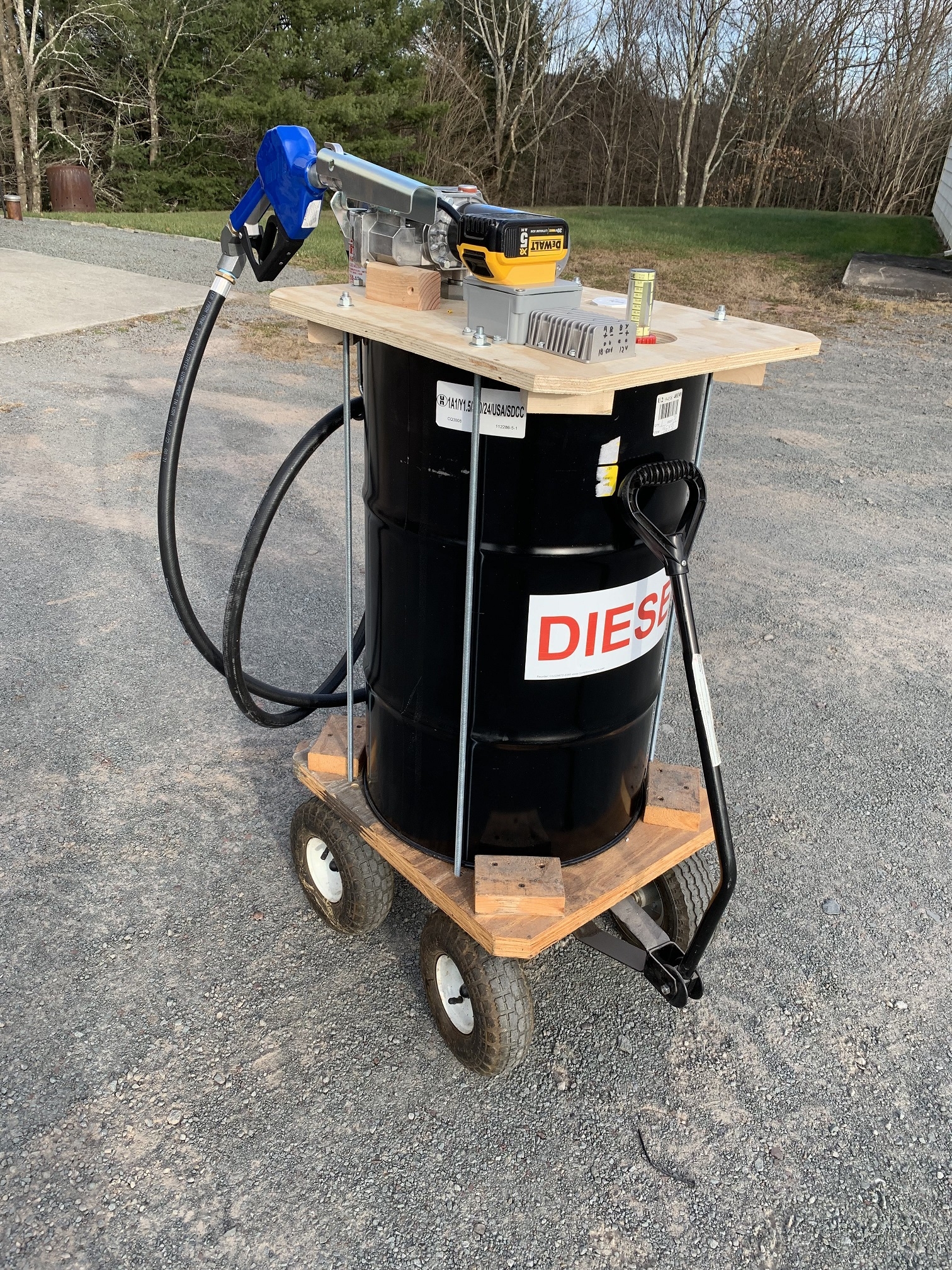

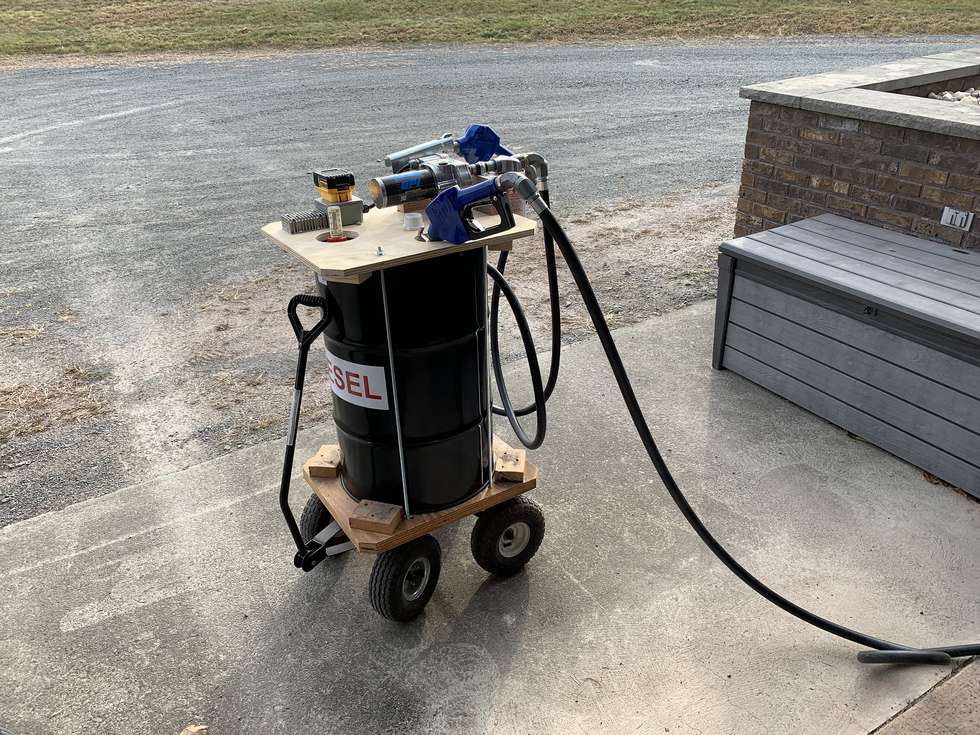

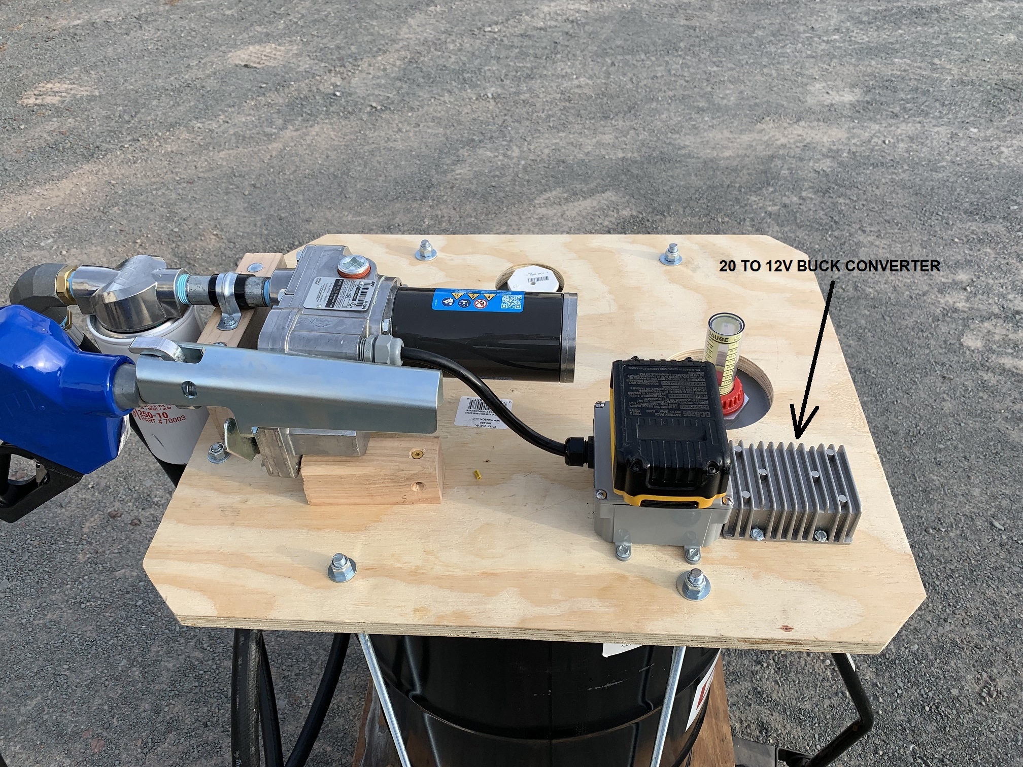

I use a 30 gal paint thinner drum. I put it on a cart and added a transfer pump which is powered by a cordless tool battery:

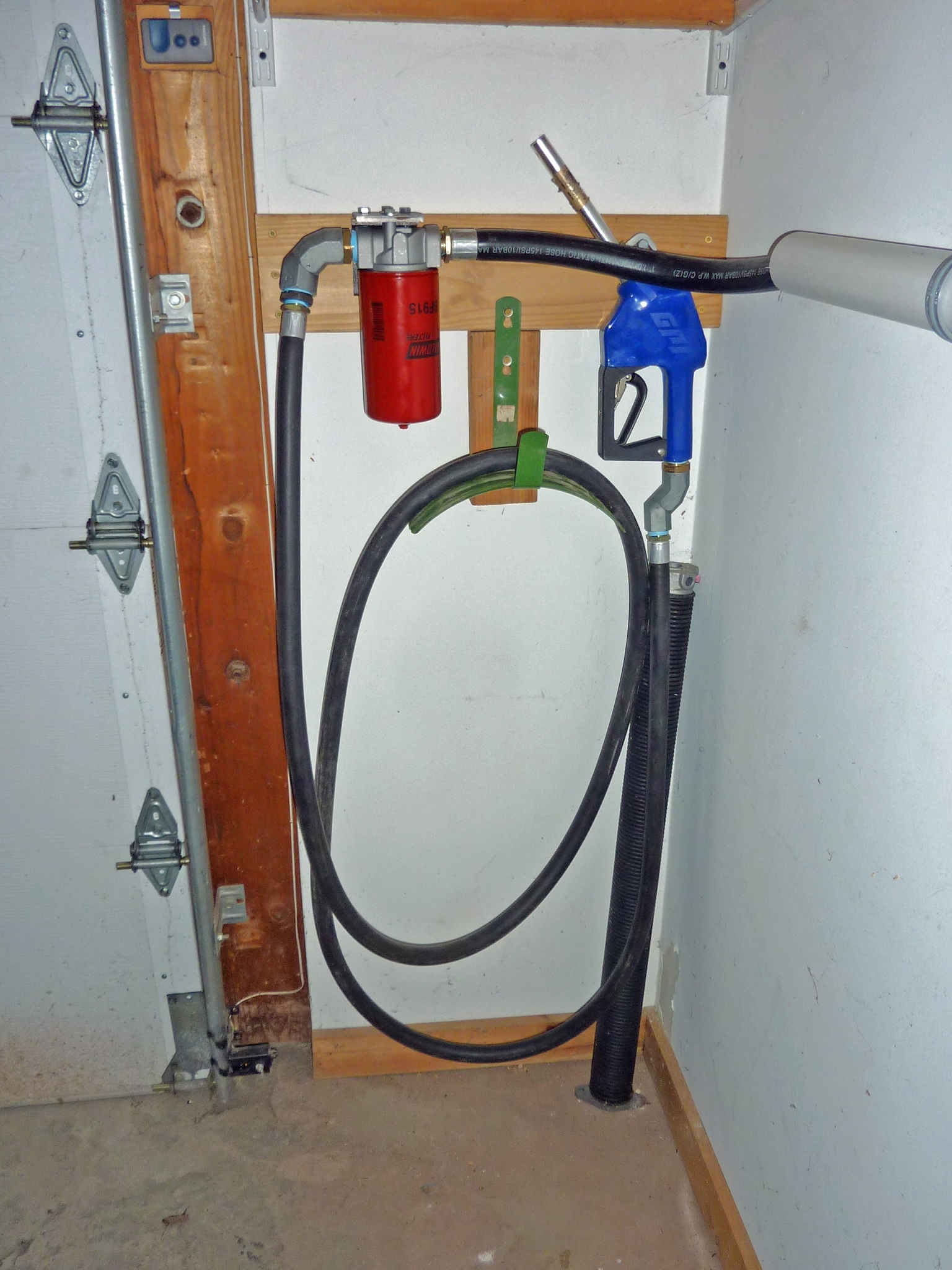

I refill it from the 1000 gal fuel oil storage tank at the house:
It rolls around easily over rough ground to get fuel where I need it.
