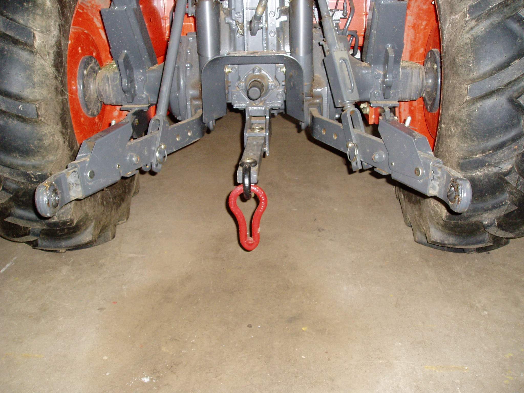

When I pull a chain from the drawbar, I use a shackle & grab link:
This makes hooking up to the chain quick & adjustable.

You put that on the draw bar and put chain through it?
I'd sure do that ... before I put a chain around a trailer hitch ball ... ;)
Have a look at the rating on those shackles at say, TSC's website ... they're pretty rugged and designed to withstand quite a bit of force.

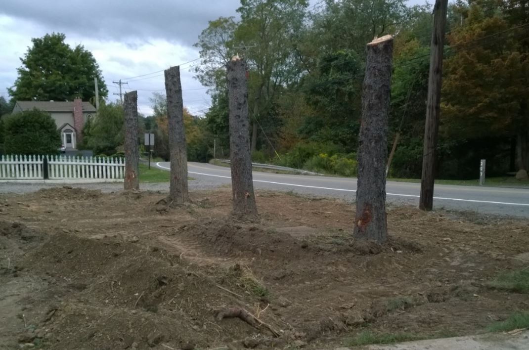

If I dig the roots somewhat out and pull high on the 12' foot tree still attached to the stump, they will come out fairly easy. Sometimes it takes a little yank, but they go. Pine trees have a very shallow root system. I don't see the catapult effect happening unless maybe the whole tree is still there, then I would say yes. There is just not enough weight left on the stump to have any bearing. Now the cable breaking...I could see that happening. I've pushed trees over with the FEL already, but I would rather pull instead of push. Again, I'm digging some of the roots out first depending on the tree size. My main concern is a good place to connect a cable to on the tractor itself while the BH is still attached.
Here is a picture of some of the trees I'm talking about. These, I pushed over with the FEL.
