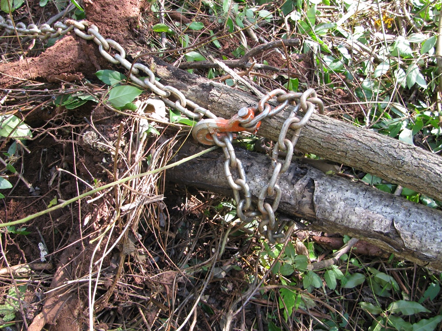

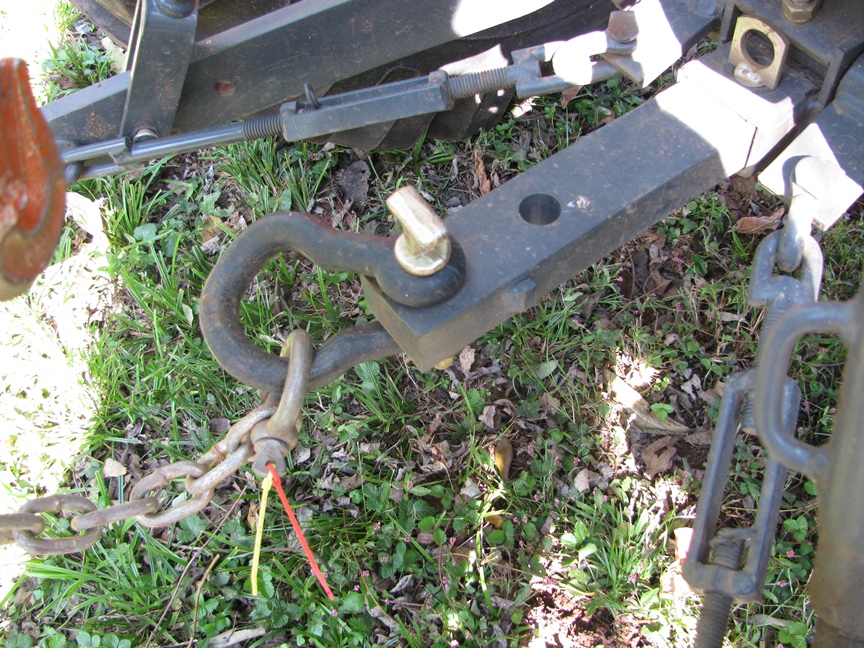

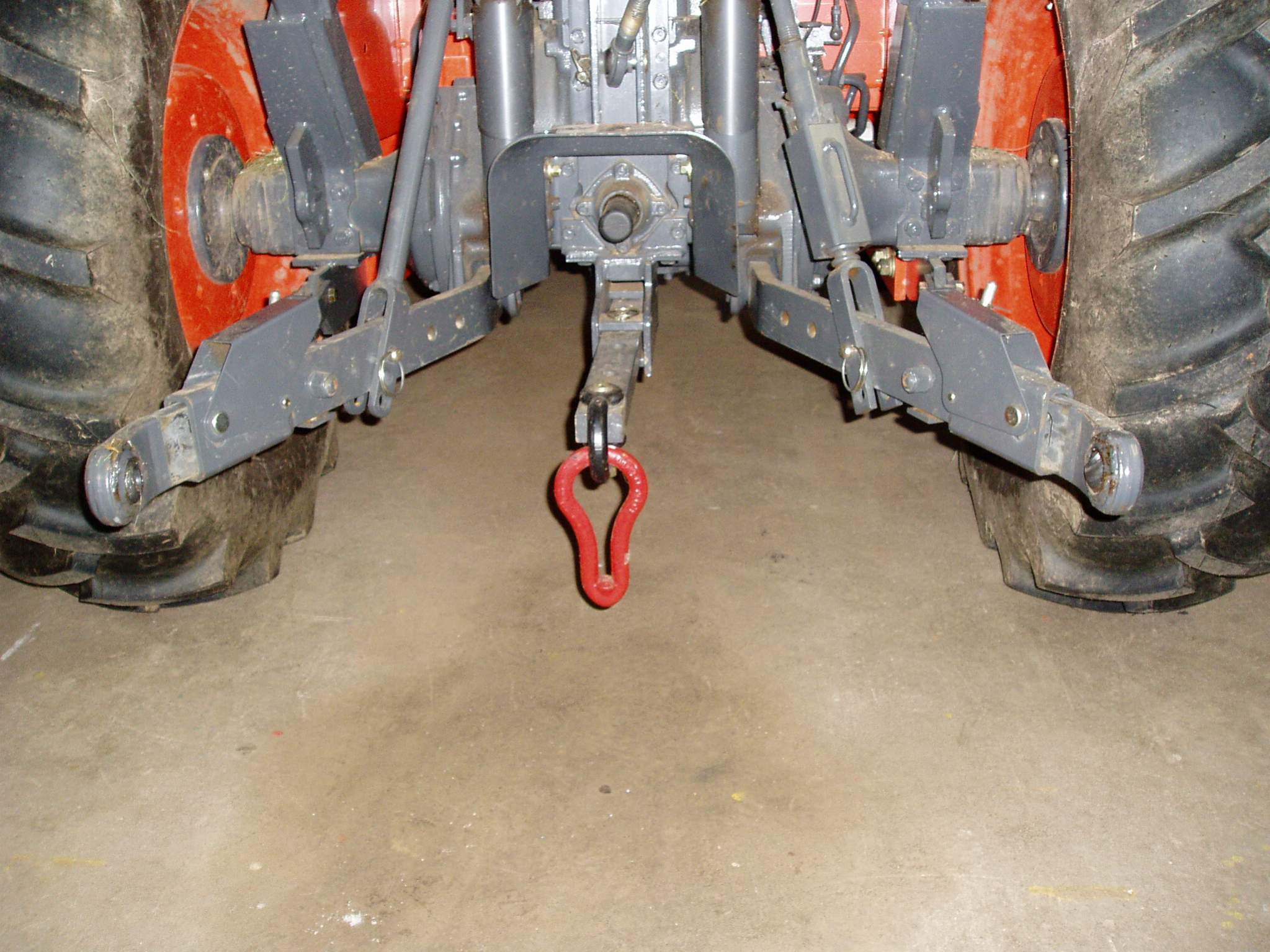

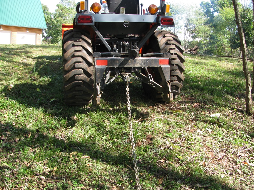

Here's how I do it. I just push the trees over with the tooth bar on the loader bucket, then drag them out where I can cut them up.

   / Where do you hook your chain for pulling trees? #54
This is a bush, not a stump, but it illustrates the idea.
Bruce

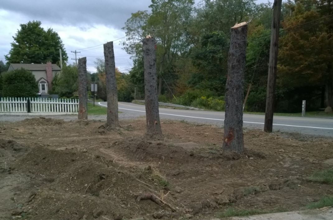

Here's pictures of 60' + pine trees, probably 12" diameter and their good size root balls that I pulled over with a cable. Place cable as high as I would dare to go up on ladder (~16' or so).
