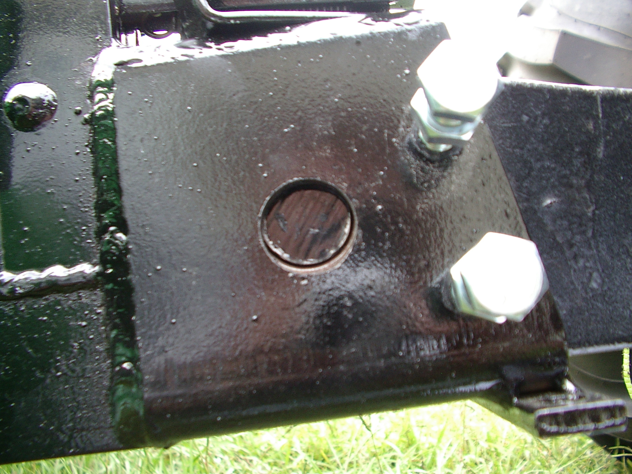

I have always been the type of person to do my own projects due to the fact that I can't seem to find people who care about the quality of their work as I do. Many years ago I needed a customized trailer to haul ladders, equipment and vinyl siding materials. The prices that shops wanted to build to my specs were outrageous! I bought a flat bed trailer, a welder and some steel and that was it. I got what I wanted for a great price, a welder and learned how to weld on my own. I never hired anything done after that if there was any possibility of me doing it. I have thanks to the Lord become a successful businessman and have a remodeling company that has the contract for a major grocery chain and a Palm tree nursery / farm here in Florida. Like many of you, I had become very irritated with installing implements on my tractor. I looked at many "Quick Hitch" makes and decided to buy "Pats System". I purchased it from Agri-Supply (item#70078 $159.95). My time has become so valuable that this price is maybe 2 hours of my billing time. I coudn't build it that fast. I ordered it on 7-25 and it arrived 7-30 just as promised. (I thought this is a good thing). Then I opened the box and hadn't been so disappointed in many years. This product looks like it was built by first time blind laborers! Look at these pictures and you let me know what you think. The paint looks like it is from a spray can. There are several spots that there is NO PAINT, and do they know what primer is. Yes primer does make a major difference on steel. Weld spatter everywhere. The pin hole on one unit were so out of line the pin would not go through my arm. Yes I tried both sides, One fit both sides, the other fit neither.(Out with the Dremel) This is an extremely poor quality built product. I removed the spatter and runs and refinished it correctly after I had to straighten the arm hole alignment. What about grade 5 or 8 bolts. With the vibration and torque on these units I was not about to put that stress on the cheap grade bolts that came with Pats product.

I won't speak for the fit and finish, after all - it's not going on a show car. They lift implements out in the mud and the blood and the beer. At least mine do.
But it does appear that Agri-Supply screwed up and sent you a mixed set. Two of those photos suggest that you received one PEC for a Cat 1 lift arm, and one PEC for a Cat 2 lift arm. What size were the lynch pin washers?

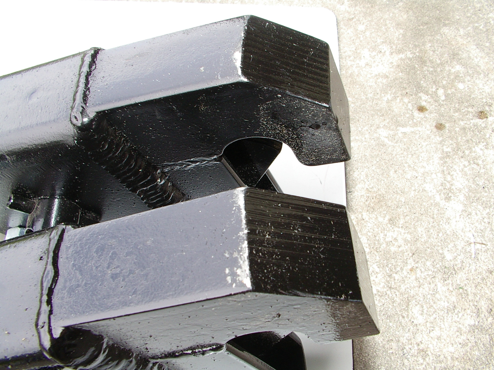

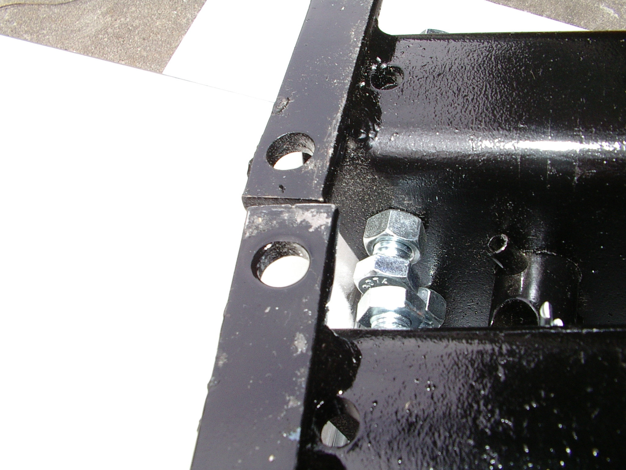

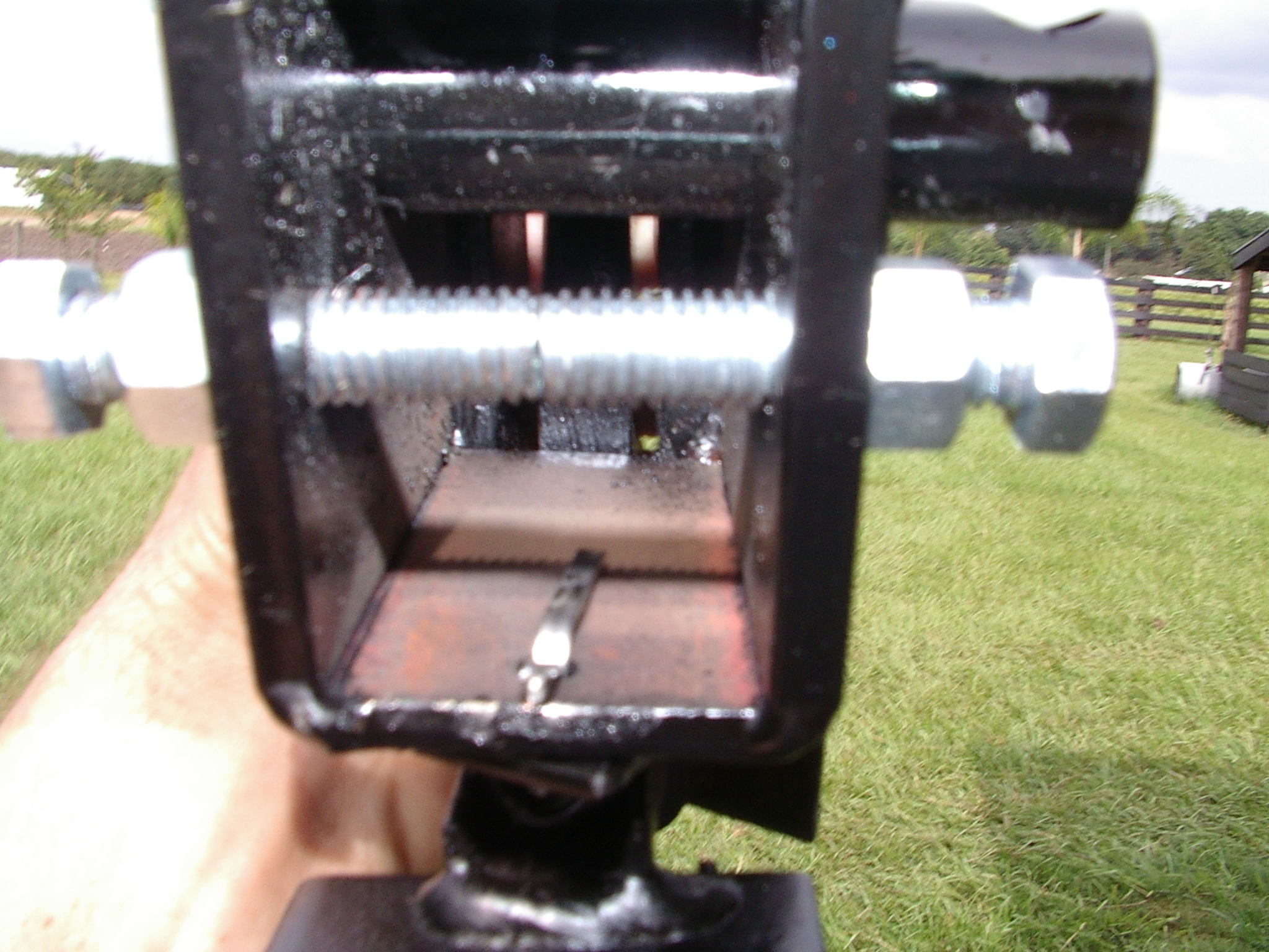

So its ok to sell shoddy workmanship as new and as a quality product. I don't care what the purpose is of the product is for. This should have NEVER been shipped to any customer. The pin holes are the correct size. They were drilled out of line. No paint coverage inside, let alone primer. (THINK THIS MIGHT RUST QUICKLY) I did not become successful by putting products like this in my customers sights and expect payment as if this was quality workmanship. Enough excuses!!!

Personally, the spatter wouldn't bother me. I would just paint the whole thing, as eventually you would after its used awile. all implements etc need to be maintained with being touched up.
I would contact Agri Supply and see if they would take it back. I know that the manufacturer would take it back if you weren't satisfied.
As for the fit, this is the first post that ive seen where it wasnt right so I suspect there was a problem there, just as another poster said.

Doesnt look like a Pats to me. Only very vaguely similar to mine. I think you got a Chinese copy.
larry
/ Where is "Pats" Quality Control? #12
That looks nothing like the Pat's hitch I bought. I think you got a cheap copy. The workmanship is not Pat's and I have never seen a price that cheap. Rest assured that Pat's will take care of their customer, but I think your beef will be with Agri-Supply. Look at the pictures of Pat's hitch on this site and notice the difference. Demand your money back and spend $20.00 more and get the real thing.

I've had 2 sets of Pat's (the real version) and have never had a question about the quality control. They are very well built. Buy them directly from Pat if you want quality, otherwise you are just getting a cheap knockoff.
I've never seen the Cat 1 version, but what you have has a lot more welds than mine...they look like they were scrapped together.

never thought about them being knock-offs but on the hooks, mine have a nice rounded edges......your's look to be just straight cut with a 90 degree edge and "sharp".........
boy, if they made them look that close, that would be a crock of crap to build your rep and give great customer service only to have the chicom and their distributors help pat take the blame for their crap......
other than alignment, the spatter and paint wouldn't bother me......and i'm pretty picky....

I agree with others... weld spatter is insignificant... and it doesn't look like the version of PATS Cat II I received. Something doesn't seem right regarding what you recieved, it doesn't mirror any prior PATS report on TBN.

I have not contacted Agri-Supply regarding this matter yet. I just opened the package yesterday early evening to find this mess awaiting me. Agri-Supply catalog customer service is closed today. If this is not Pats product and he has his product name trademarked this would be a litigious situation. My issues are with the product and since it is advertised as "Pats" that of course is why I am using this inference. I will absolutely find out tommorrow who the manufacturer is (It is advertised PATS on the box) and in any case I will return this. I'm sure I'll get hung for the return shipping but I will get to whatever level of management it takes to rectify this issue. If I were Pat and this was not my product, I would definitely not rest until Agri-Supply made it clear in their advertising of the actual manufacturer and there is no relationship with "Pats Quick Hitch". As for anybody knowing the difference in the items with one called "Pats Quick Hitch" and another "Pats Easy Change System",(It is only called by this name in their catalog)(ON the internet item #70078 is "PATS QUICK HITCH" businesses do this all of the time trying to entice a customer thinking a manufacturer has made a "custom" version just for them. So if you do not have an Agri-Supply catalog, you are buying "PATS QUICK HITCH" from the internet. I agree the "Pats" here does have differences and I'm sure they are of a positive nature. Once again, all I had to go on last night and this morning was it was "Pats". I was expecting something of a high quality with the majority of people here very happy. I just figured once again this is my luck and I got the reject that was supposed to be thrown away.
