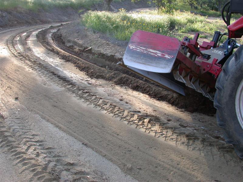

Baranx, Top n Tilt is great, but I think your comparing two different concepts. A Quick Hitch is about connecting your Lower Links (and some with top links) to the 3PT Implement Faster. Like switching from a Brush Hog to Box Blade.
If I need to connect my Boxblade, I just back up, lift, and the bottom links are connected. 5 Seconds. With Top and Tilt alone you still need to get those lower links connected. How long does it take you to hook up? I know you don't have to leave the seat when operating the equipment with T & T, but were taking about changing/hooking up different equipment.
Many have T & T And Pat's Easy Change, Like 3RRL(Rob)

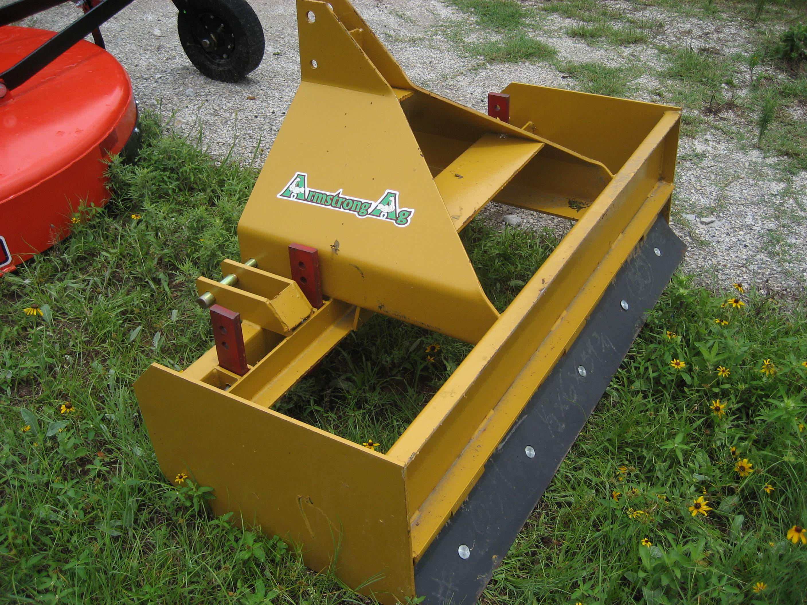

   / Which 3 pt. quick is better? #23
...but I have really bent the fool out of my box blade...
...So I need to get some new arms for it...
Got my the BB 1 1/2 yrs ago for $488 (5' wide with 5 Scarifiers). Check out the Box Blade arms. Nothing there to bend! Pic was from when I got it new. Just want to let you know what's out there.
   / Which 3 pt. quick is better? #24
I like that one..
If it wasn't raining I'd go take a pic and show my destruction..
I paid $435 for mine.. and wish I had yours...
J
