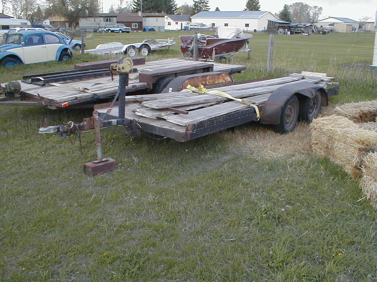

but reality is parts are like $300 an axle. why wouldn't you do both?
Because I only paid $300 for the trailer. I don't want to sink too much into the trailer until I've proven to myself that it's worth it. I'm planning to do lights and a single brake axle to get me going. If I like it enough to keep it, I'll eventually add the brakes to the second axle.
See the attached pic. The trailer in the foreground is the new one. The one to the left of it is my old one. It's a good trailer, but I really miss the tilt feature I had on the shorter trailer I had before. The white one in the background is the neighbor's.
