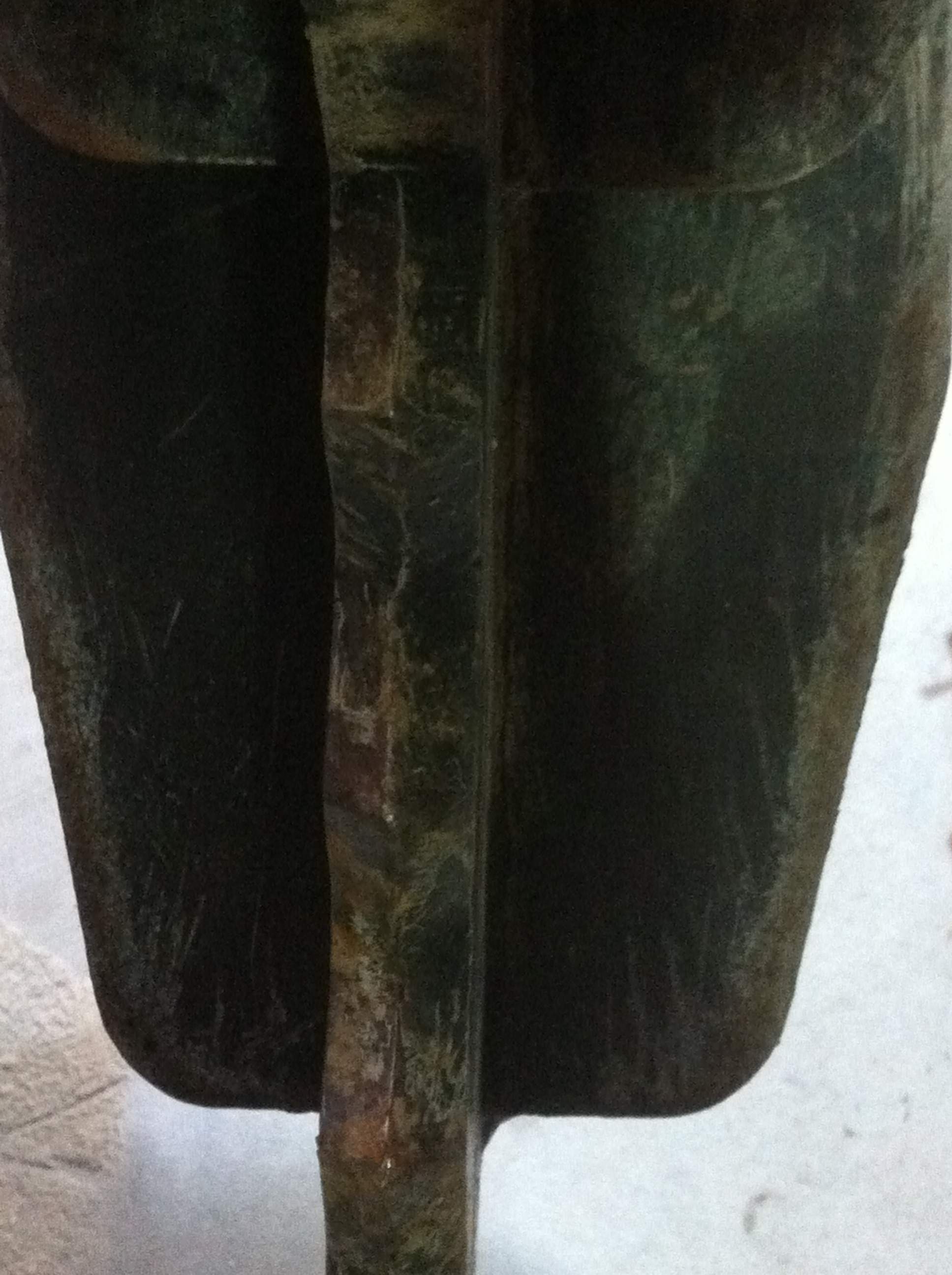

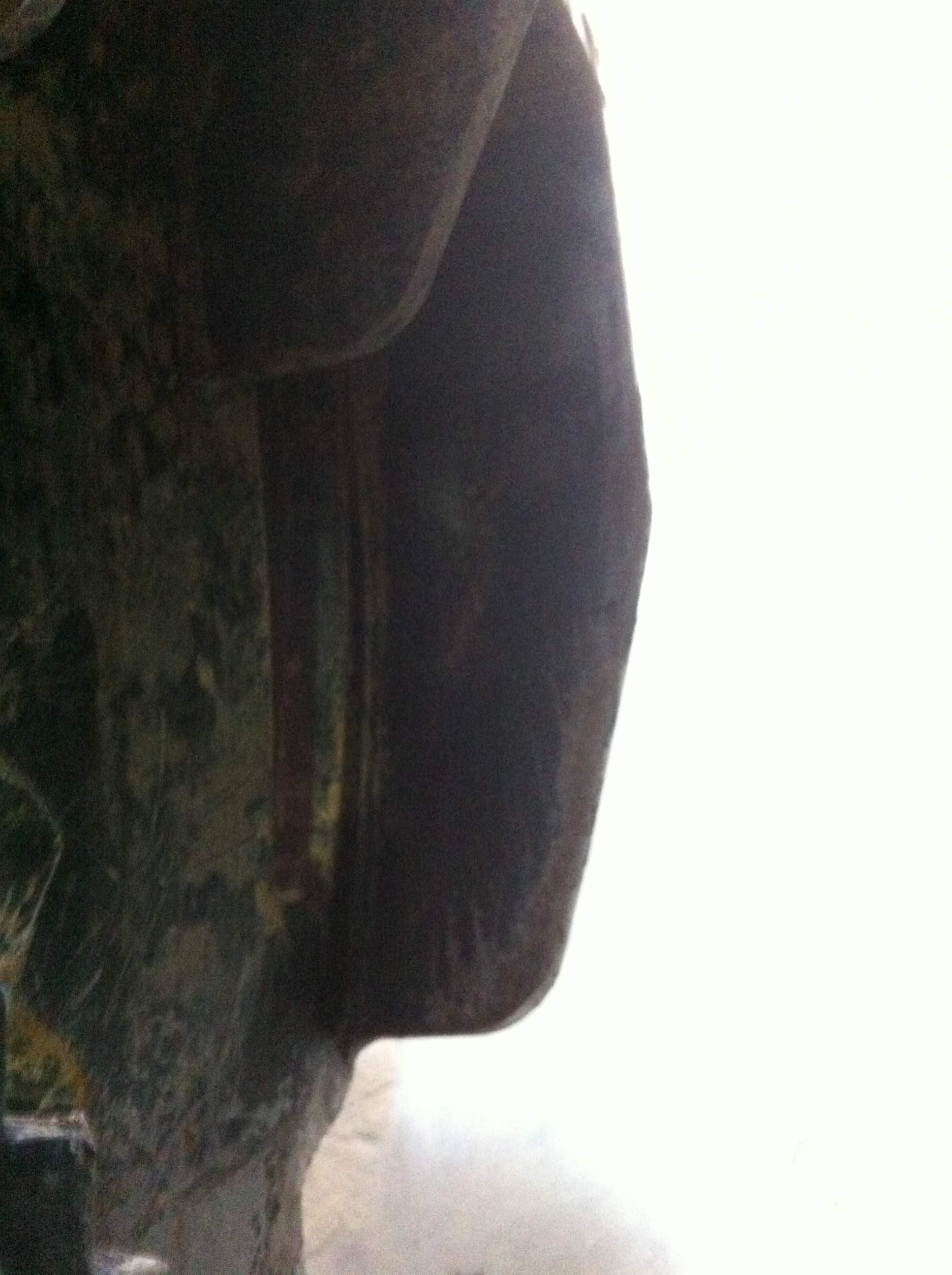

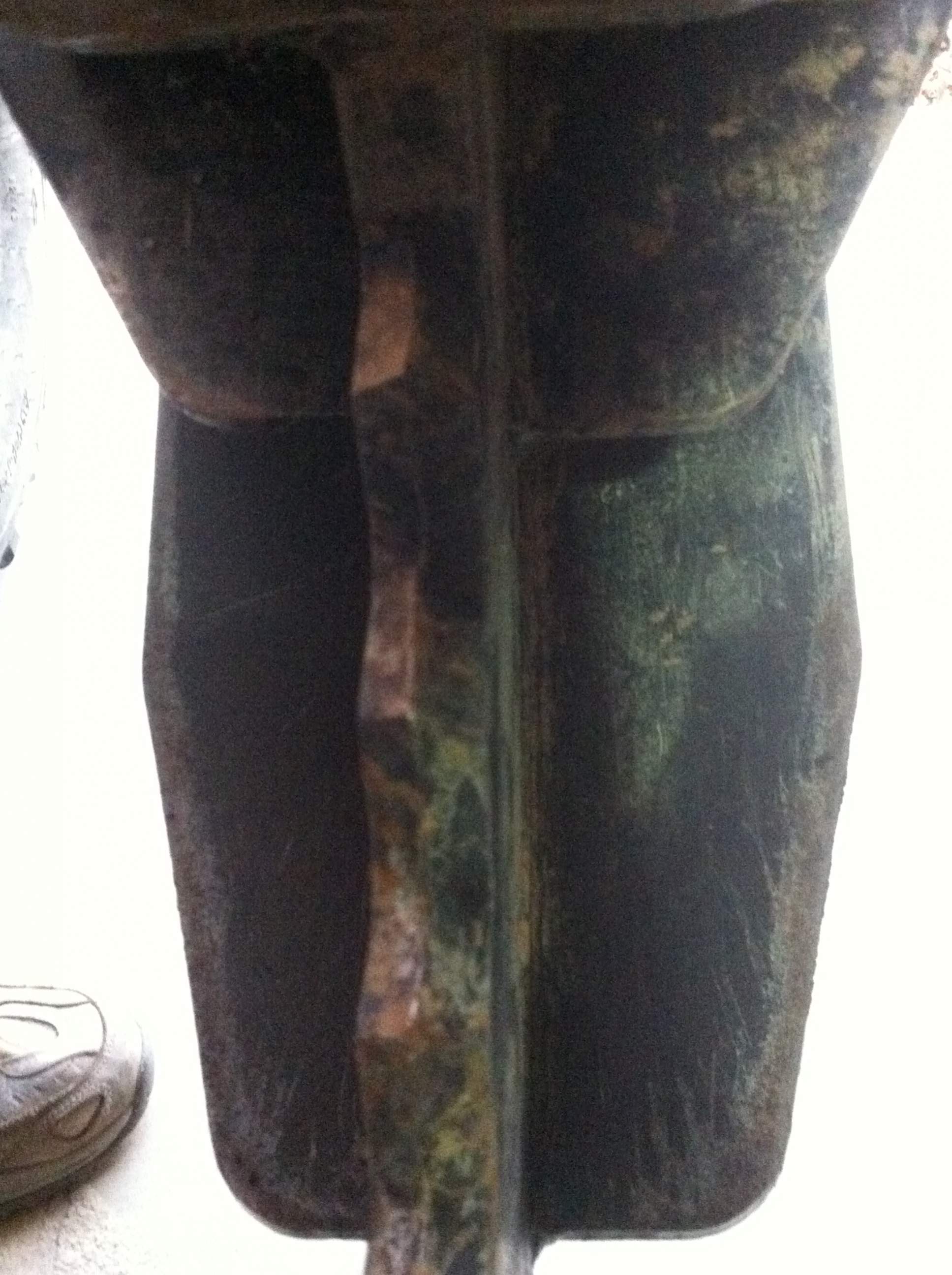

Ripper CLAW pics 001.jpgRipper CLAW pics 009.jpgRipper CLAW pics 008.jpgRipper CLAW pics 007.jpgRipper CLAW pics 006.jpgRipper CLAW pics 005.jpgRipper CLAW pics 004.jpgRipper CLAW pics 003.jpgRipper CLAW pics 002.jpgRipper CLAW pics 010.jpg
Here are pics of the gen 2 ripper tool, CLAW.
They are shot from left and right side looking directly at the teeth and scoup plate. Several pics into the group the CLAW is shot from a distance from the side and then from the back.

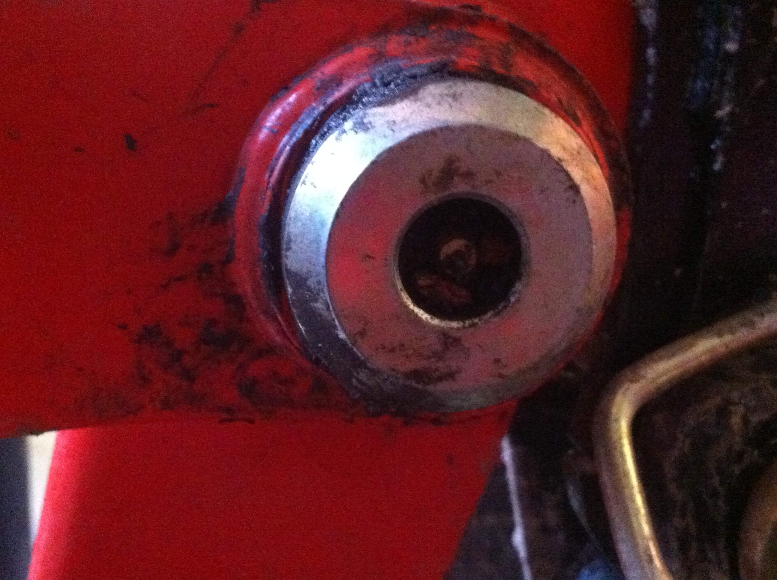

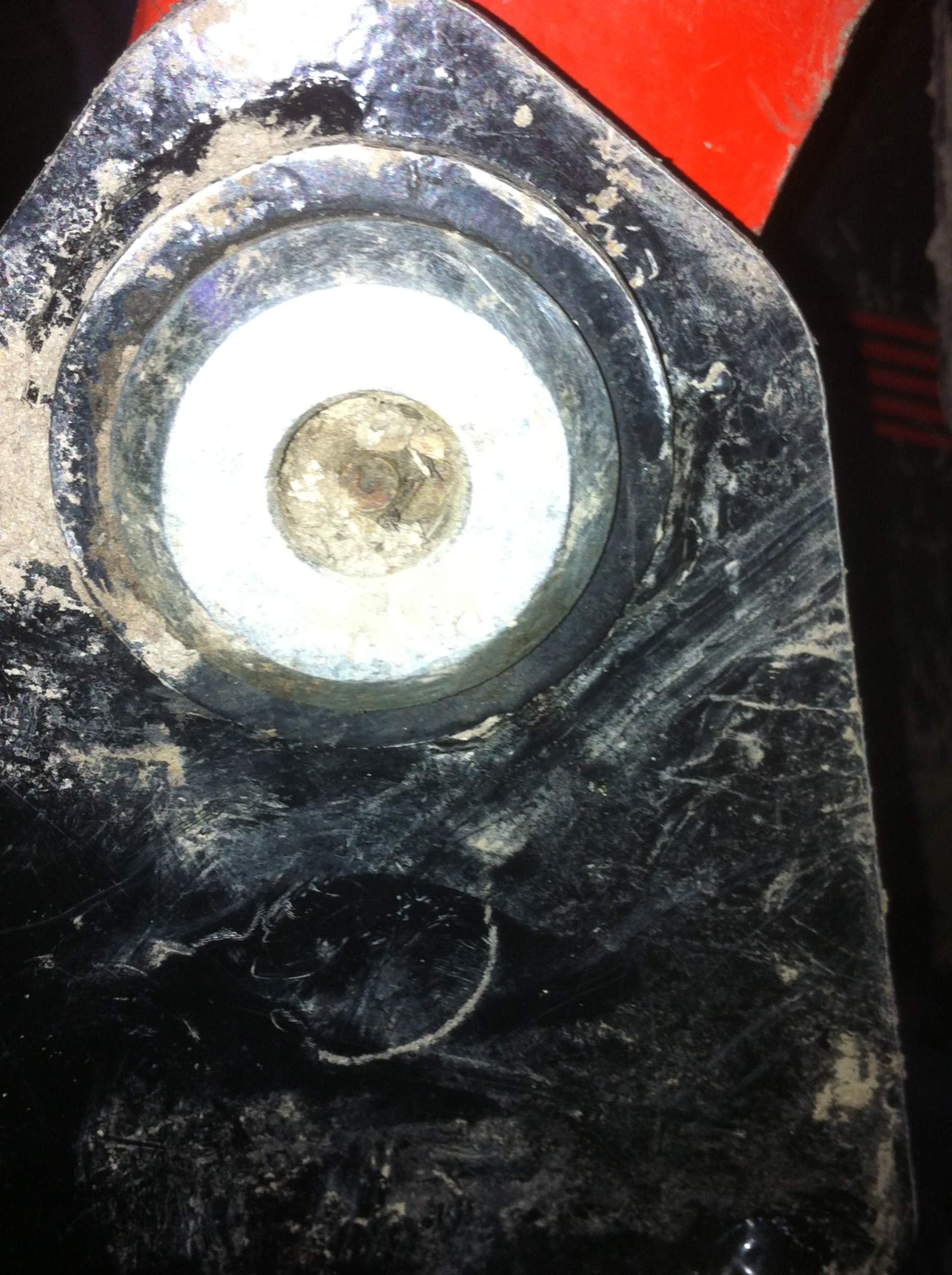

Two pics show what and actual KB-2485 pin end looks like- notice the flat of the outer surface, unlike the ones you have.
You get the correct bucket, a new dipper stick and the CLAW and you'll be having the time of your life! And about time too!:dance1:

Looks like the only change from my original claw is the serrated edge on the tooth.
   / which backhoe to buy for a dk50 with cab and hydro #36
Pretty much, just claw teeth on front and back, and it works better too:)
Hard to say really, but I think the teeth add to the ripping effort of the big tooth. Bob at MIE says he sells 50% of each version. IT, you should come to VT and we can have a CLAW OFF!:thumbsup::drink:

Thank all of you for your informative responses, pictures and pms. Friday I sent a letter to dealer requesting a new backhoe and bucket with pins. The letter was forwarded to Kioti. I believe the dipper stick, link ***'y, and the left and right link are egged shaped and the machined bosses at end of dipper stick are chipped and starting to flake away. Just new bushings are putting a temp fix that will cause issues down the road. The best thing that I have learned thru this test of patience is the 2nd gen. claw. After I find out what Kioti is going to do, I am going to buy one. I think for all the uses that tool can be it is much better than any 12" bucket. Bottom line for me is if Kioti gives me a negative answer on a 25 hr hoe that they miss assembled, I will sadly spend the 1600.00 to buy the above parts to get this hoe working. I was going to throw in the towel and say f.i.d.o. But from hearing your testimonious I believe this dog will hunt. I was affraid 1600 more just might be throwing good money after bad. On another thread "rscoot37" has said he has installed many 2485s without issues. CM and IT all good comments and I thank you all. I will
   / which backhoe to buy for a dk50 with cab and hydro #38
I think the dealer assembles the sub frame, the outriggers and attaches the bucket. In which case, the person who attached your bucket knew perfectly well that it was the wrong bucket, or at the very least, the wrong pins. The bucket would have been very sloppy and the amount of grease that was applied before it squirted past the pins would have been an unusual amount. (if they even greased it).
Keep Kioti customer service informed. They will encourage your dealer to correct his mistakes. You should get a new backhoe.
When your new backhoe arrives inspect it thoroughly before it leaves the dealer, and please keep us posted.
