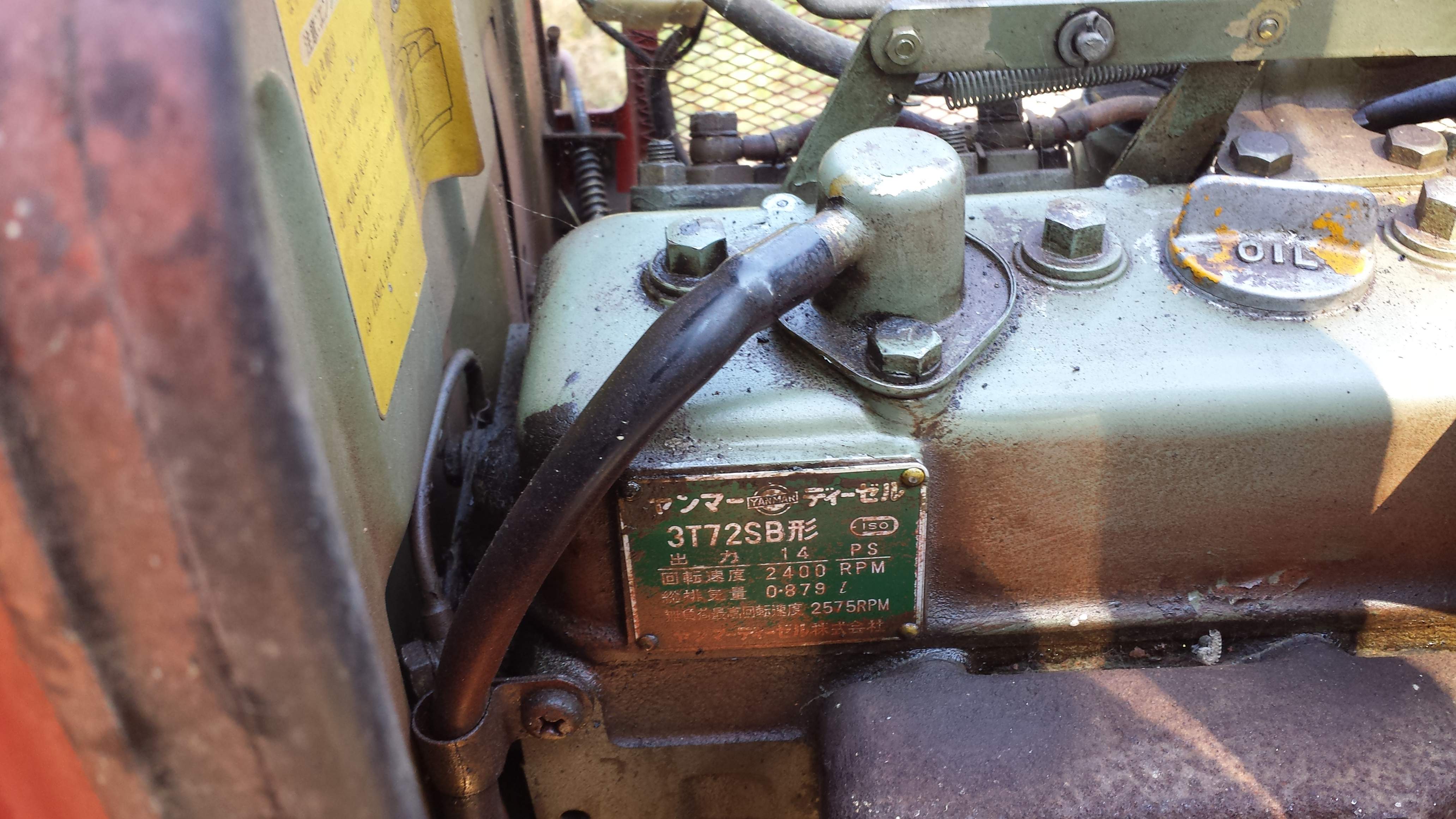

My new-to-me 2wd YM1401.
   / Which engine is in your Yanmar #140
3cly pushing about 14Hp. Was this used or refurbished?
A simple single axle flatbed trailer would haul this around really easy.
Did it come with ROPS? If not, check out Fredricks here: http://www.fredricksimporting.com/rops-manuals Your unit may take a ROPS-1 or ROPS-2 setup. These ROPS are foldable and the best insurance against serverly getting hurt or death.
