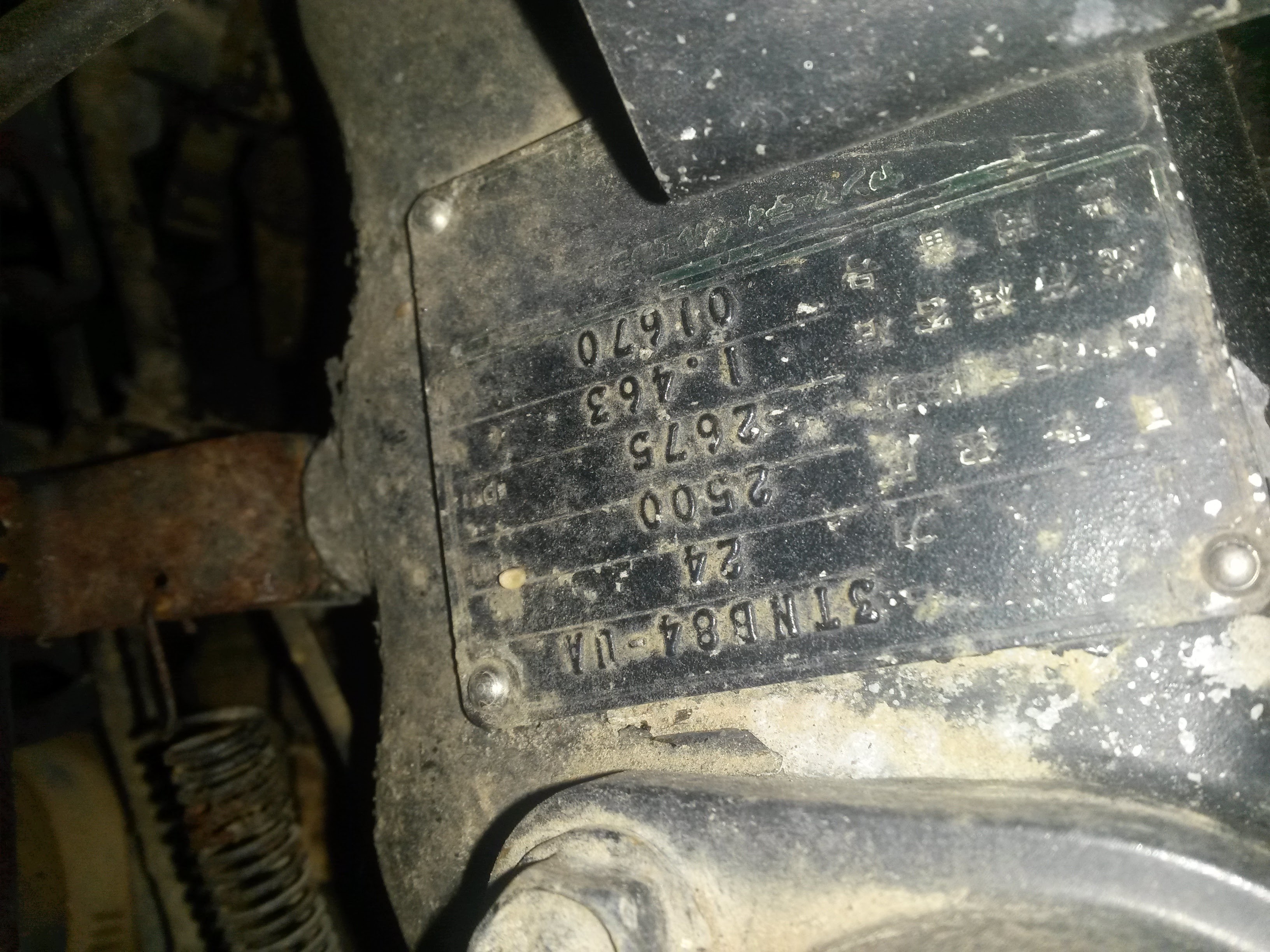

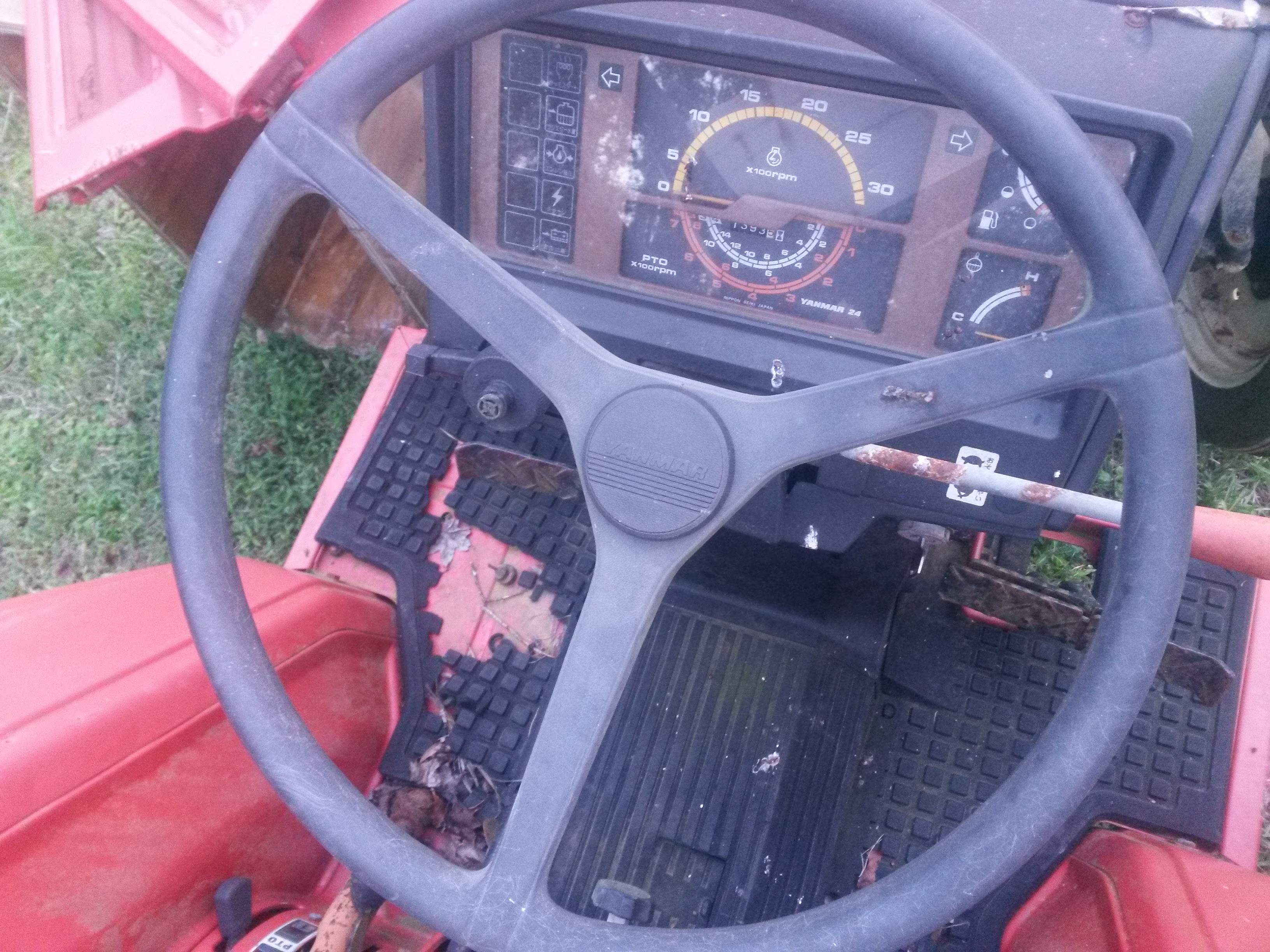

Hi everyone. First post here. I bought a Zen-noh Yanmar a while back mainly to get the engine, as it was posted for sale as "will not move". Motor purred like it was new so I brought it home, and it has just under 1400 hrs. The gauge cluster calls it a Yanmar F24, but the engine covers are badged by Zen-noh as an F22.
The engine is labeled as a 3TNB84UA, so I'm 99.9% sure it's a Yanmar F24 after the dozen or so hours of internet browsing on it. I did a preliminary inspection in the gearbox and found a broken tooth. I've decided not to part it out, but will end up repairing it and will perform a mild restoration (low cost, high time). Once I get going I'll post a new thread

Welcome to the forum. :welcome: What gear was the broken tooth on.

The broken one I saw didn't look cast to me.
I'm going to weld it if I can. It's not open anymore, so I can't tell you exactly which one(s). One for sure is on top, one of the front 3. The whole tooth was sheared clean off. I'm sure it's still down there. I'll post a pic of the gear first thing when I get going on it.

I will be surprised if your ring and pinion are not suspect.
   / Which engine is in your Yanmar #160
Wheels locked up, or rolls but can't engage a gear, or ??
Clutch works. It will go in gear, and I have been able to move it a few inches, maybe a foot, then it stops rolling.
Same condition in any gear. I don't know enough about the drive train, so I'm not ruling anything out.... including the possibility of the ring and pinion as Winston mentions. But the sounds it's making is right in the gear cluster area. It makes these bad noises even in neutral, when the R&P are idle. My guess is that theres a bad "important" gear on the main shaft coming from the clutch that needs attention. I'm trying not to move it much, as I don't want to make it worse. 3 weeks and I'll have some time to find out for sure
