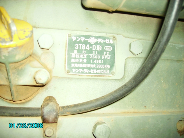

Fx335 Engine # 4TNA78-RN
   / Which engine is in your Yanmar #142
YM 2820D
Engine: 3T84T-H
   / Which engine is in your Yanmar #143
My 155D has 2TR13 motor
And the 276d has a 3t84ha

The FX24D has the 3TN84U-A Motor

I have a john deere 990 it has a yanmar 4tne84ejk motor it needs a piston and head gasket . I would like to know if I have to get these from jd. or is the internal from all 4tne84 blocks the same
