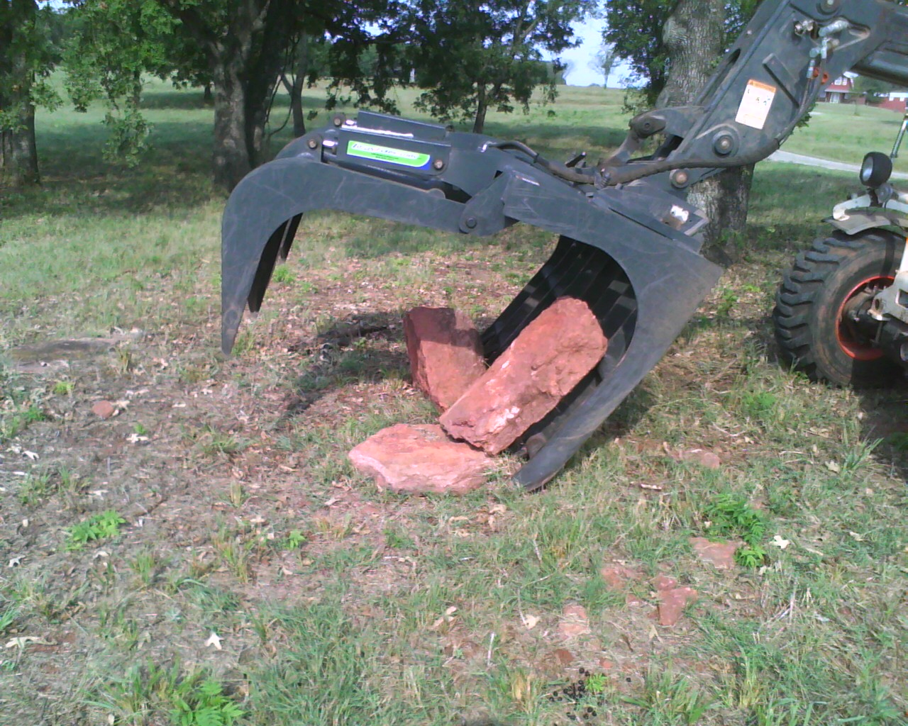

Picking up rocks with a root style grapple:

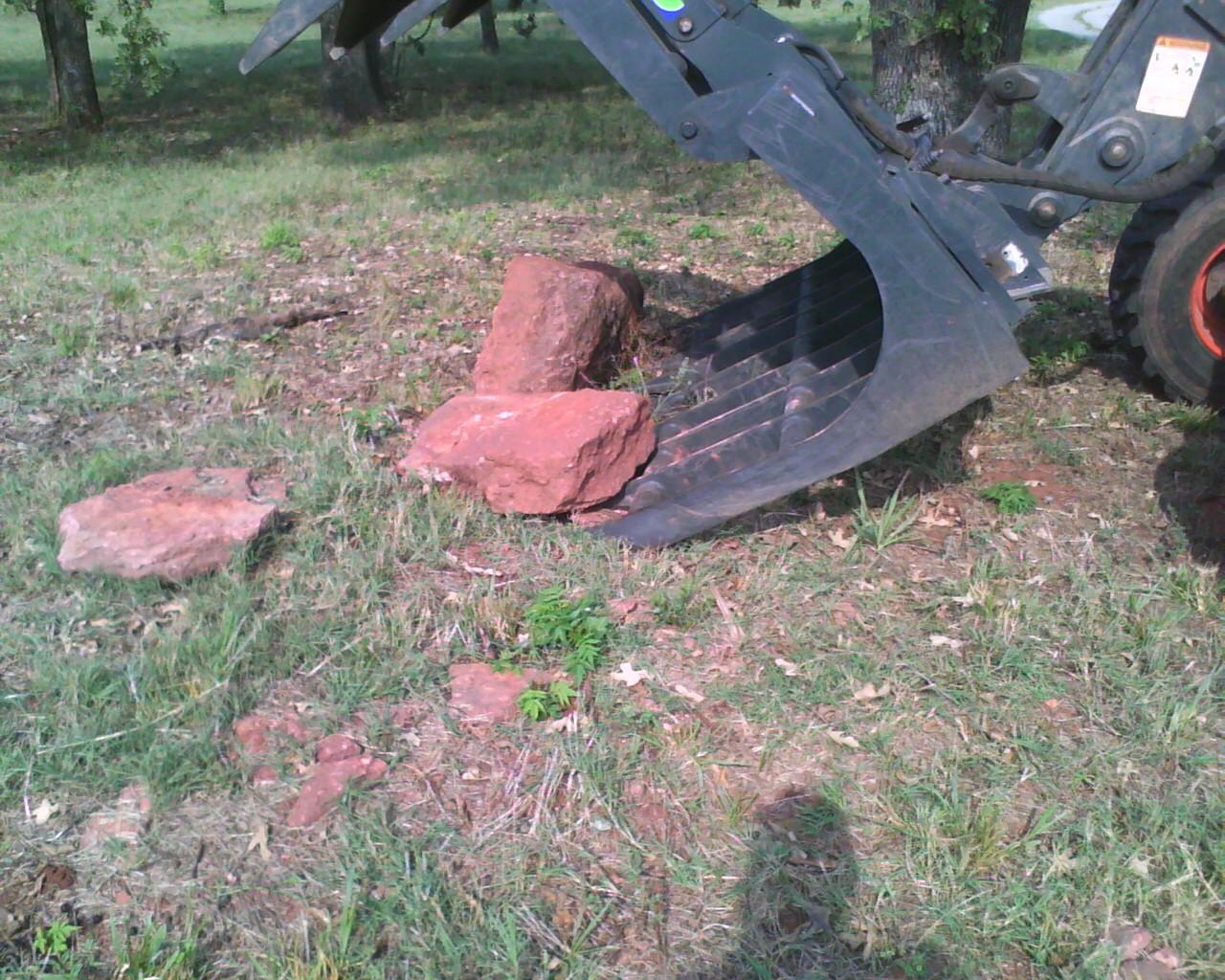

I have a B2650 Kubota and have decided I want, different than need, a grapple. Have been researching for a couple weeks and talked with my Kubota dealer a couple times about getting one. If I use it I will be doing some brush pick up, no big trees or stumps. I also have many rocks in the 24" to 36" size. I currently have difficulty picking up these rocks with my front bucket.

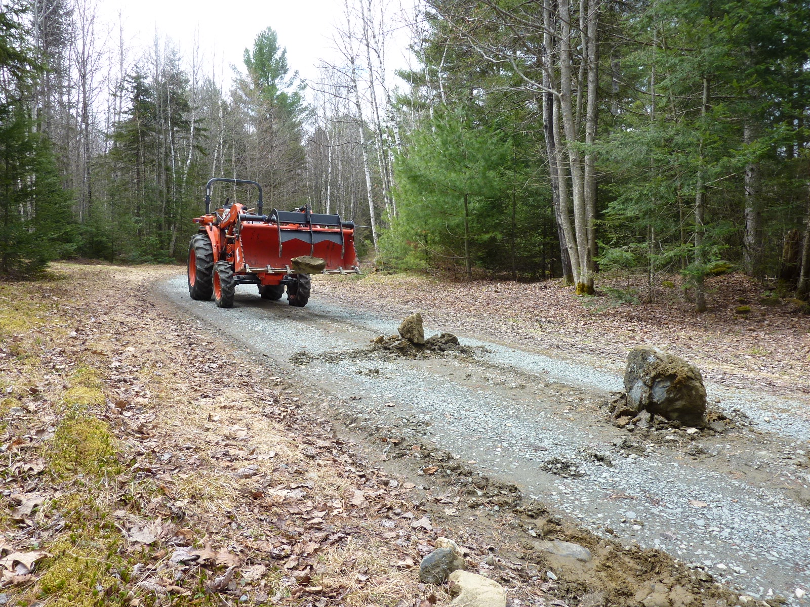

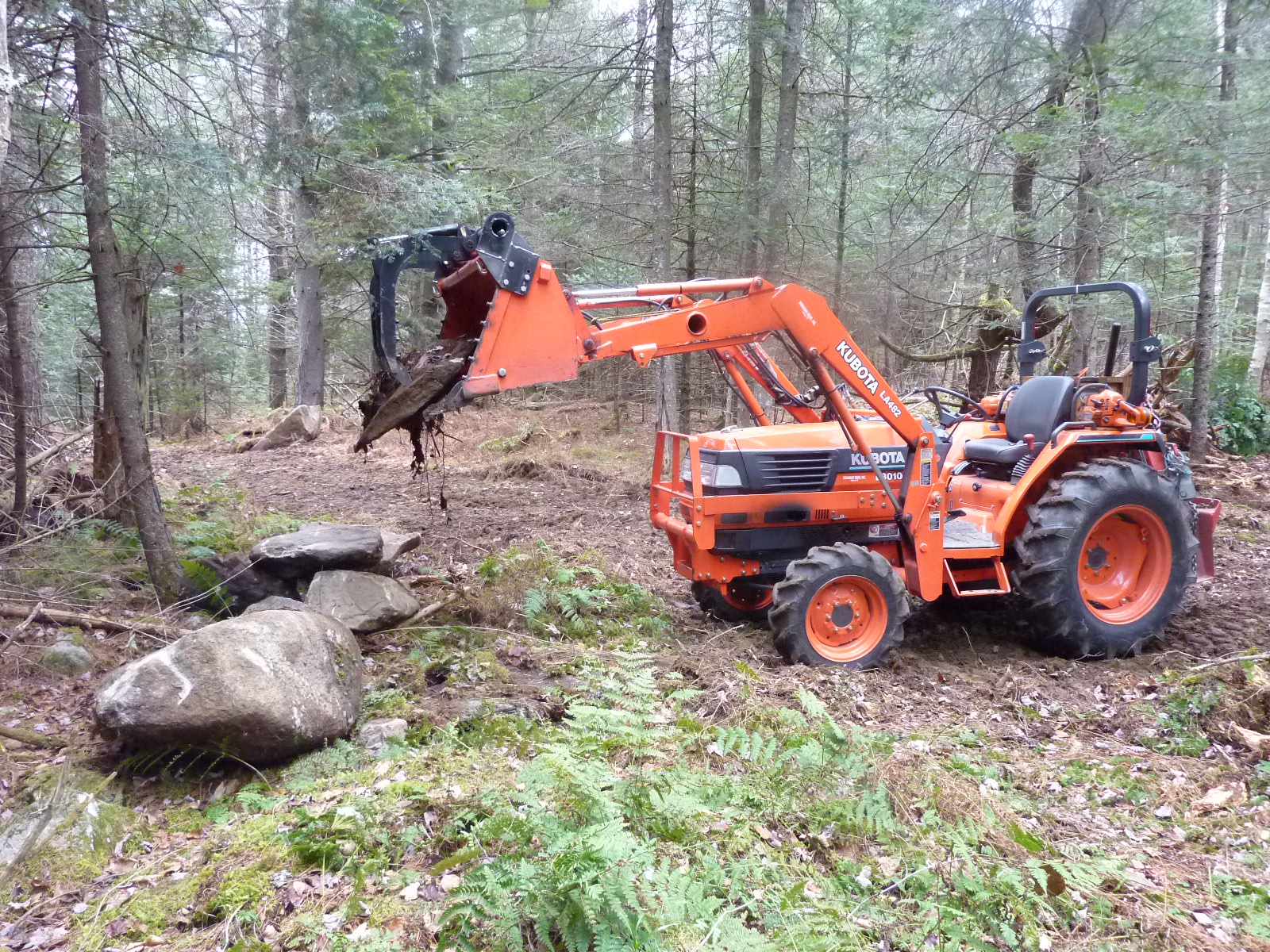

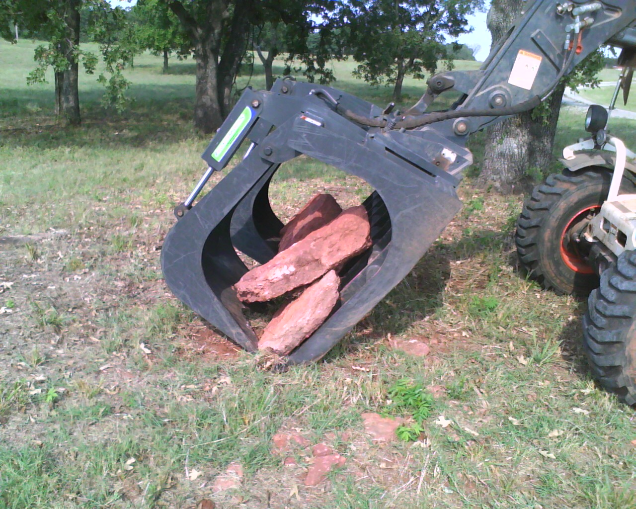

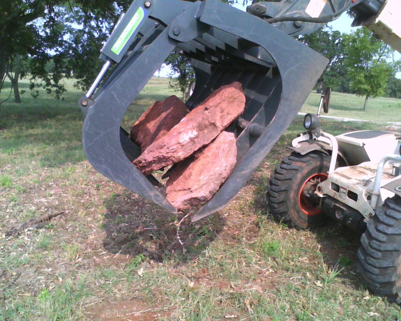

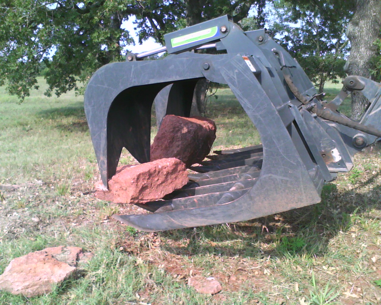

I do what you want to do all the time with my pallet forks/matching grapple...
And LOT's of brush cleanup too,
SR

   / Which Grapple Root or Claw???
There you go!!! Looks like what I want it to do roock wise and capable to do brush and other stuff.
SR
Thanks for info/pics of forks graspple. Hadn't really considered that but will go forth and research to determine weight and price and availability (cost to get to me).

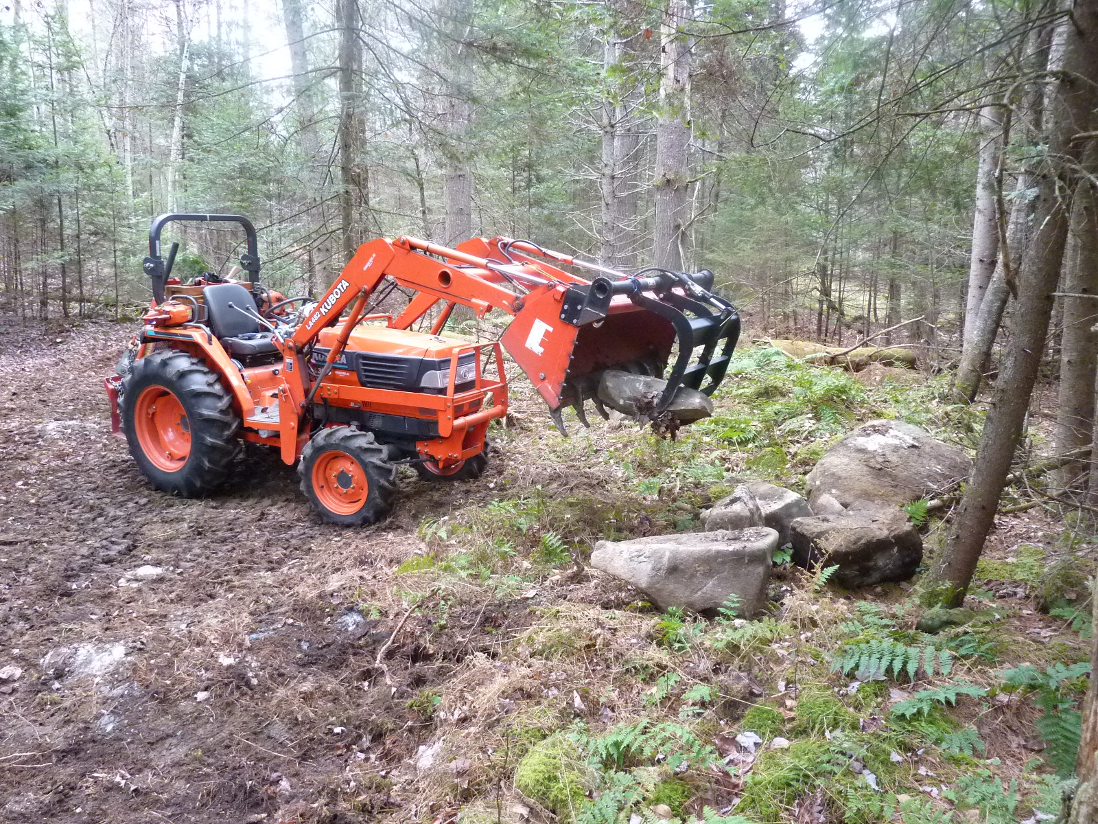

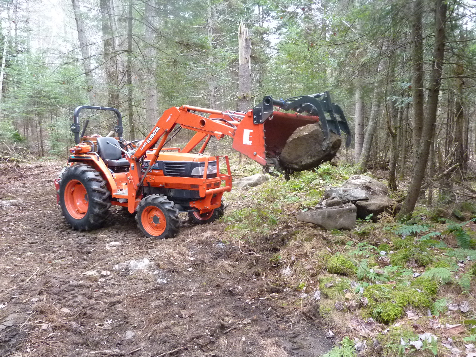

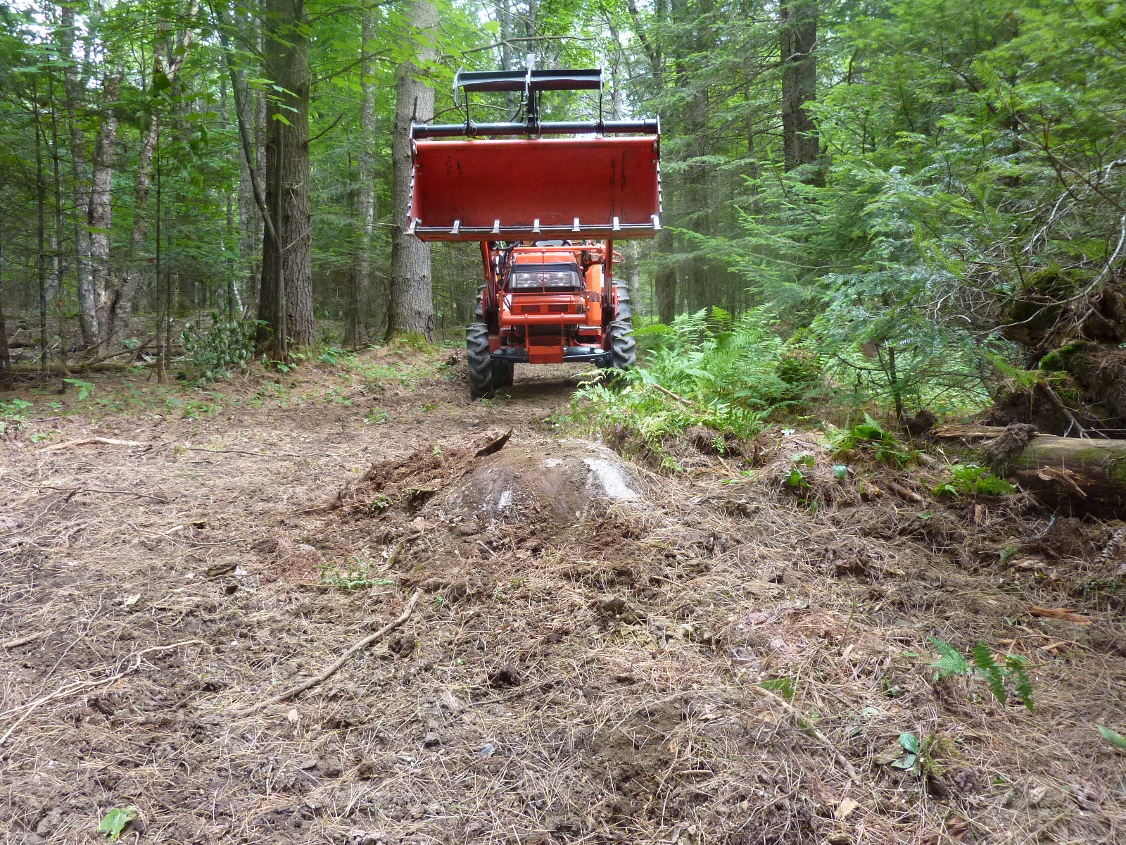

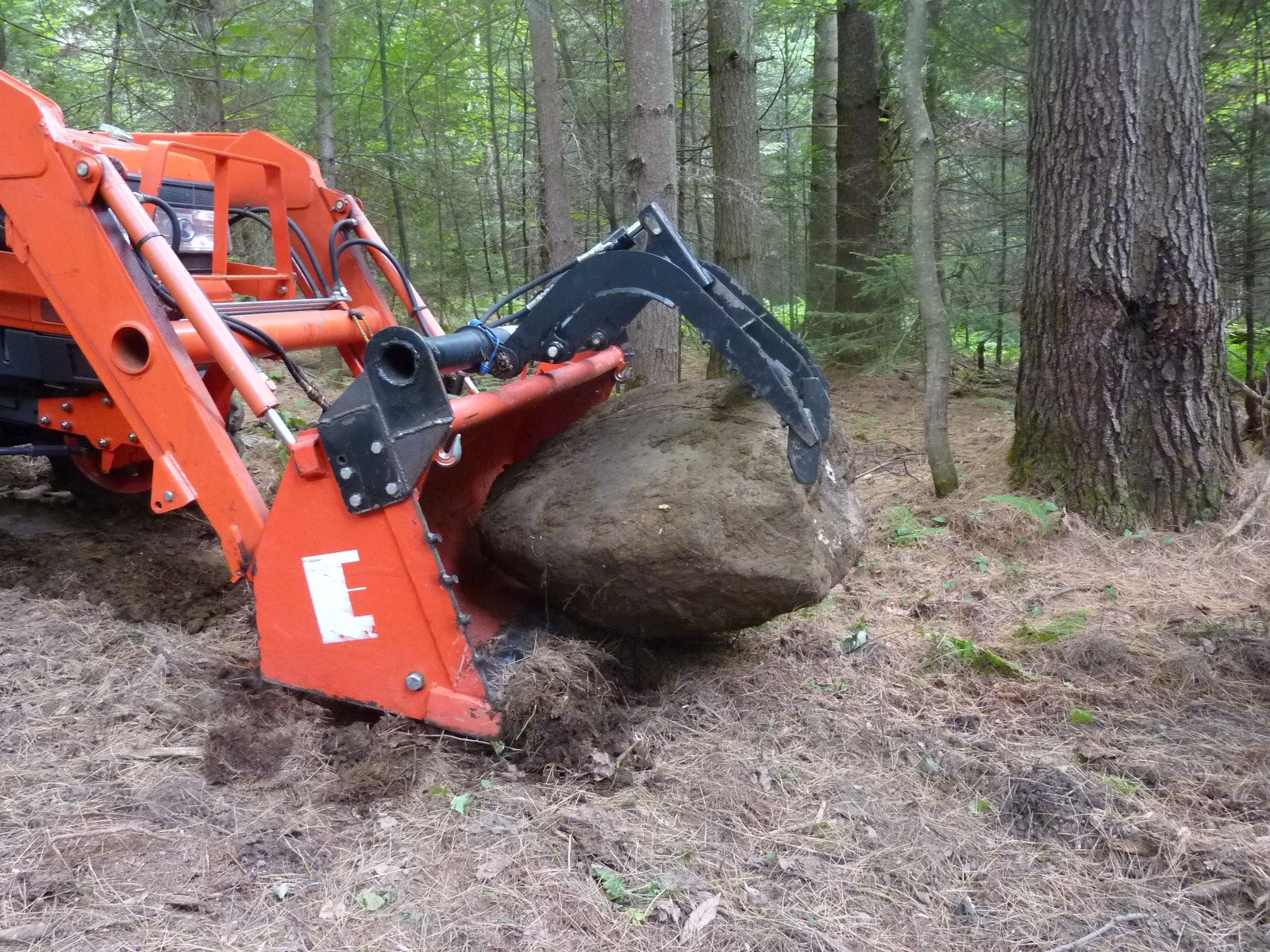

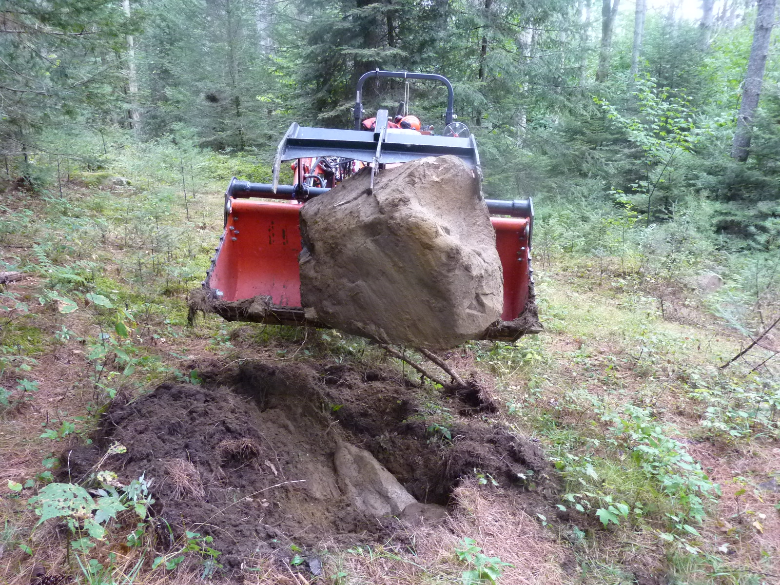

   / Which Grapple Root or Claw??? #10

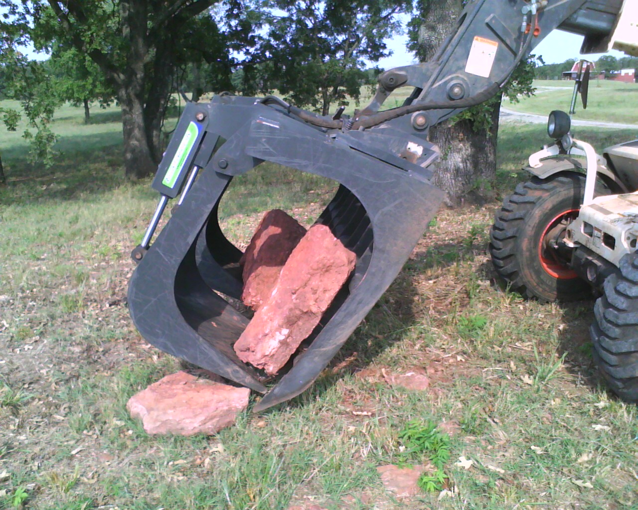

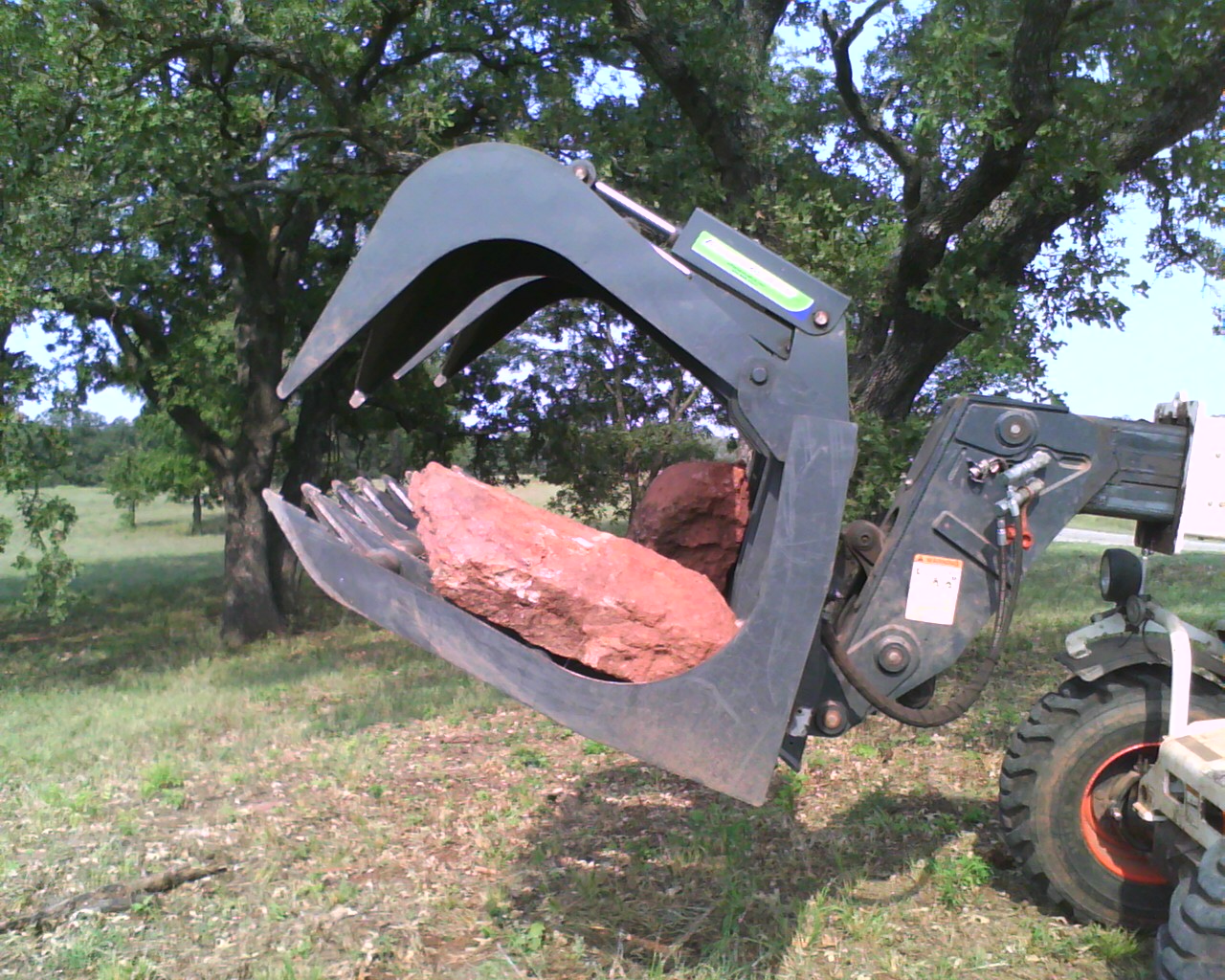

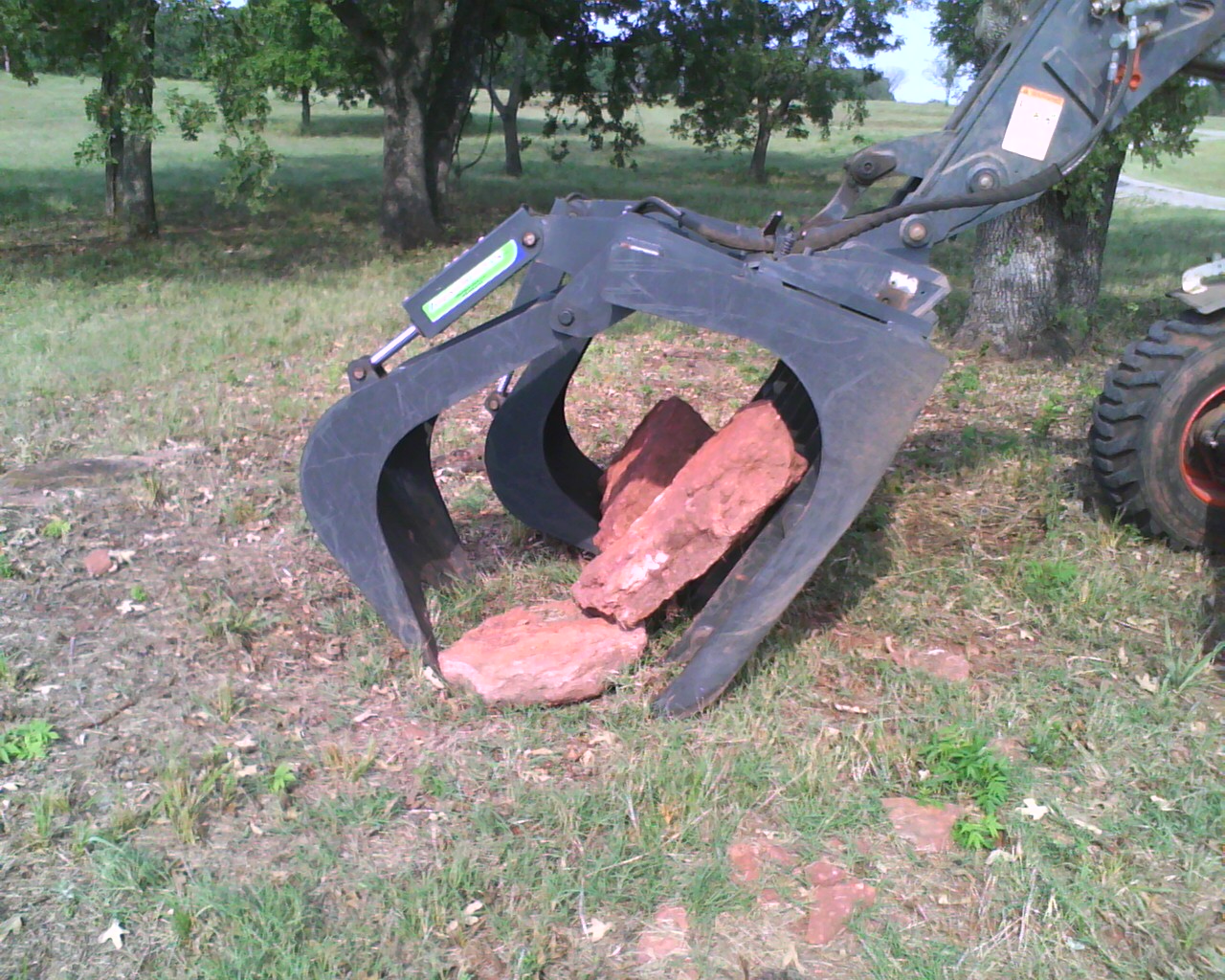

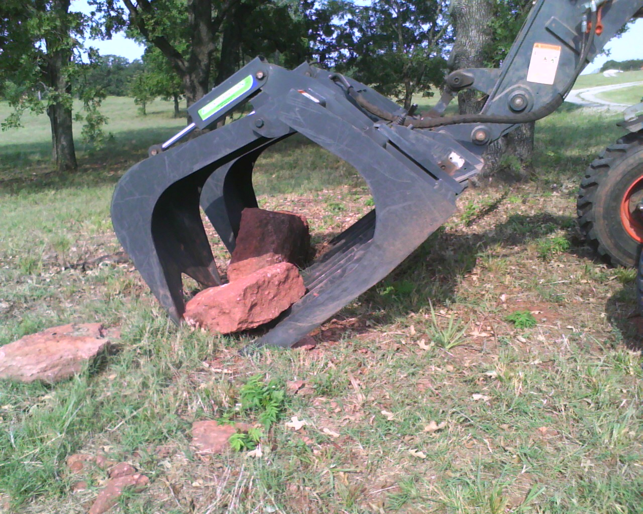

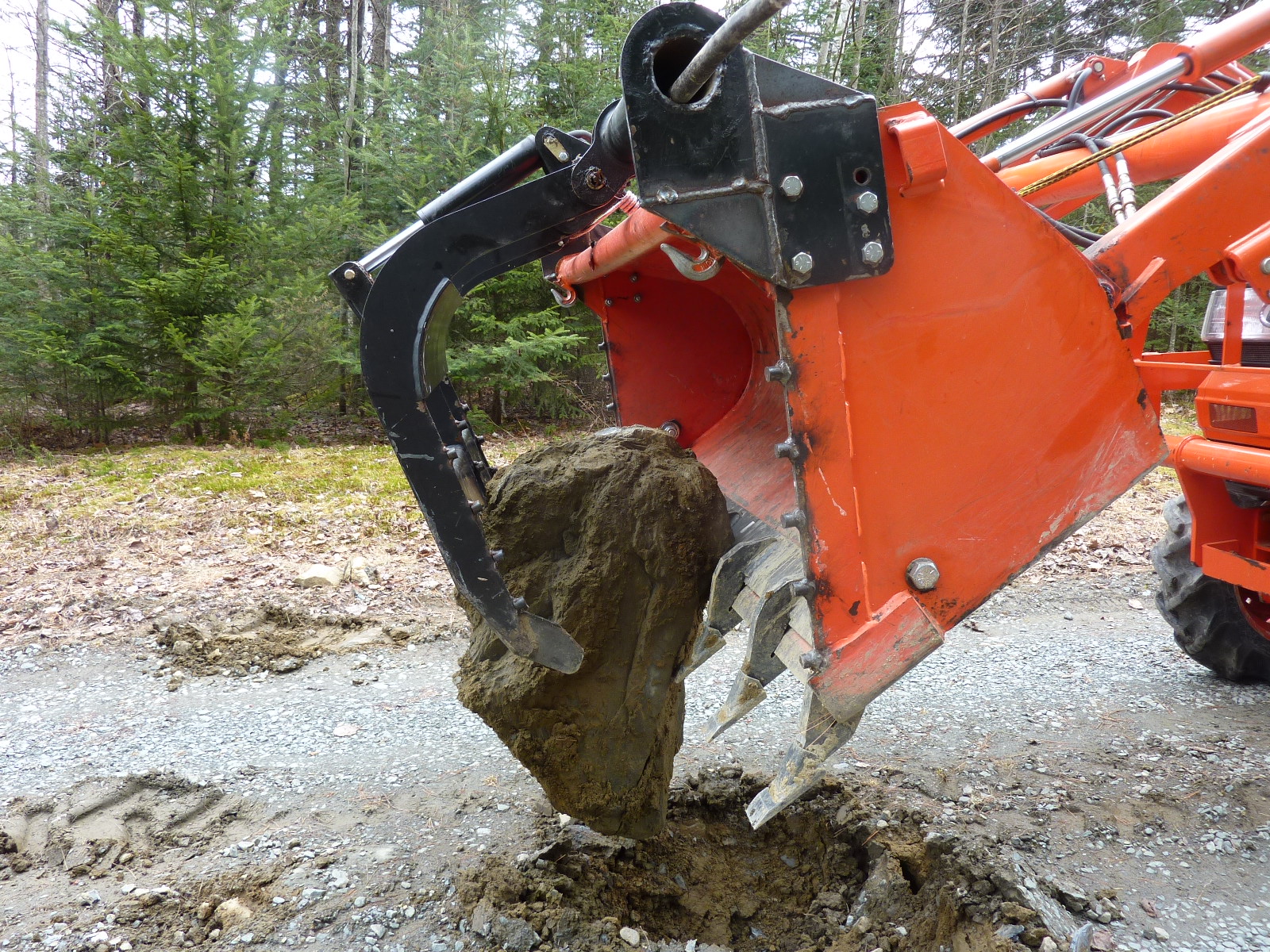

I think rocks are pretty easy no matter what type of grapple you have. All sizes and shapes.
Here is one
I got it out easily but couldn't lift it much. Had to skid it sort of.
Then there are all these we have lots of rocks
gg

It was made by ALO and I bought it from a tractor dealer who sells ALO products... I have no idea what they cost today...
It pretty much stays on my tractor, as it has hundreds of uses, from being an adjustable work table (with a piece of plywood) to moving big bales of hay to digging rocks out of the ground, moving pallets to allowing closer cuts when cutting firewood ect... The uses just keep going on and on and on, replacing many tools...
Here is one
gg
Where did you get this bucket grapple, how much and how much does it weigh?
   / Which Grapple Root or Claw??? #17
It is an ATI grapple kit. Fits 48" to 66" buckets. The tube comes long. You slide the hubs/mounting ears onto the tube assembly. Weld the tube to the hubs and cut off the extra tube sticking out on each end. I bought it in April of 2006 so I've had it 10 years. At that time it was $700. It weighs 135 lbs.
gg
