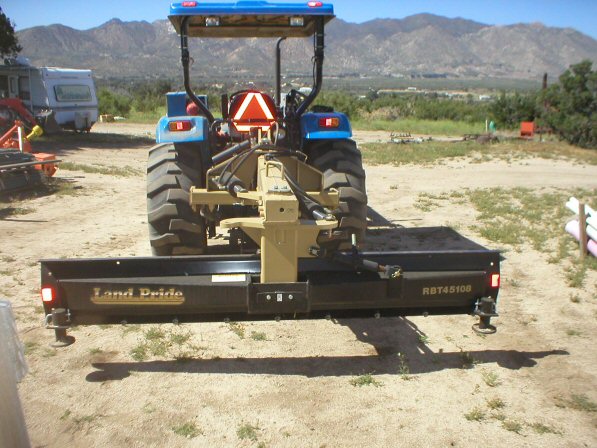

Presently have a 72 inch JD rear blade...bought in 85...had some welding done to beef it up....putting spacers on my 3320 and looking into a 7 ft model...looked at the basic woods blade at my dealer...looked rather tinny...was looking into the HBL84-2 rear blade...just a simple question...when one goes to rotate the 7 ft model 180....while on on the hitch...can it be rotated without catching on anything...BTW I do have pats easy change hitch installed.
   / which rear blade to buy? #37

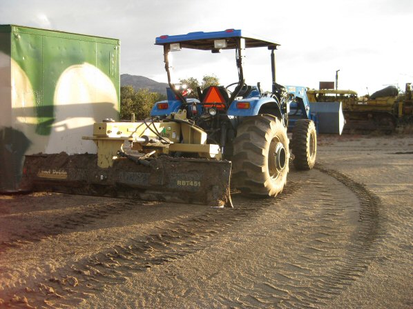

I'm not familiar with the blade that you are looking at, but pretty much any good rear blade will rotate 360* while mounted on the tractor. The better blades will have a boom that is long enough to allow the blade to turn 360*. There are some less costly blades that will not turn 180 while on the tractor. I have a Land Pride rear blade that is 108" wide, it will turn 360*.
Try to keep in mind that when it comes to NEW implements, you usually get what you pay for. ;)
   / which rear blade to buy? #38
Brian,now that a real blade there ! :thumbsup: :thumbsup:
Enjoyed your pic#3 with tractor,blade and nice background.Don't wish to get off topic but : Do you have a Thread or post here on TBN on how you ended up with your Big Bad Azz "BLUE" Mahindra ? :thumbsup:
Boone
Here is a post that I had made waaaaaay back when.
No, the blue paint is not from Mahindra. My dealer painted it for me to make the sale. When we were going over all the prices my salesman could sense I was a little hesitant. He asked what was wrong? I told him that the prices were fine, I just wasn't sure if I could stand looking out over a red hood for hours at a time, you see I don't really care for the color <font color="red"> red. </font> He said is that all that is stopping you? Yes, I replied. Then we will paint it for you, what color do you want it ? Well, the rest is history, good & bad. ;)
