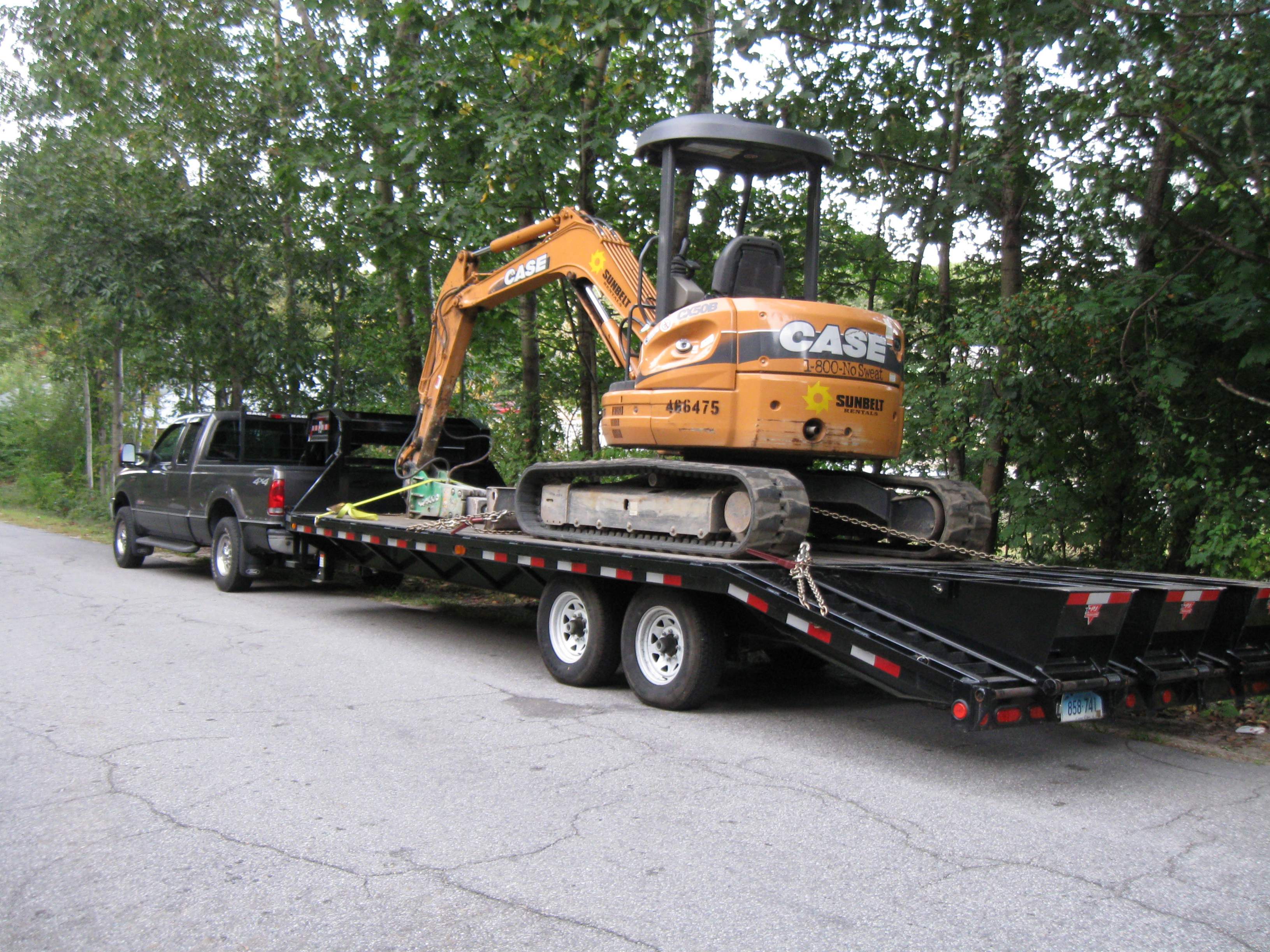

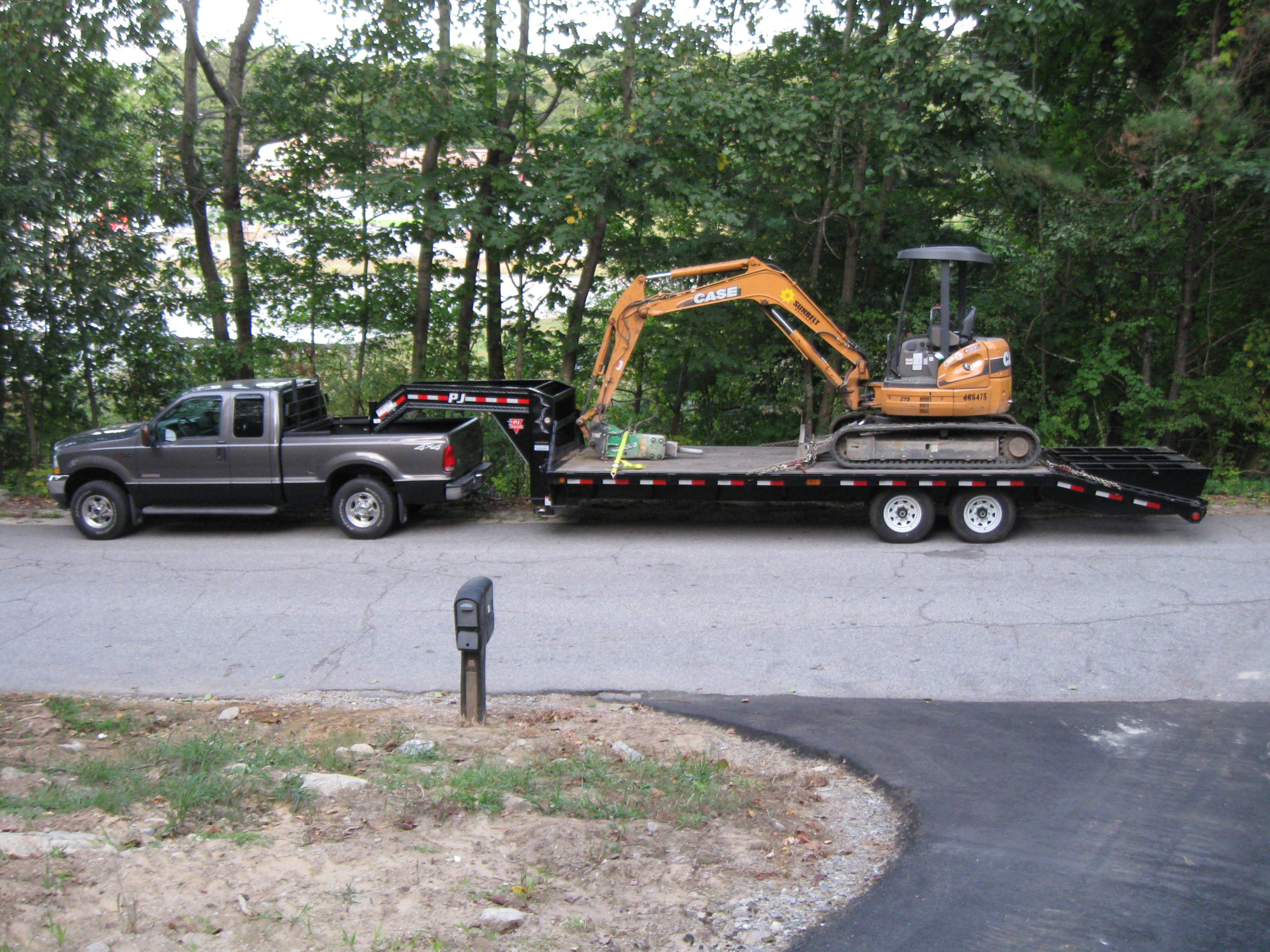

The stability of a bp deckover doesn't corralate to a GN deckover. I had a PJ 20+5 GN deckover with a 15600lbs gvw. The trailer was extremely solid and stable with any load I hauled. I had a 12k Case 50 with hammer on it and was able to spin the turntable of the mini 360 while on the trailer without issue. I doubt you need tandem duals with the loads you currently towing.

Greatwhitehunter, I wouldn't consider a bp. Really now down more to going with another GN between the deck or like you a deck over. My 304 cat is near your case at 11,000lbs. What does your trailer weigh? I can load my kubota 7040 or cat 304 so its got enough width. The fenders do sometimes get in the way when loading something like a basket of stone that you want to set over the axles to distribute load. Nice lookin equipment all the way around:thumbsup:

I wasn't suggesting a BP to you. Deckover BP's don't feel as stable with the higher center of gavity. The GN seems not to have those same physical traits.
The GN was 102" so I could put just about anything on it. It also had almost no load placement issues.
