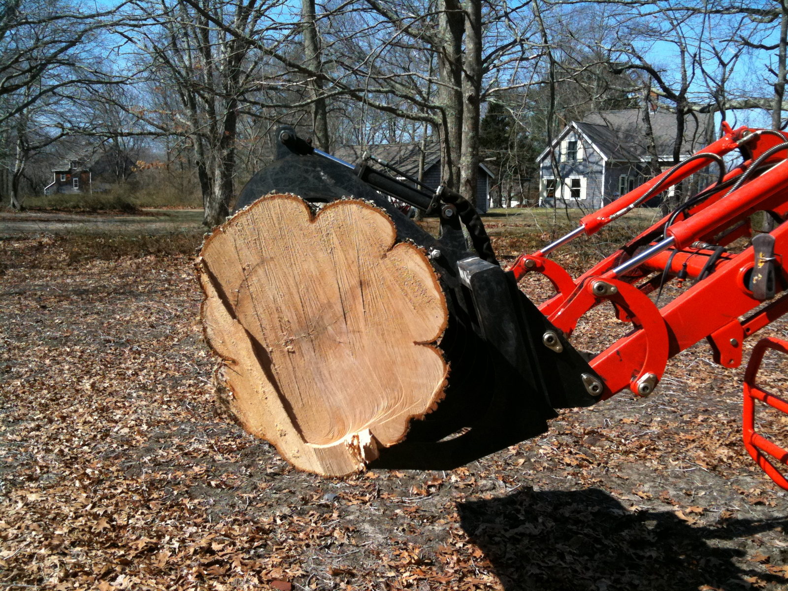

I really want to be able to grab the occasional 36" + diameter short log that I get for firewood. What does the Millonzi open to?

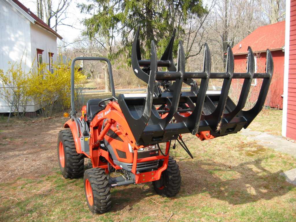

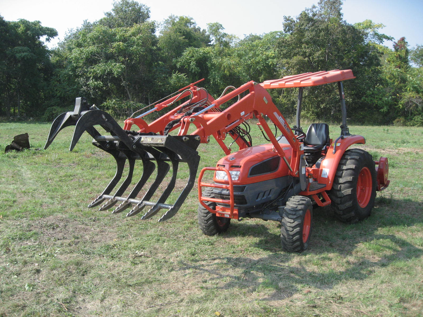

I am not near my tractor now but from looking at photos, I would estimate the opening of my Millonzi is between 36 and 48 inches. Probably about 42". Here are some photos to help you judge yourself.

This is one thing I have been impressed about WR Long grapples. The open bottom ones open to 44" and 47". This is very important in grabbing big loads with an L grapple, much more important to me than width.
   / Which type of grapple is best suited for... #78
I agree. Width is important only if you are scraping along the ground picking up debris.

hmm, seems like the most comparable thing today is the 48" Wildkat economy. I have to see how wide that opens. As your one pic shows, I want to be able to pick up big diameter logs and rounds to split up for firewood. Regarding large rounds, I have a question. Say I have a 36" diameter round that is cut to a 20" length. If the round is set on it's side, so cut sides facing out, is it possible to pick the round up clamping on the cut ends? So tilt the grapple to full dump position, and clamp and pick up by lowering grapple onto the round from above. Reason I ask is I want to be able to work large rounds onto the log splitter like this. Hopefully this makes sense.
   / Which type of grapple is best suited for... #80
I have done it that way... the thing that a person has to watch is as you pick it up to toggle the grapple so that it keeps tightening as the round comes off the ground..
After reading the above posts decided to see how wide of opening my grapple had and it comes in at 48.5 inches, but as posted before to actually grip a log it needs to be about 2 foot in diameter...
