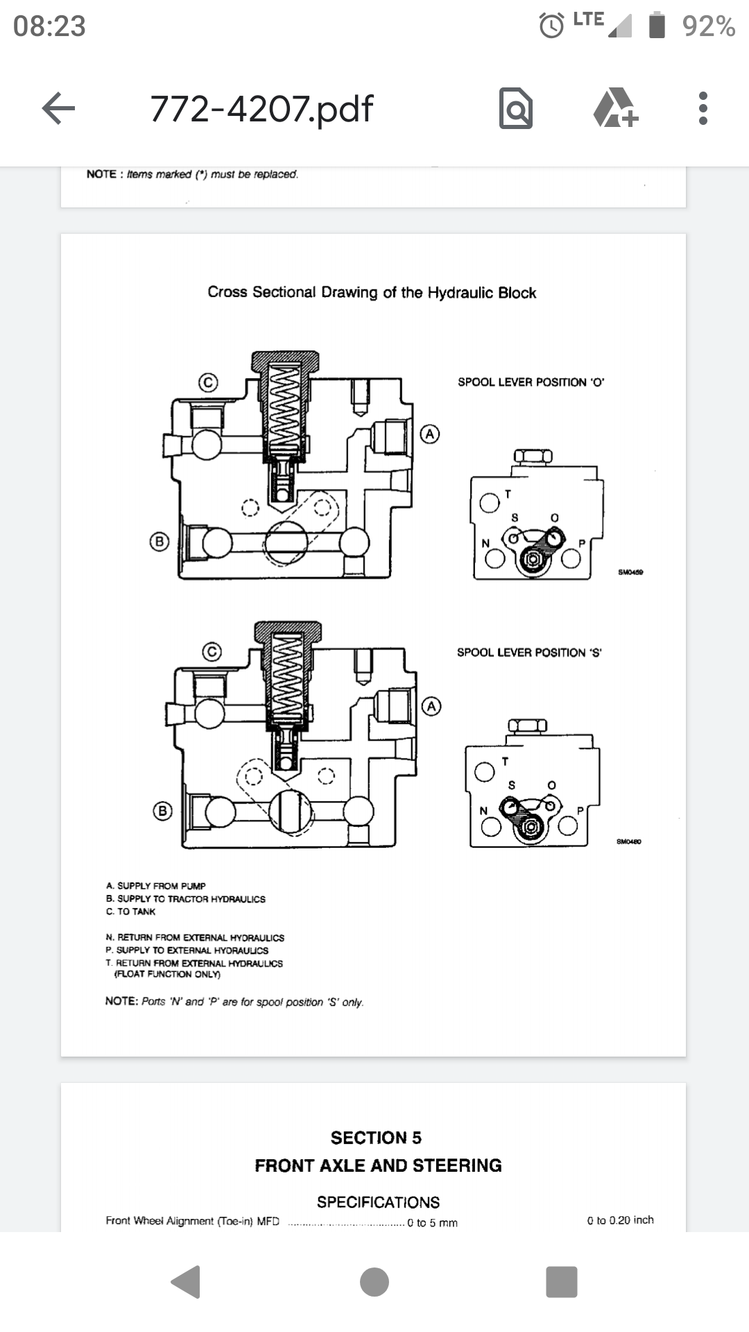

Holycow, the CSR at the Cub cadet/mtd 800 number came thru with the actual PDF manual with things labeled...... Lookie here :

Not to burst your bubble but.. this might disable the FEL when ever you switch to remote hydraulics or might not be an option with the FEL installed. You will need to investigate how the FEL is currently being supplied with oil and then determine the best method for adding additional features.
Some tractors have this feature while others use a series approach where the FEL power beyond supplies oil the rear remotes, the rear remote power beyond supplies oil to the back hoe & or 3 point.
agree that it was very nice of Cub to provide that information though as another potential option.

If I understand it right that valve in post #13 allows you to add more valves to the circuit but in front of whatever "tractor hydraulics" is connected to. I assume that's the loader and 3pt. When it's in position S the flow still goes to them after it's gone through whatever you connect to P and N.
I don't think there is anything wrong with putting your BH and SCV valves in line ahead of the loader since there's a relief in that valve in #13. The loader won't work when you use the BH or SCV valves but that's probably ok. The one problem is that many BH valve stacks can't handle full system pressure on their output port. So if you load down the loader with the BH on you could damage its expensive valves. Turning the #13 valve to O would keep that from happening.
