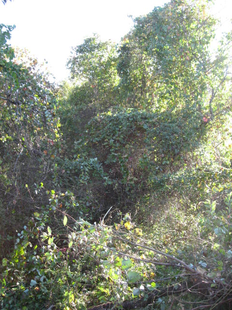

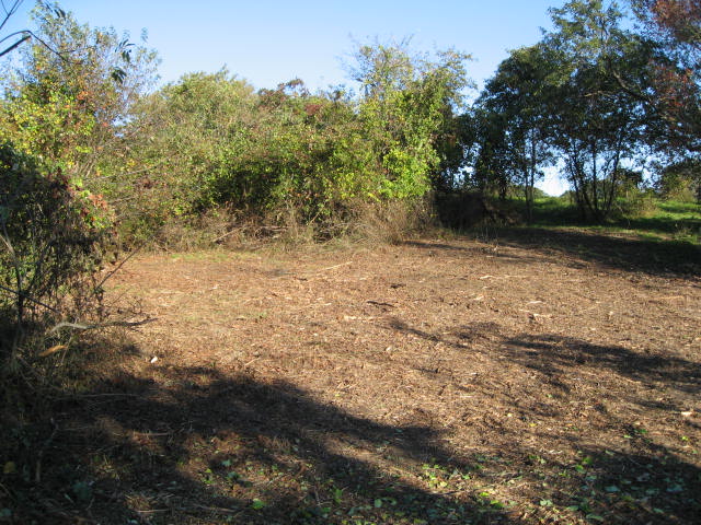

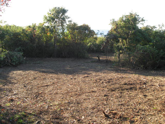

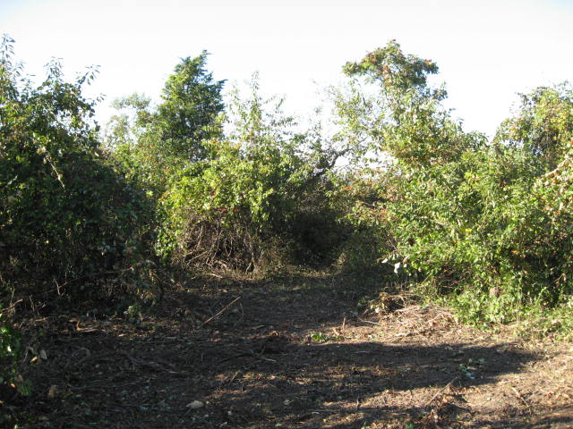

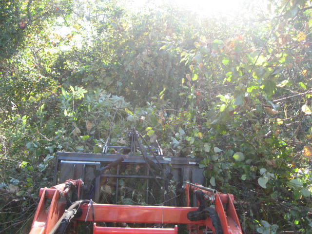

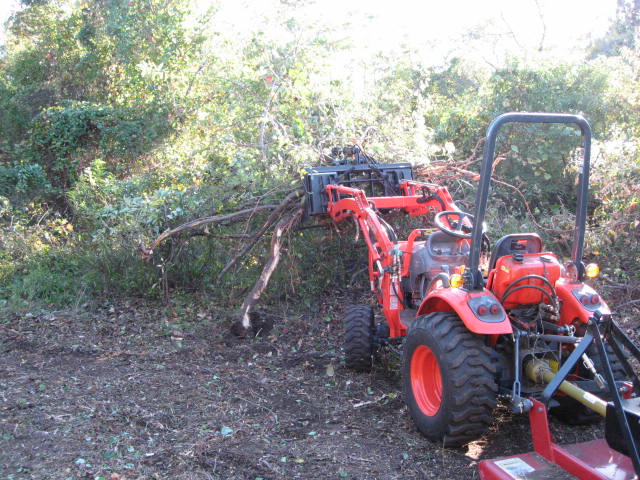

Photos below show the type of land that I can clear at a rate of about 2000 sq ft per hour or 20 hours per acre using just bush hog and grapple. I leave trees bigger than 5" to be cut later by chain saw. Smaller trees are pushed over by FEL then ripped out of the ground by the grapple and carted away. The debris from this area that was not chewed up by the bush hog was carted off with the grapple to a pile about 100 yards away.
