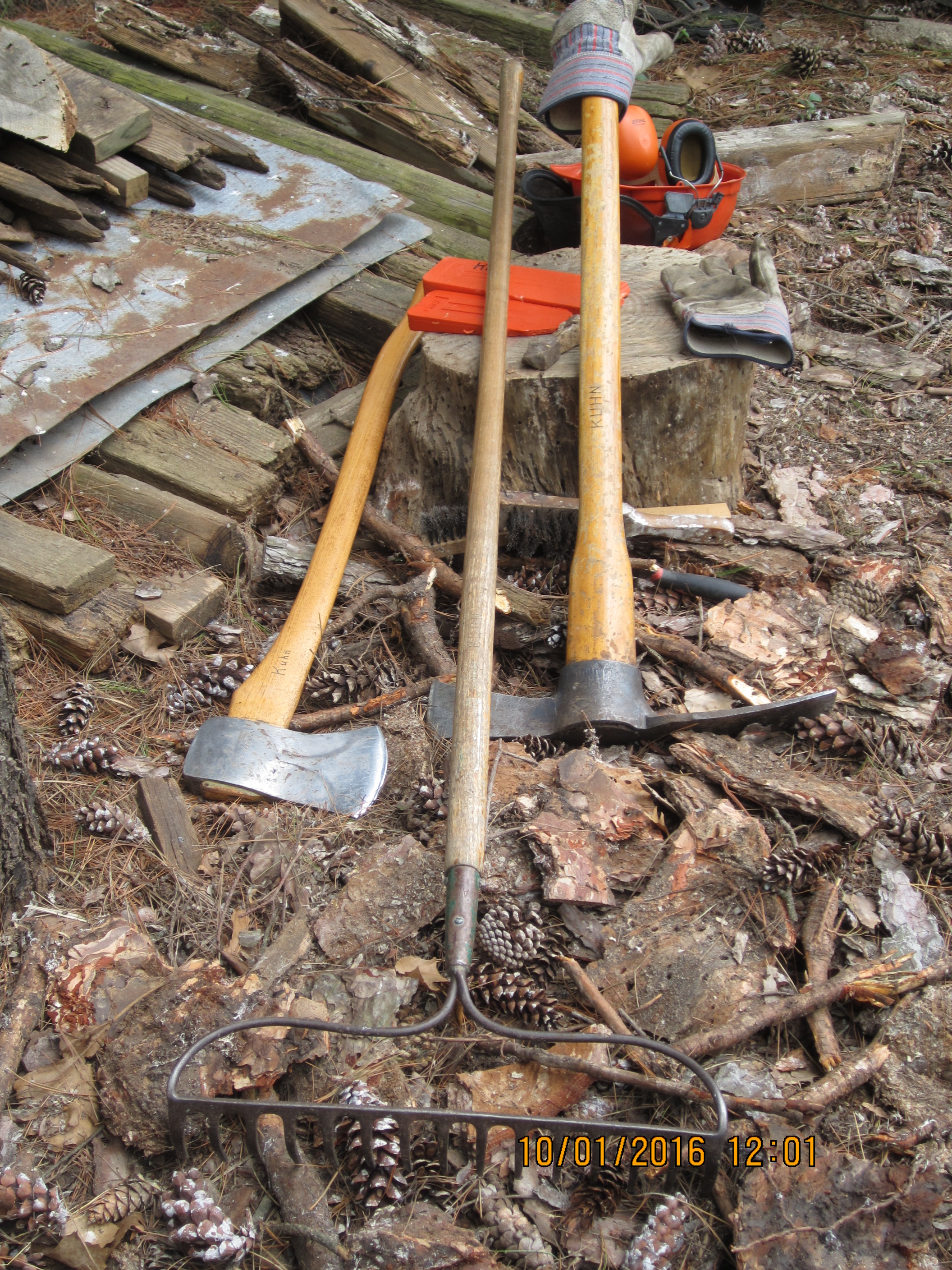

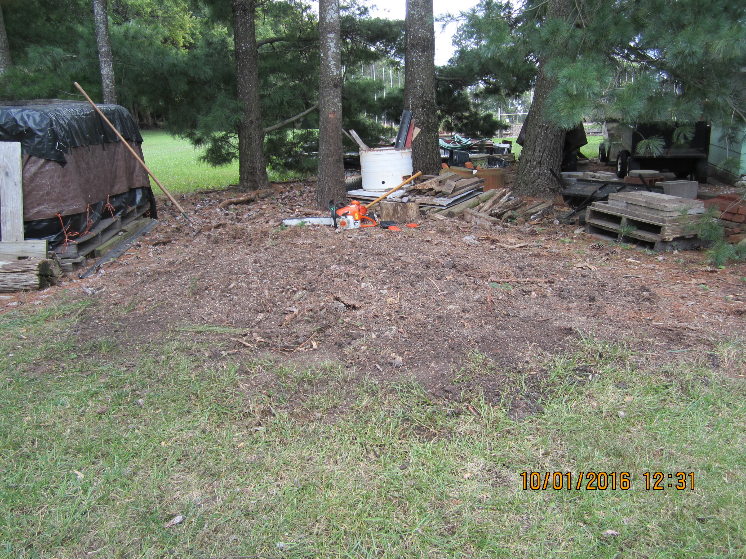

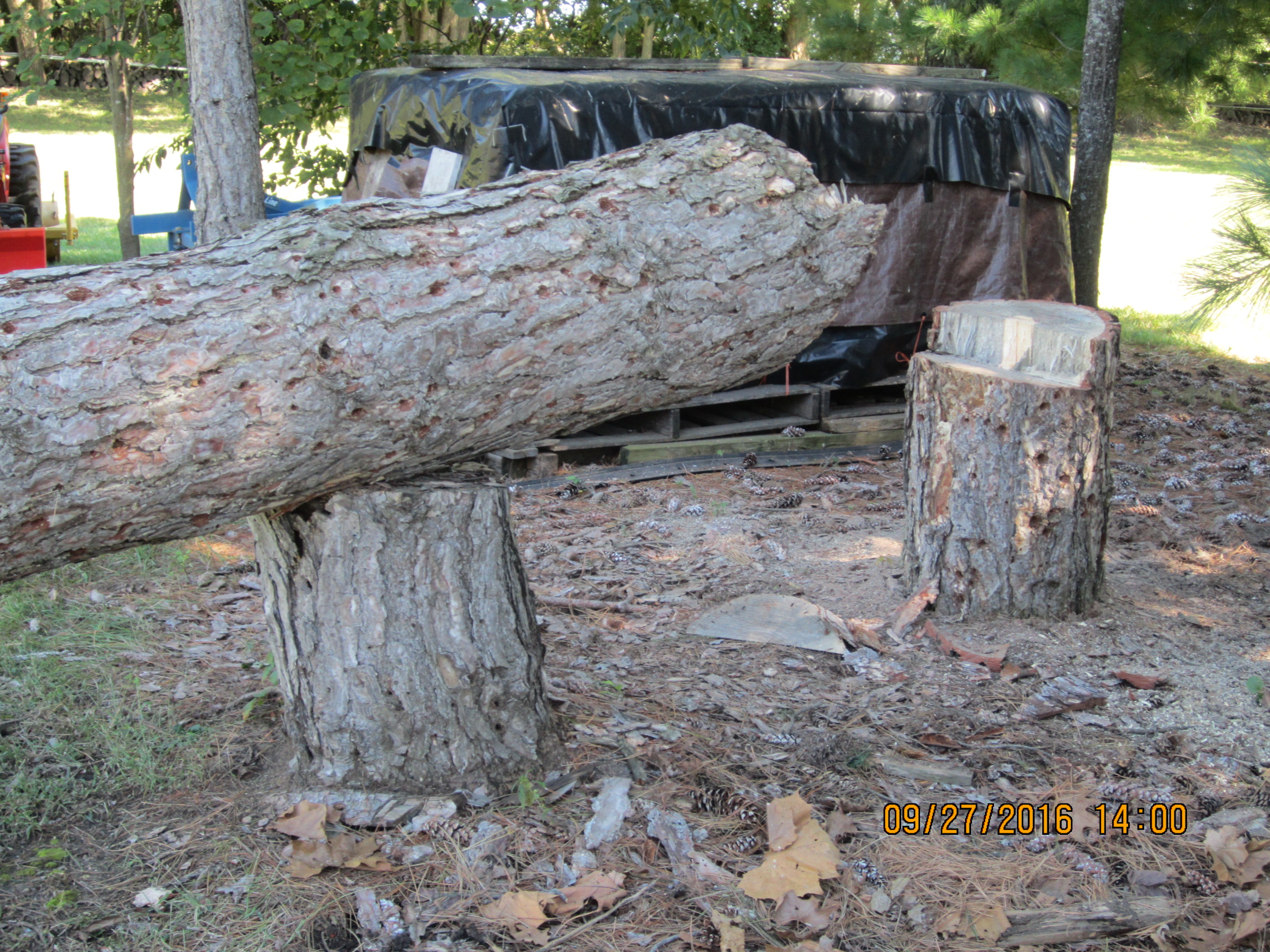

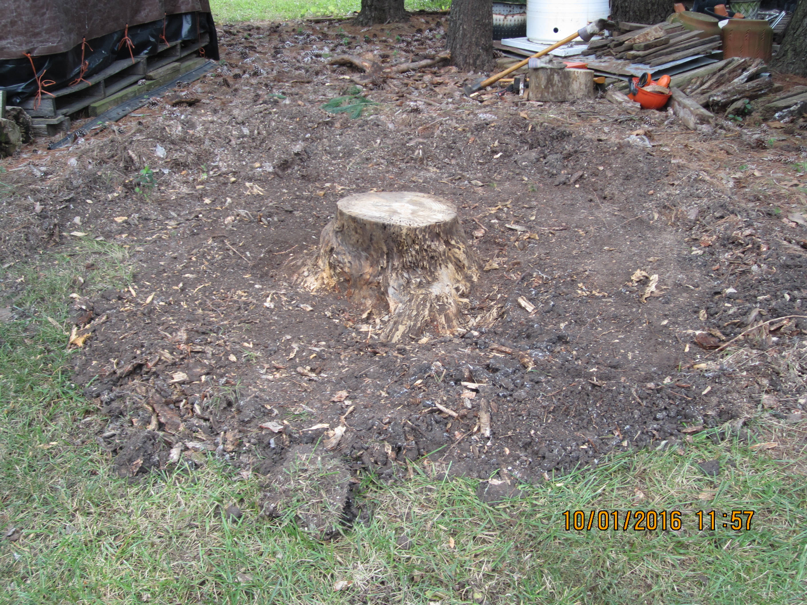

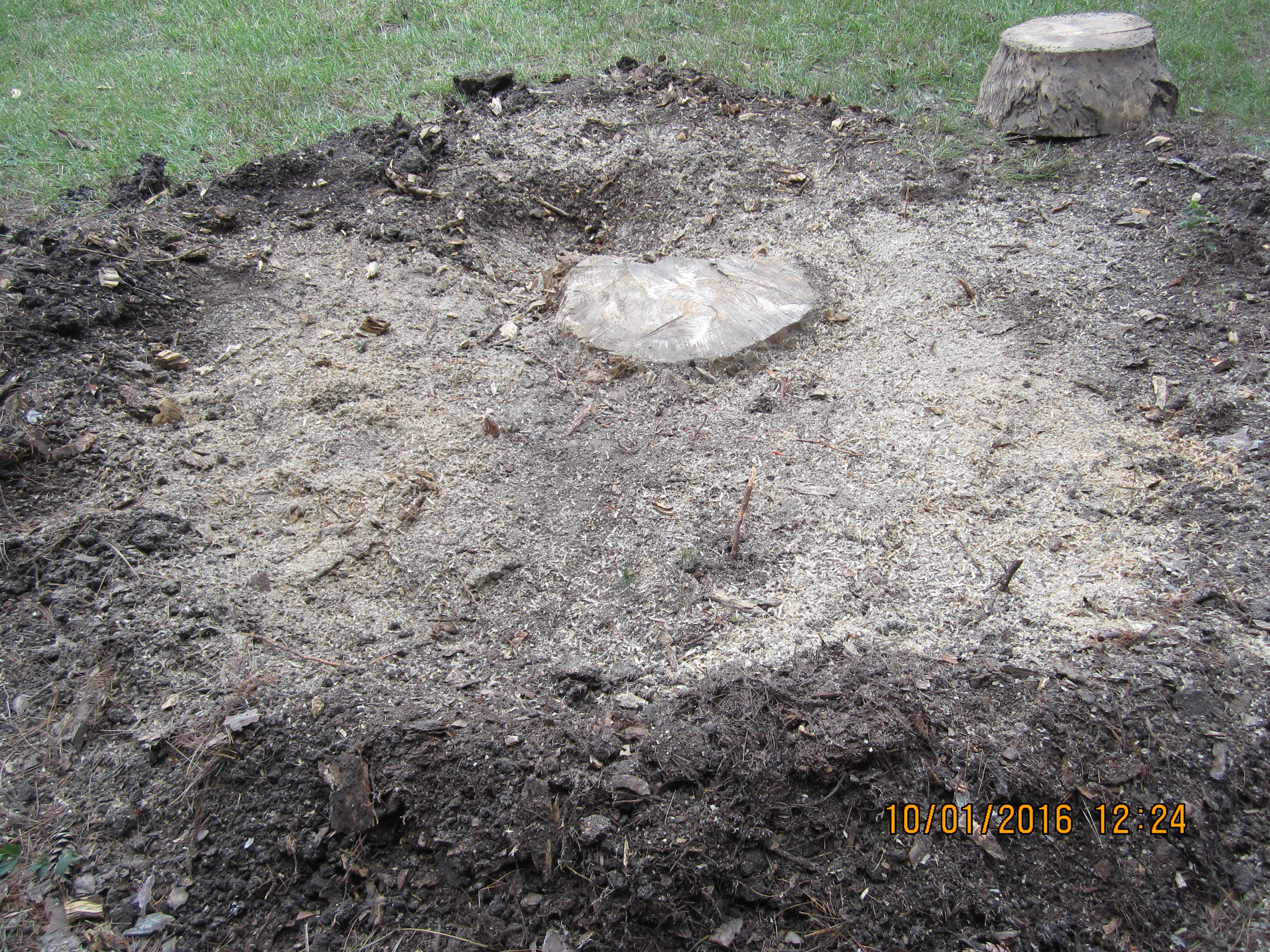

Here's a stump removed using hand tools...just as an FYI. I don't know why an old gezzer would worry about the ball that's covered 8 inches under ground....unless there is a specific reason. I probably spent a day getting it out. Six of them is a different deal however, even with some tractor help.
Cheers,
Mike.
