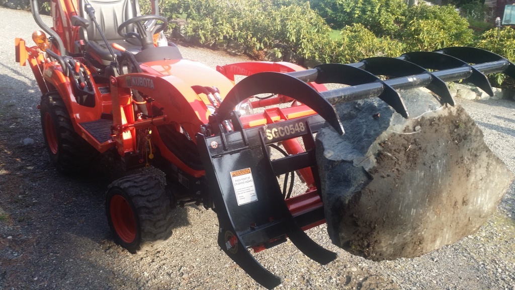

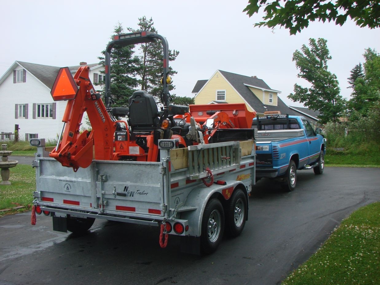

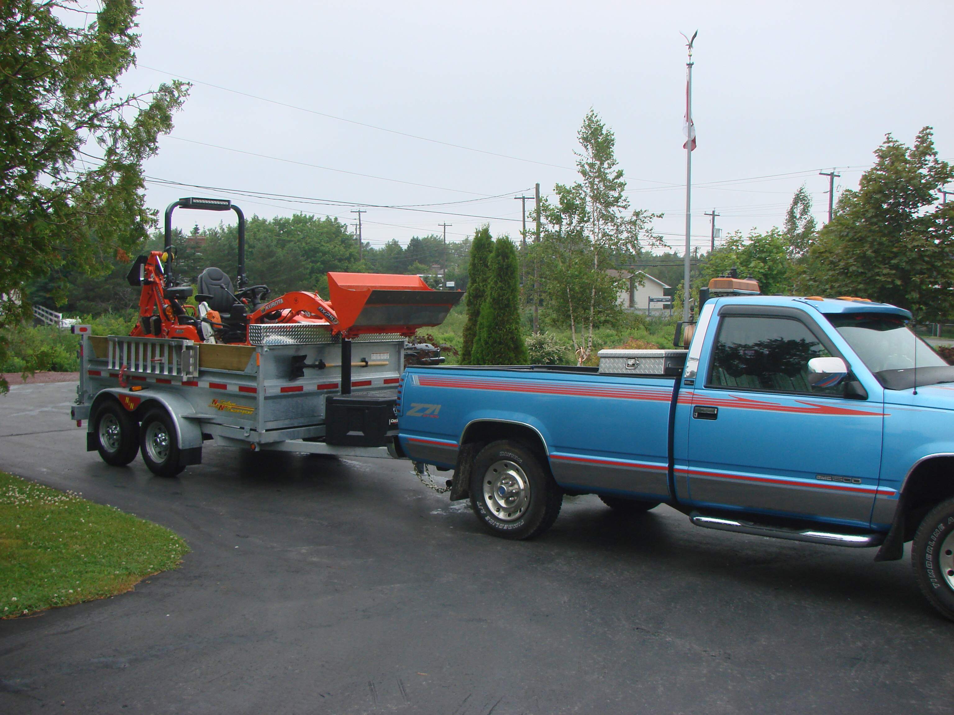

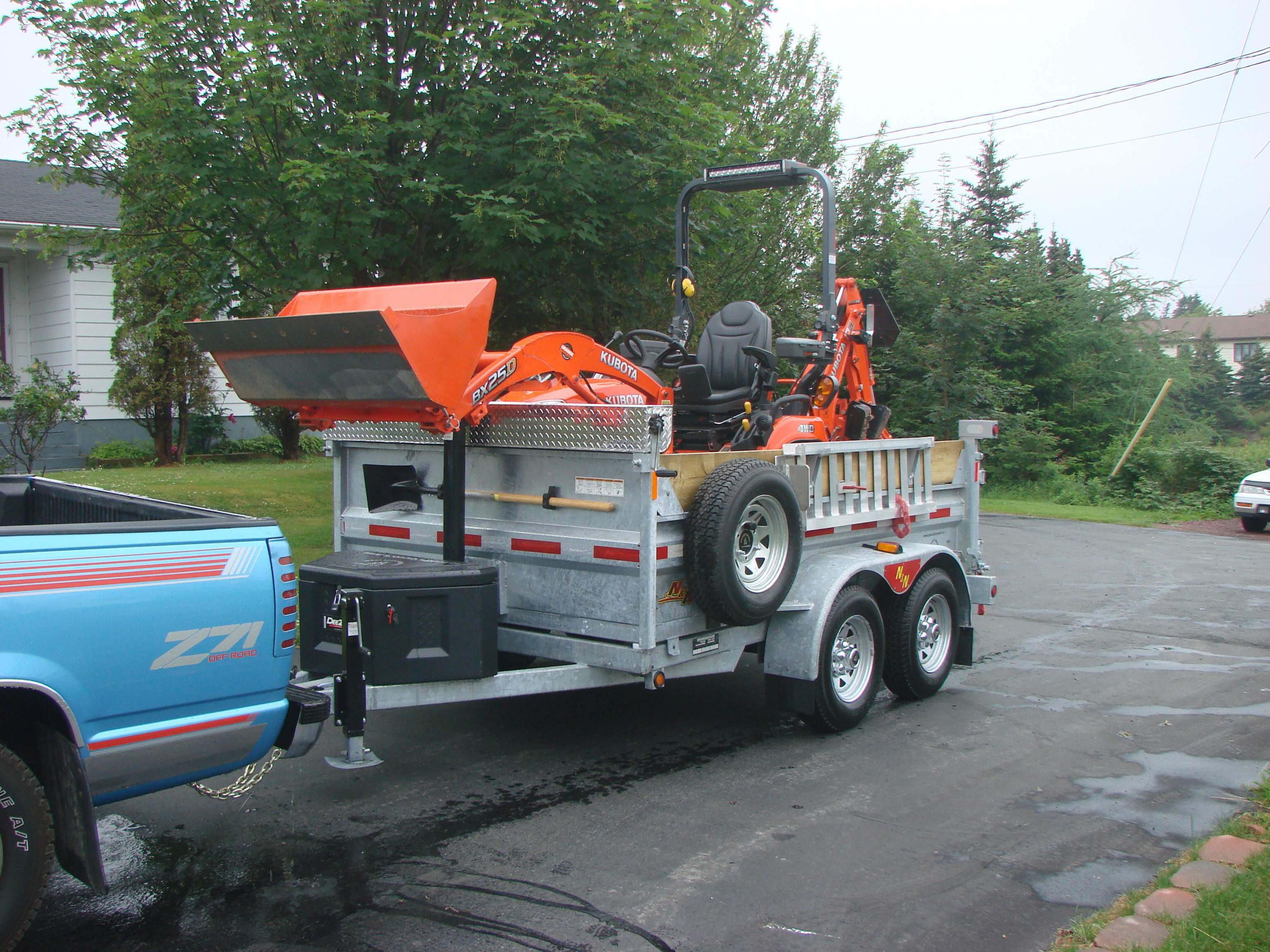

A new F150 with max tow will pull more than 12k lbs. Do yourself a favor and get at least a 14' dump trailer, you won't be sorry. I purchased a new BX25 and Sure Trac 14' dump trailer last fall and they complement each other very well. While the trailer is rated at 14k lbs, that doesn't mean you need to load it that heavy. Ps. Don't forget to get a grapple for the BX, you can quickly load the trailer, haul to the dump, and put a big smile on your face when you push the button on the wireless remote and watch everything shoot out the back of the trailer. You won't be sorry.
   / Who owns BX25 + Dump trailer?
#9
I have the max tow package but it is only rated at 10,200. How wide is your trailer?
I didnt forget the grapple either!!
