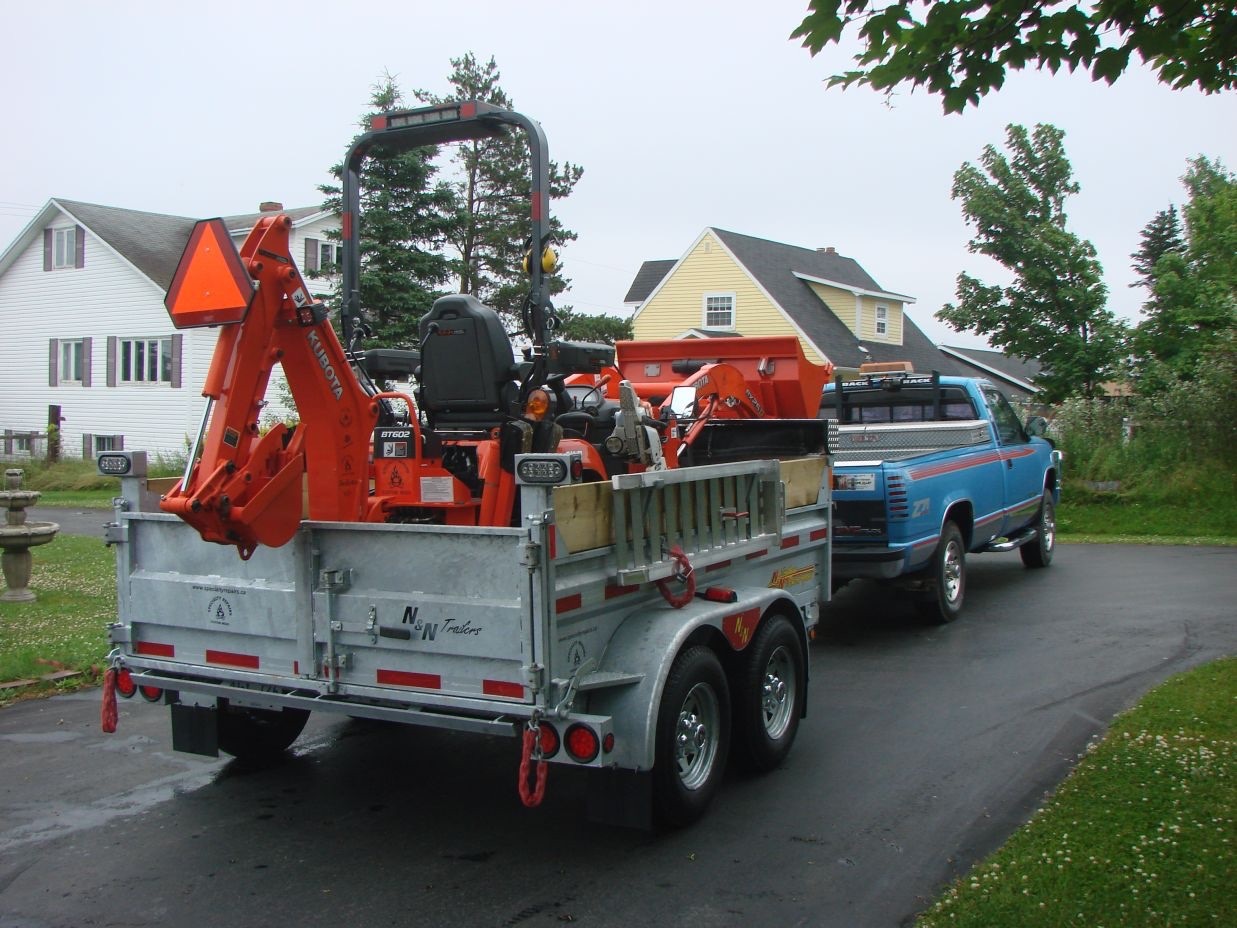

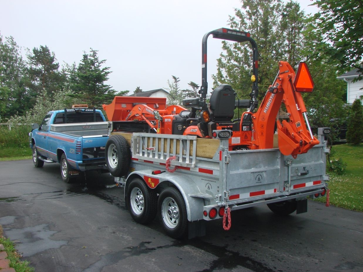

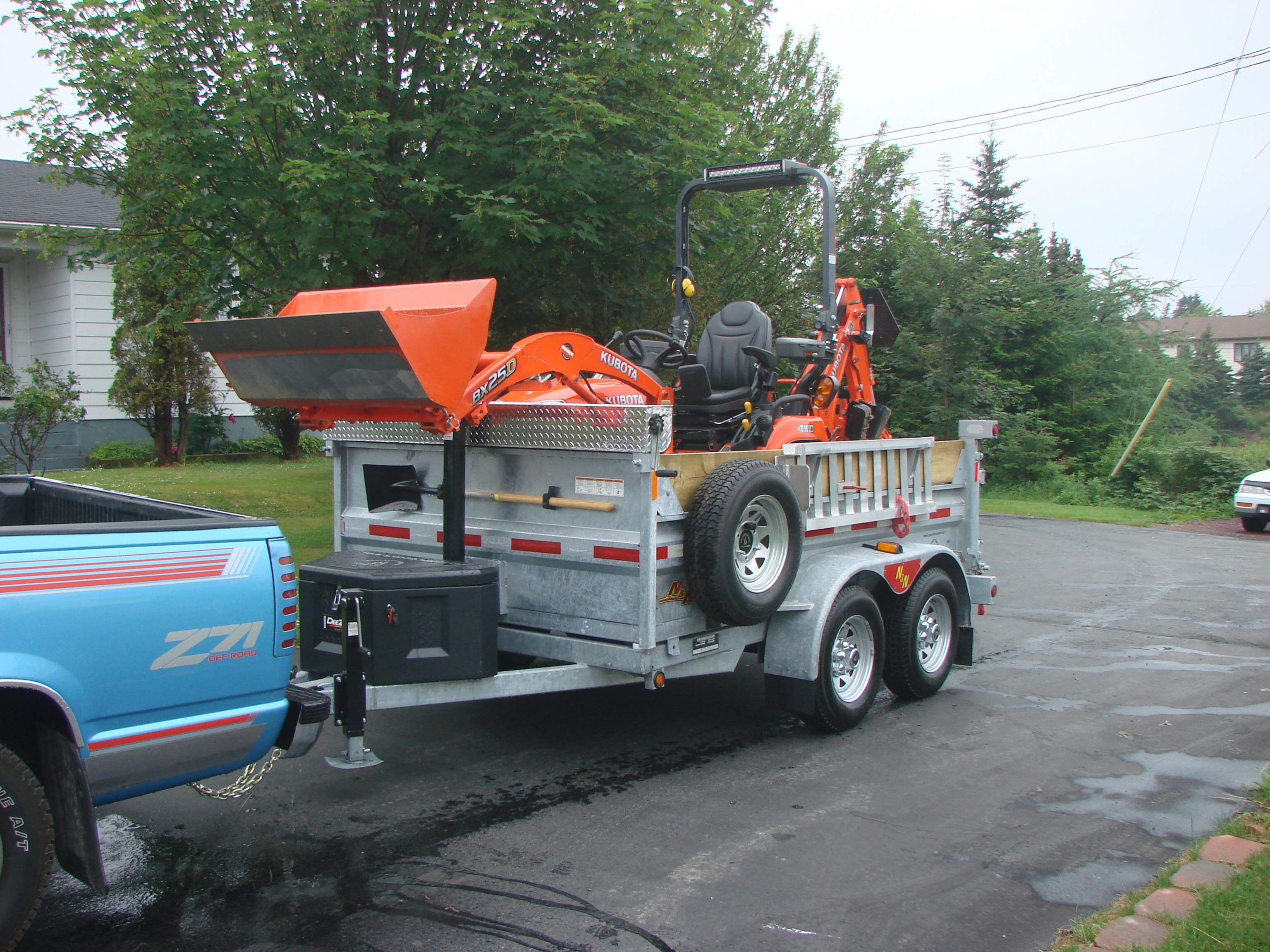

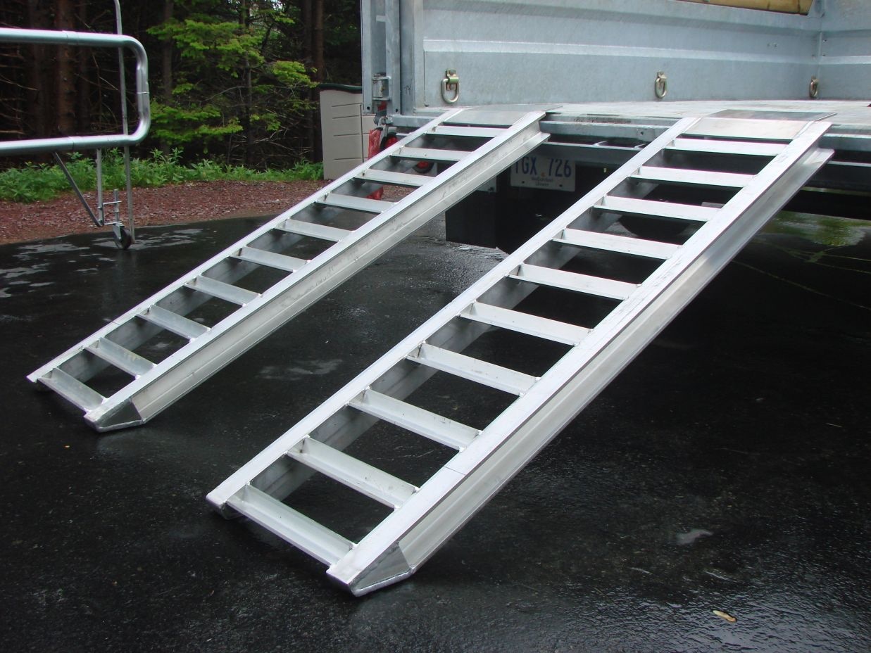

Well I got a N&N galvanized dump trailer. I put the BX in it. Little bit of a tight fit but got no issues towing it with my old 1/2 ton truck. The trailer is 10'X6' with a brake on each wheel. It dumps via one large cylinder centre of the dump up front like the dump trucks have. It's only power up and gravity down so it's easier on the charging system and the battery. It came with a 25' wired remote but I also added a wireless remote so I can change the angle of the dump while loading odd items. It also has a two way tail gate which works great. The trailer was built in Quebec, Canada and has been a great addition to the fleet. I'd never buy a powder coated trailer for around our area. Everyone I've ever seen started to peel off the first year so that's why I went with the gavalinized.
Yes a 14'-16' trailer would be nice but I didn't want to put myself in the hole buying a $50-$80.000 truck to pull it around. I only use the trailer to pull the BX maybe twice a year but it do work great.
