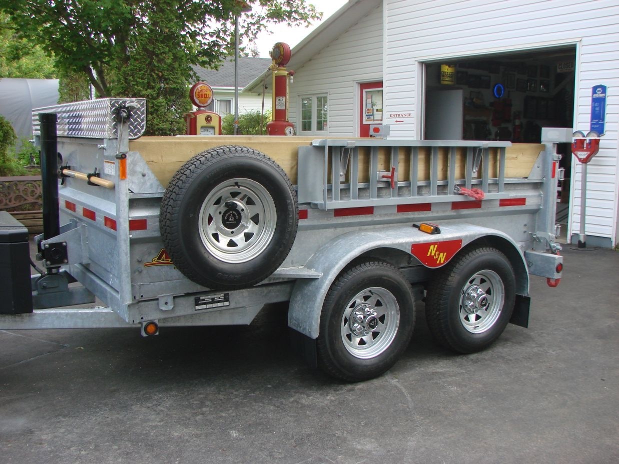

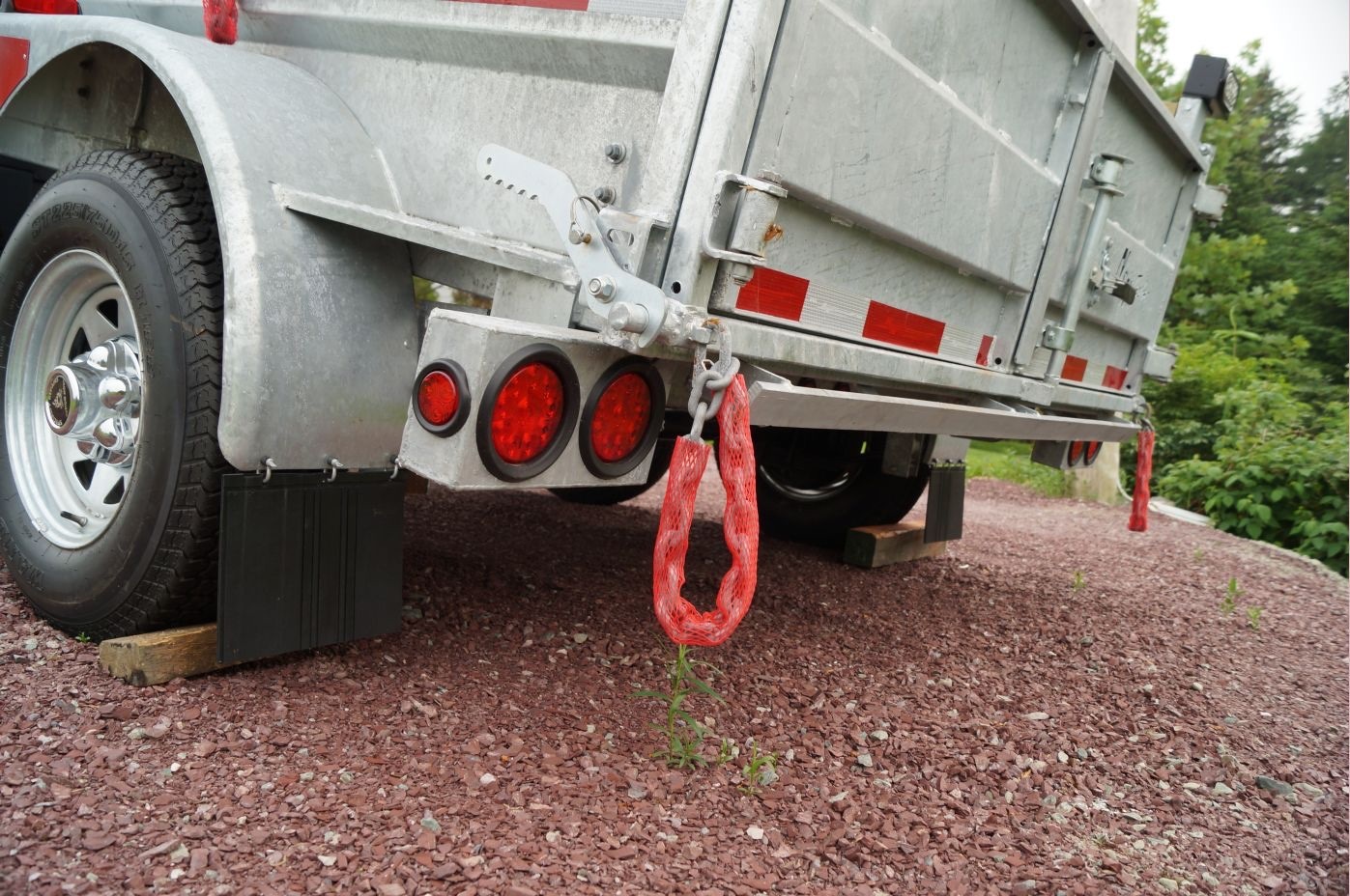

Well I got a N&N galvanized dump trailer. I put the BX in it. Little bit of a tight fit but got no issues towing it with my old 1/2 ton truck. The trailer is 10'X6' with a brake on each wheel. It dumps via one large cylinder centre of the dump up front like the dump trucks have. It's only power up and gravity down so it's easier on the charging system and the battery. It came with a 25' wired remote but I also added a wireless remote so I can change the angle of the dump while loading odd items. It also has a two way tail gate which works great. The trailer was built in Quebec, Canada and has been a great addition to the fleet. I'd never buy a powder coated trailer for around our area. Everyone I've ever seen started to peel off the first year so that's why I went with the gavalinized.
Yes a 14'-16' trailer would be nice but I didn't want to put myself in the hole buying a $50-$80.000 truck to pull it around. I only use the trailer to pull the BX maybe twice a year but it do work great.

There's no denying that the bigger the better BUT it's no good to have a bigger trailer IF you don't have the truck to pull it HD that's why I went with the trailer I have. I don't need a new truck. I hardly use the one I have so investing $50-$80.000 for a new truck in my opinion is ridiculous in my opinion. My set up works for me and I'm content with it. Glad you enjoy our videos. Thanks.

My trailer weighs in at 4900 lbs. It's a heavy duty unit. It's GVWR is rated at 10.000 lbs. mine cost around $8000. I made my own aluminum ramps, installed the wooden extensions! Shovel and rubber mounts. Added a spear tire, chrome centre caps for the wheels, wireless remote, mud flaps and fabricated an aluminum tarp cover. I also added D rings inside the dump so I did have some mods to do even at that price point. I haven't seen an aluminum dump trailer. Here's their site HD dump trailers Archives - N & N Trailers N & N Trailers
