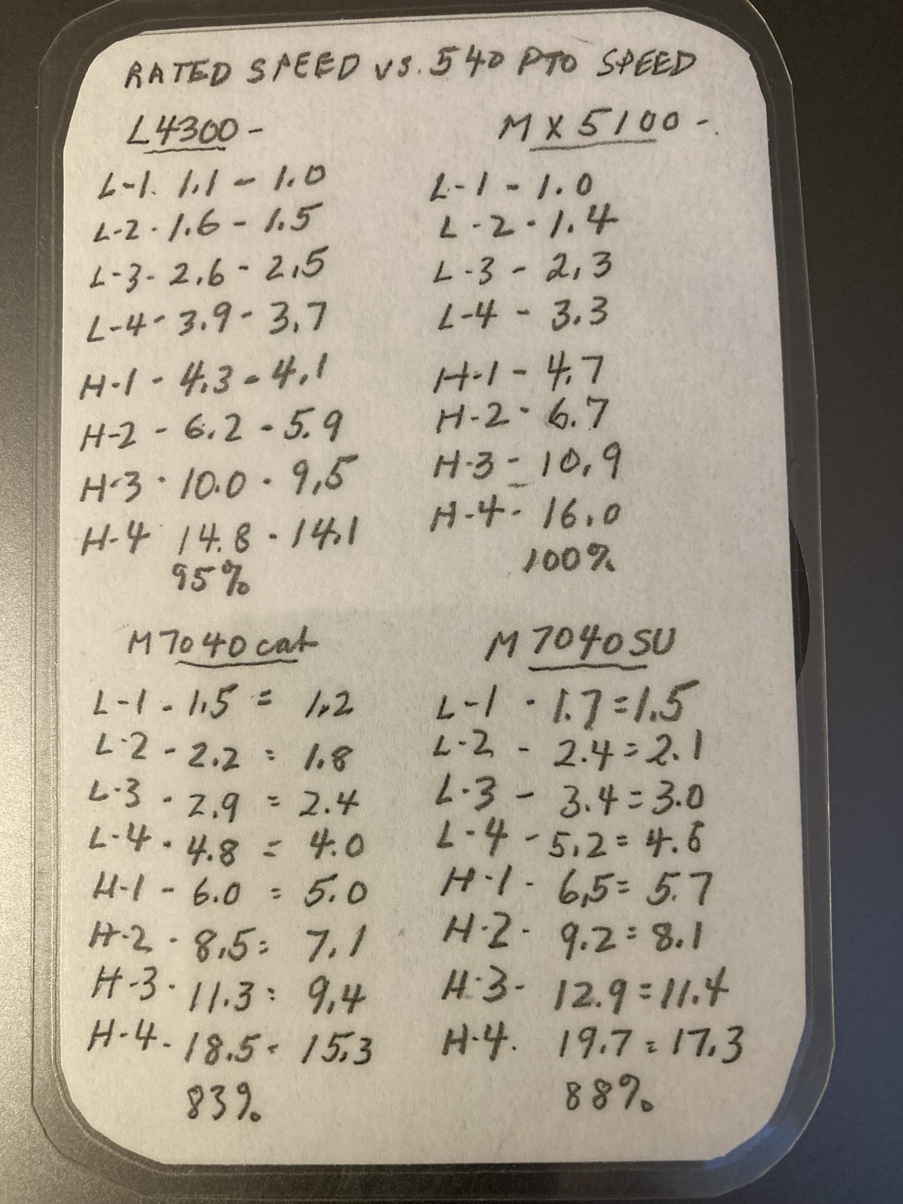

For field work such as spraying and fertilizer,I made some pocket-sized cards, laminated them and keep one in my pocket when needed.
Most tractors are woefully inadequate plus list only a 540 PTO arrow and then rated speed RPM. Those are two different MPH speeds so my card separates the two. These are gear tractors.
Here's the card
On the L4300 for example, the PTO speed is 95% of the engine rated speed so I did the math and now know how fast I am going in any given gear at 540 PTO. Next month I'll spread fertilizer and get what I want and where I want and than would not be possible without knowing my correct speed.
I can't remember how I did the math but it should be easy to figure out. Plus I have posted it on the TBN a year to two back.
Wait, here's the thread and it starts with my question and discovery and a resolution. FYI

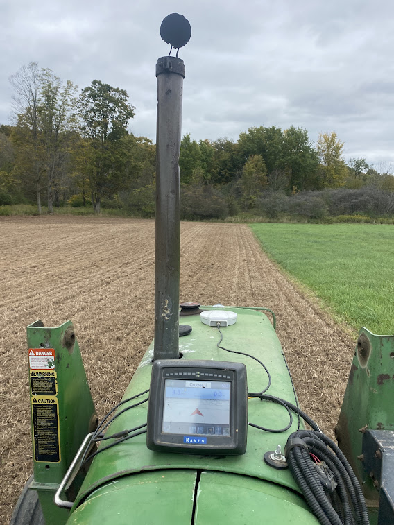

All my Kubota tractors had such a range chart in the manuals. They are of little use to me due to the varying slopes on my acreage. All the newer Kubota's have speedometers, which I use instead.
For precise chemical application, I use GPS with RTK augmentation.
