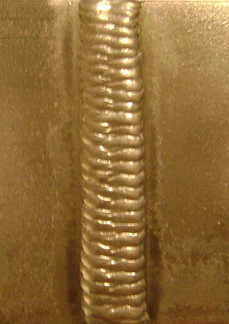

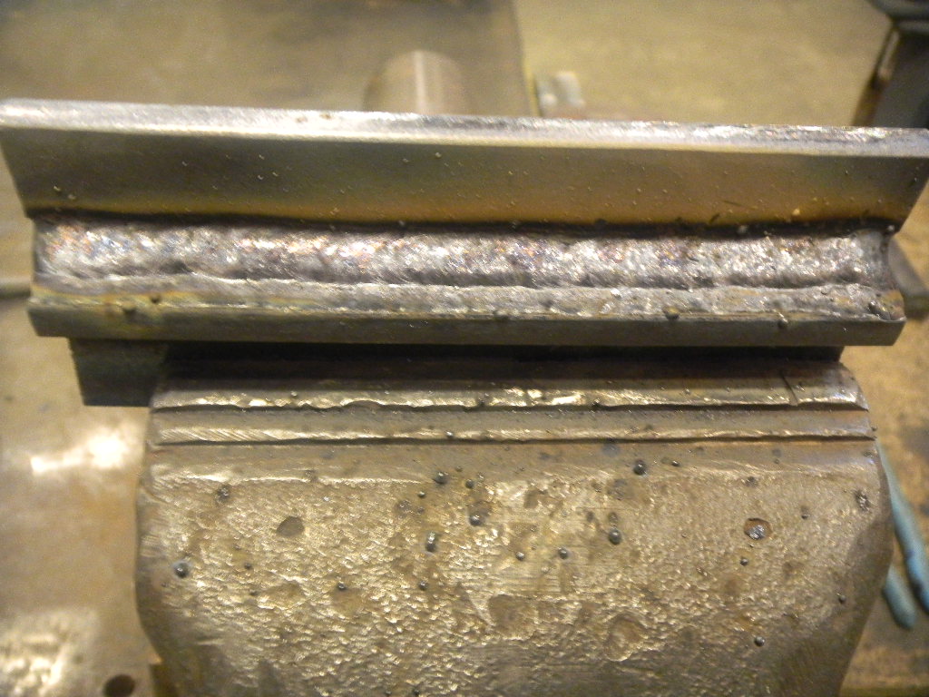

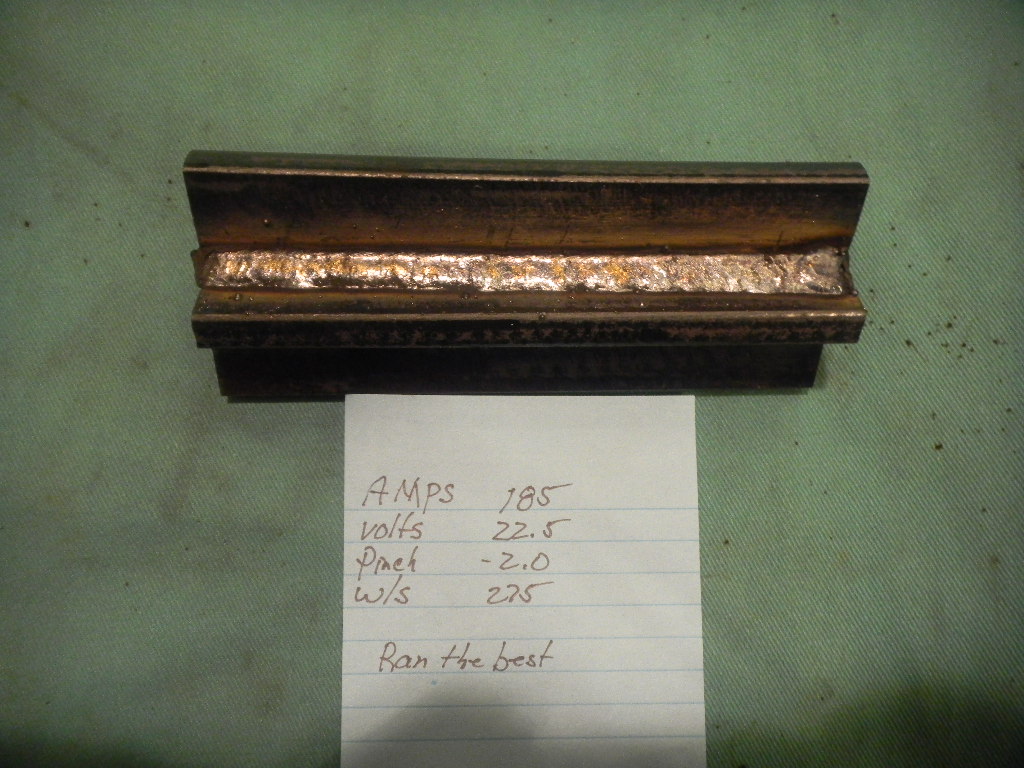

Here are some dual shield welds I made a few years ago.
First pictures shows the slag coverage.
Third picture is a vertical up hill weld.

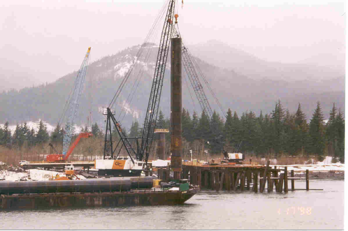

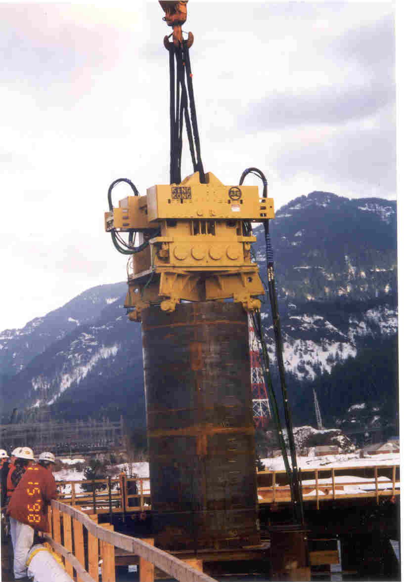

I didn't do any of the welding, I was the project superintendent. This was for an outfall just down river of the Bonneville dam, on the Columbia river. We drove 10-feet diameter pipe, drilled them out, and welded another section to the driven section, and drove it. The outboard piles went over 200-feet into the rock. All welded with dual shield, 100% x-ray.

Would love to be able to have a close up look at that kind of operation. how long does it take to drive a pile that deep, and how far does it go with each blow of the pile driver.
   / Why does flux core wire weld thicker metal than MIG? #11
These were very slow going piles. We used a hydraulic vibrating hammer to drive them. No impact hammer at all. In the second picture I posted above the crane to the left of the derrick, the red one with a blue boom. Was gearing up to drill out the inside of the pipe. Here are the augers we used. The large hole saw looking auger really got a workout drilling through the rock. It was amazing how many carbide teeth we went through!:shocked: The Kelly bar was powered with a 750-HP diesel engine.
