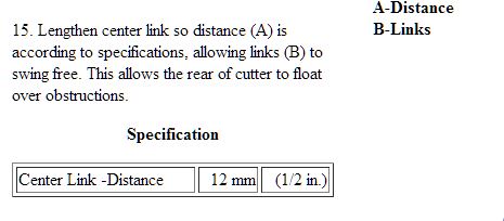

I always take all the slack out of the linkage on the MX5 on level ground, set the stop so the front is 0.5-1 inch lower, then back the top link a couple turns so the cutter can rise & fall with terrain unevenness. I see the same problems with this cutter regardless, but it doesn't have the blade tip speed the way the MX6 does. A friend that does a lot of cutting went to another brand & found it just worked better. I think the two layer top (intended to keep the top intact longer) eats into the space enough to restrict the uplift the foil on the blade is supposed to create. It may be worth checking underneath to see if you have the corner packed; that'd further restrict the uplifting, but it seems to be a common complaint with the 5 & 6 anyway.
   / Why doesn't my MX6 suck? #32
This was snipped from the operators manual you posted.

   / Why doesn't my MX6 suck? #36
I think we are both right.
http://manuals.deere.com/omview/OMW49246_19/
Manual says to take all the slack out of the linkage but use the rear wheel to support the rear of the mower. I might need to adjust my rear wheel some.
D.
I mow on uneven ground. Even with respectable slack in the top link I still ocassionally pick up the tail wheels of my cutter.

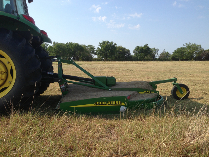

   / Why doesn't my MX6 suck? #38
Here is how I run my mx6. Cleaning up stump infested pastures.
D.

Here is how I run my mx6. Cleaning up stump infested pastures. D.
That's a nice cut! But you sure have yours set wayyyy lower than mine, wow!
   / Why doesn't my MX6 suck? #40
I am clearing stumps with my compact loader. Then grinding up the remains from the mulching with the mx6.
D.
