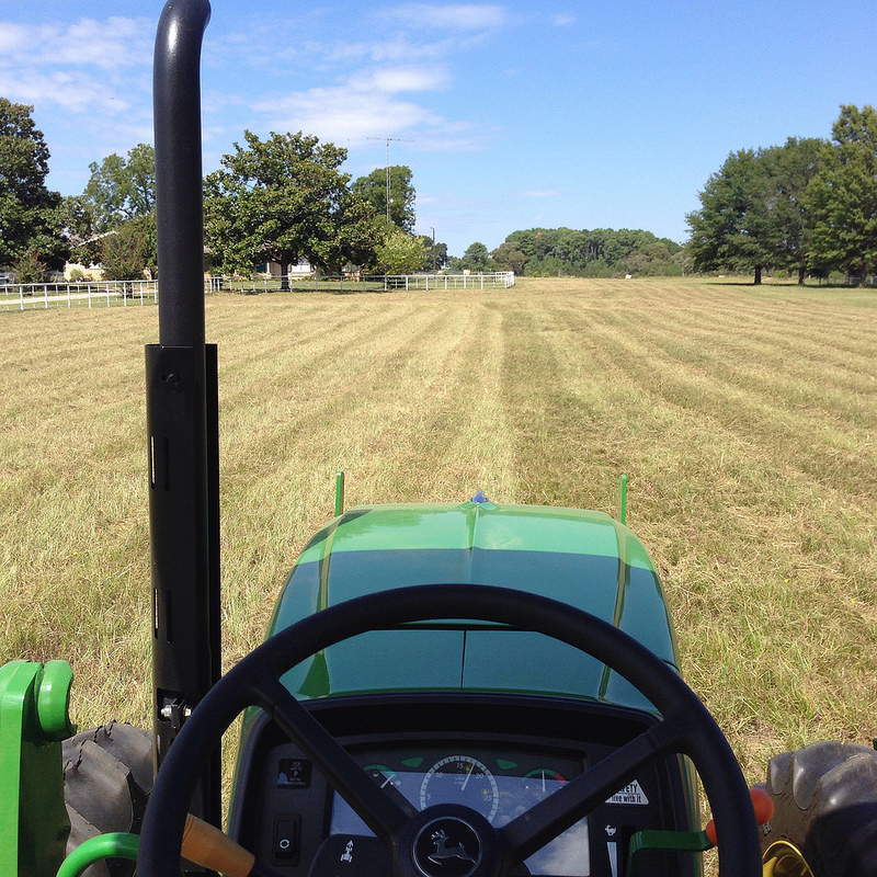

Resurrecting this thread I started...
So I got to use my MX6 with my new 5075E for the first time today. Did about 2-3 acres for a friend that was pretty thick / tall.
I was astonished at how well it cut! To the best of my guestimating, the mower was set exactly the same as it was on my 5103. (I didn't adjust the tail wheel at all). However, the cut was impeccable!
On my 5103, I never mowed faster than 3-3.5mph (B2). However, I was able to buzz through around 5mph on my 5075 today in 540E PTO. I couldn't believe how well the MX6 was cutting.
Here are my musings on why it cut so much better...
- The tractor is heavier, so the mower stayed where I wanted it better. (I doubt this one)
- The MFWD front tires and wider, 16.9x28 rear tires do not squash the grass down as much, meaning the MX6 can pick it up and shred it easier.
My old 5103 had the 2wd tires that really ran the grass over harshly. The R1 bias tires on the front of my 5075E could be a little easier on the grass with that kind of tread pattern?
I really have no idea. But here's a pic so you can see how purdy it looked. :D

I had a similar experience 4520 vs 5525. I wonder if it a torque or rotating mass thing.
